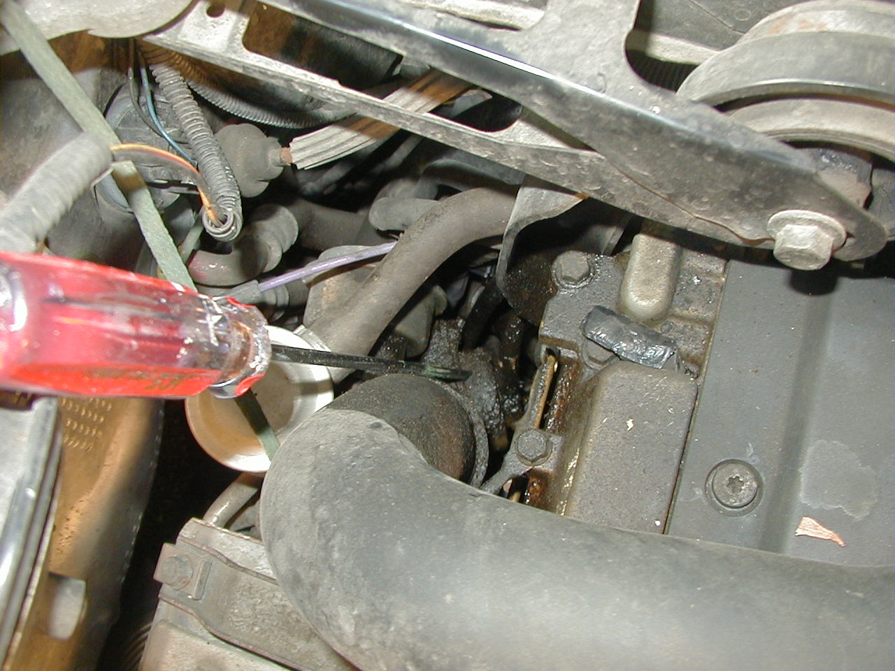

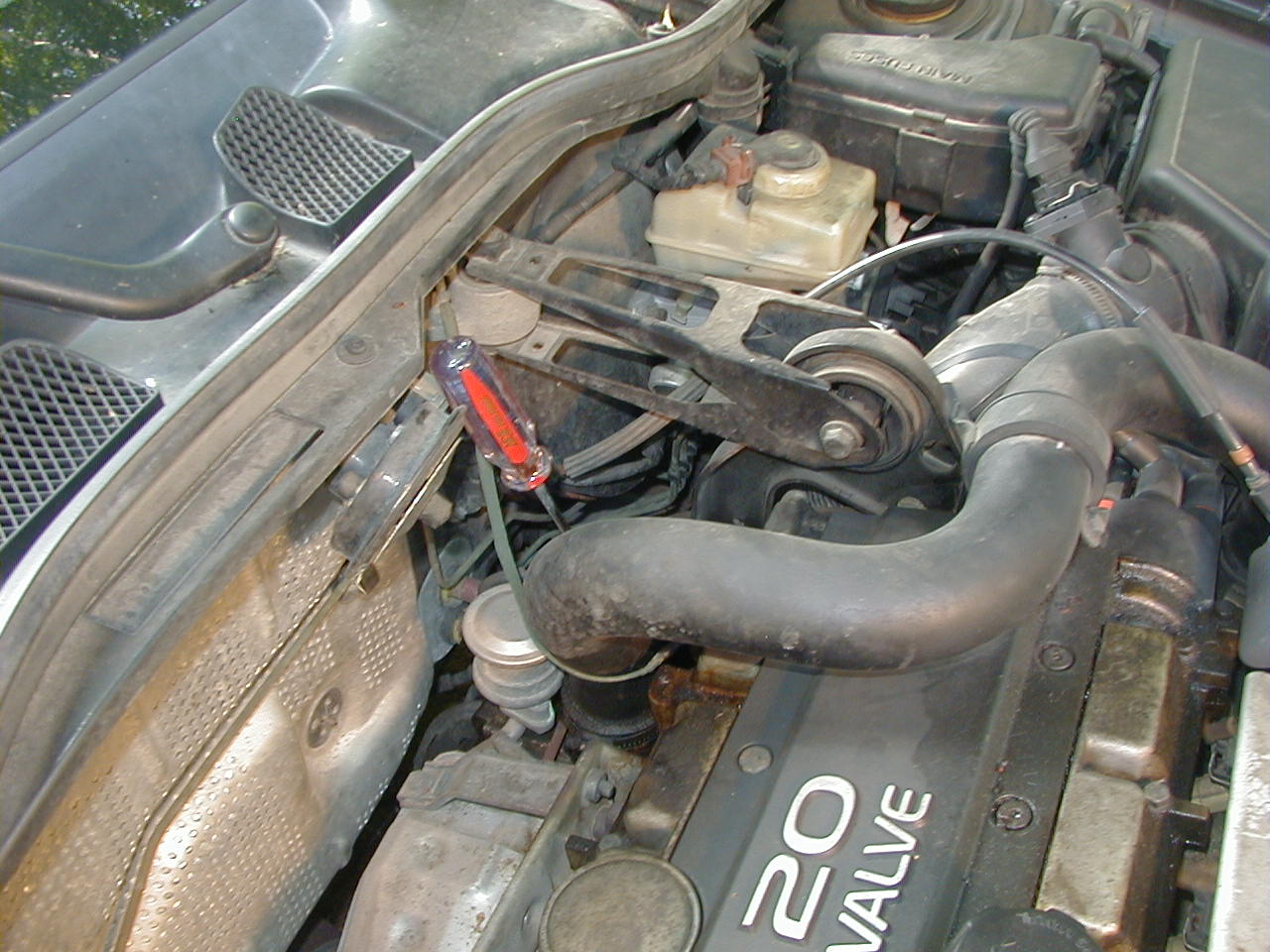

I can see a coolant drip in this specific area on my car -- doesn't take long for the coolant to get low. 2 photos attached, one is the general area (screwdriver) and another close up.
What am I dealing with here? Most likely? Difficult repair? -- thank you much

Its a fiddly repair but most can get through it. The turbo coolant hoses and a heater hose are in that general area. Start by cleaning all the old oil and gunk out of that area with an engine cleaner or your preferred purple cleaner and a small brush to agitate the gunk.
Once its clean you will be able to see where the leak is coming from. There is a slim chance that the turbo coolant housing ( center section/CHRA) cracked but that is rare and very difficult to see until clean . Replacing the CHRA is also something that can be accomplished but it is harder .
Know that Volvo's hate overheating, so If you have large doubts on your ability to change a hose , after cleaning the area up, then you may wish to seek an automotive technician. Otherwise, find the leak, use high quality hose and good clamps, then refill with proper antifreeze.

I had the heater core replaced several months ago at the dealer. Would he have worked in that area at all or just inside the cabin? Thanks -- I'll clean it off -- I can see the drip just need to visualize it better.
By the way, a P0116 code came on but did not see the temp gauge exceed the midway point. BUT -- I lost a lot of coolant and was still driving yesterday. Hopefully, I'm ok.

It depends on the tech. I get the OE coupler for such a low price I put one in with every core that has over 100K miles on it ( that has me working under the hood as well as inside the car. If just the heater core was swapped (normal) then they would have been inside only.
If its going to be a while until you can fix this you may wan't to buy some ( I think it was 5/8 generic heater hose) and tie the two heater core parts together. It will punish you financially if you over heat the motor. Keep in mind the gauge is near the top of the cooling system. If the coolant level drops below the sensor ( doesn't take much - you will get a false reading as the sensor is not in contact with the coolant consistently.
I am not a fan of any of the bypass or mods that remove the coupler. The coupler is affordable and I want to avoid any chance of my customers getting carbon monoxide getting into the cabin after the sealant dries or pulls away from the firewall in the bypass situation. The heater hose prices are ridiculous so if on a tight budget we dremel off the swage crimp and re attach with a Gates Powergrip SB clamp and quality heater hose.

Ok you guys the leak from above in the photos must have been some built up condensation that was just dripping. When I cleaned it up, it stopped.
