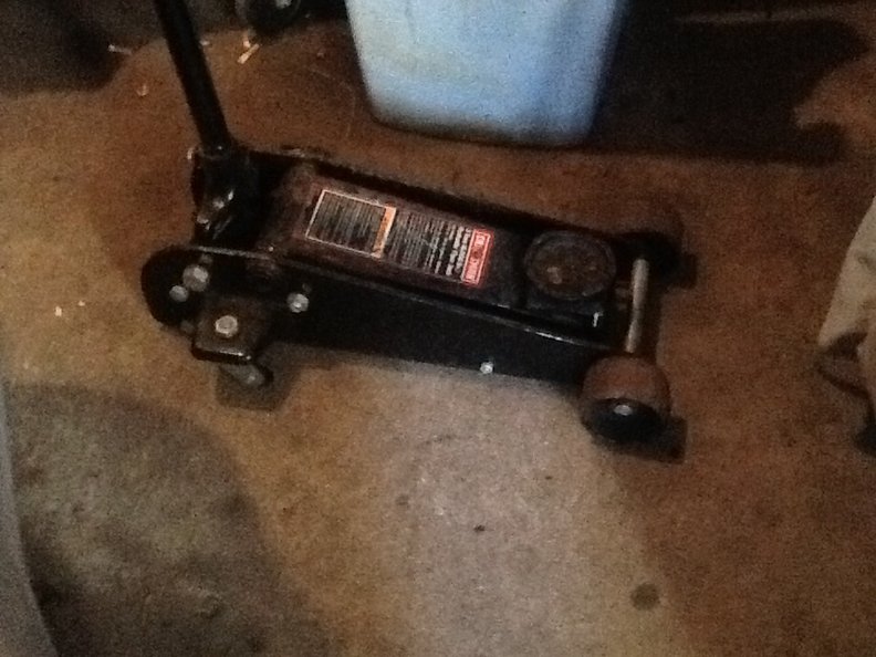

I have one very much like the one pictured. Two things about it. It takes a couple of jackings to get enough height to crawl under the car and it seems to be a little unstable because of the width of the jack. I have been thinking about what to get next. A regular floor jack is a perfect choice, but lays around more than it is used. If you get it just keep in mine that it can have it's problems. If you need to jack higher than the first lift, I have used blocks of 2x6 under to jack, not on top, and that helps to stabilize it on higher jacking. Always use jack stands, as to never trust a jack for a long time. Tires under the frame, is also a safety for under car working.
