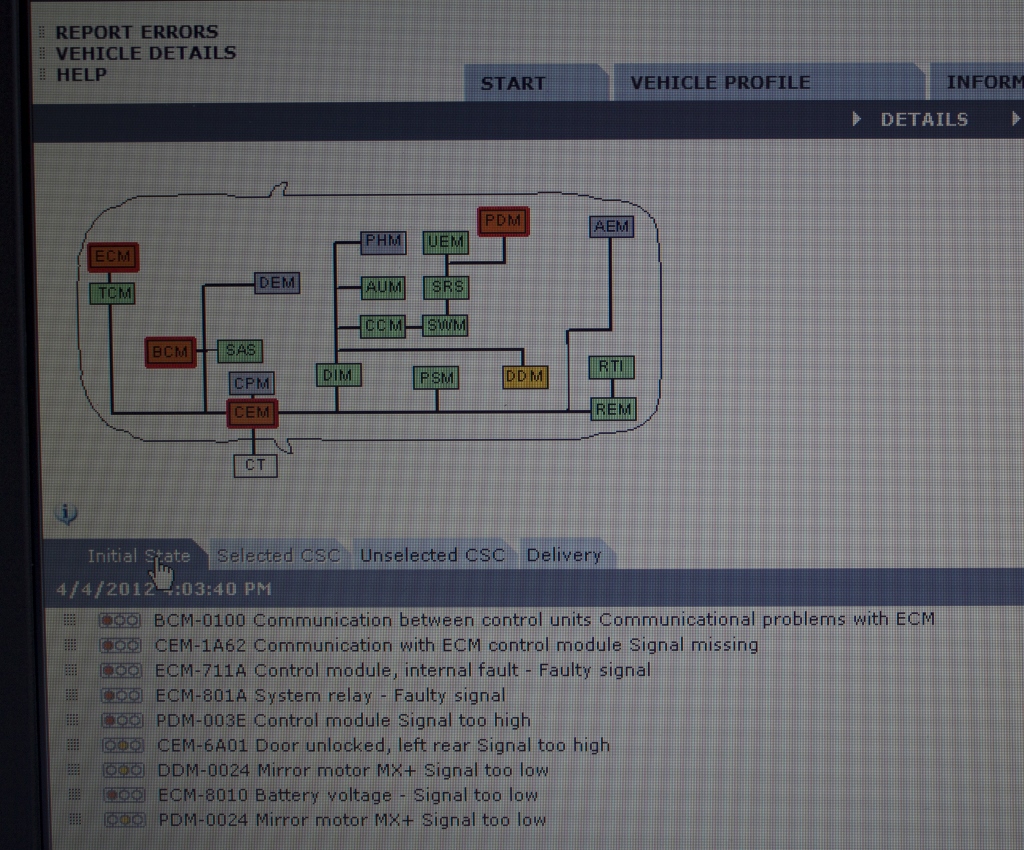

I have a 2002 Volvo S80 T6 which was parked for a few months during summer. It ran perfect when parked. Now when I start the car again I have problems. It will start but run at an idle without responding at all to throttle. It’s not taking any input at all, so after a few minutes of running perfect it starts sputtering. Apparently the auto-choke changes and now the engine idles very poorly.
I ran Vida Dice and got the following error codes (see attachment of picture from Vida Dice):
CEM-1A62 Communication with ECM control module Signal missing
ECM-801A System relay – faulty signal
I removed the ECM and checked the contacts, and tried to clean them. No difference. The car will start but is not drivable at an idle. Can I have the ECM checked without the car? Any suggestions would be great. I was thinking some rat or other critter chewed on a cable somewhere (the car was parked outside) but there are really not many cables exposed from below.

I appreciate the feedback and have posted the initial state values below:
Initial State When I ran Vida Dice again
Intital State (1024x850).jpg (535.8 KiB) Viewed 2669 times

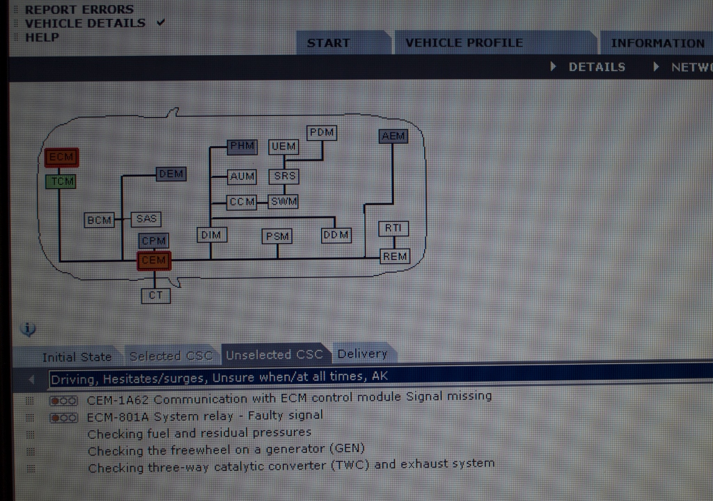

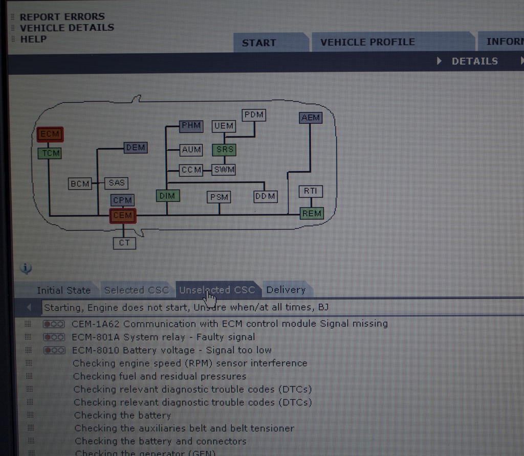

I also have posted the Unselected CSC 2 values for this second run (and they are actually not identical).
Unselected CSC 2 when I ran Vida Dice again
Unselected CSC 2 (1024x892).jpg (557.08 KiB) Viewed 2669 times

Please post all errors from "Initial State" tab.

You need to check power supply voltage that goes to A17 pin of ECM module (Power goes via fuse #6 under the hood).
If power is ok you may have bad ECM (ECM-711A Control module internal fault).
Also check FMA2 relay. Also under the hood.

without ECM connected you won't get power to the #A17 pin.
because this (FMA2) relay is engaged by ECM itself. ECM controls this relay by #B38 pin.
So you may test if there is good connection between #B38 and #4 pin on relay.
BTW 10.2 is small voltage. So that means your battery can be bad.
