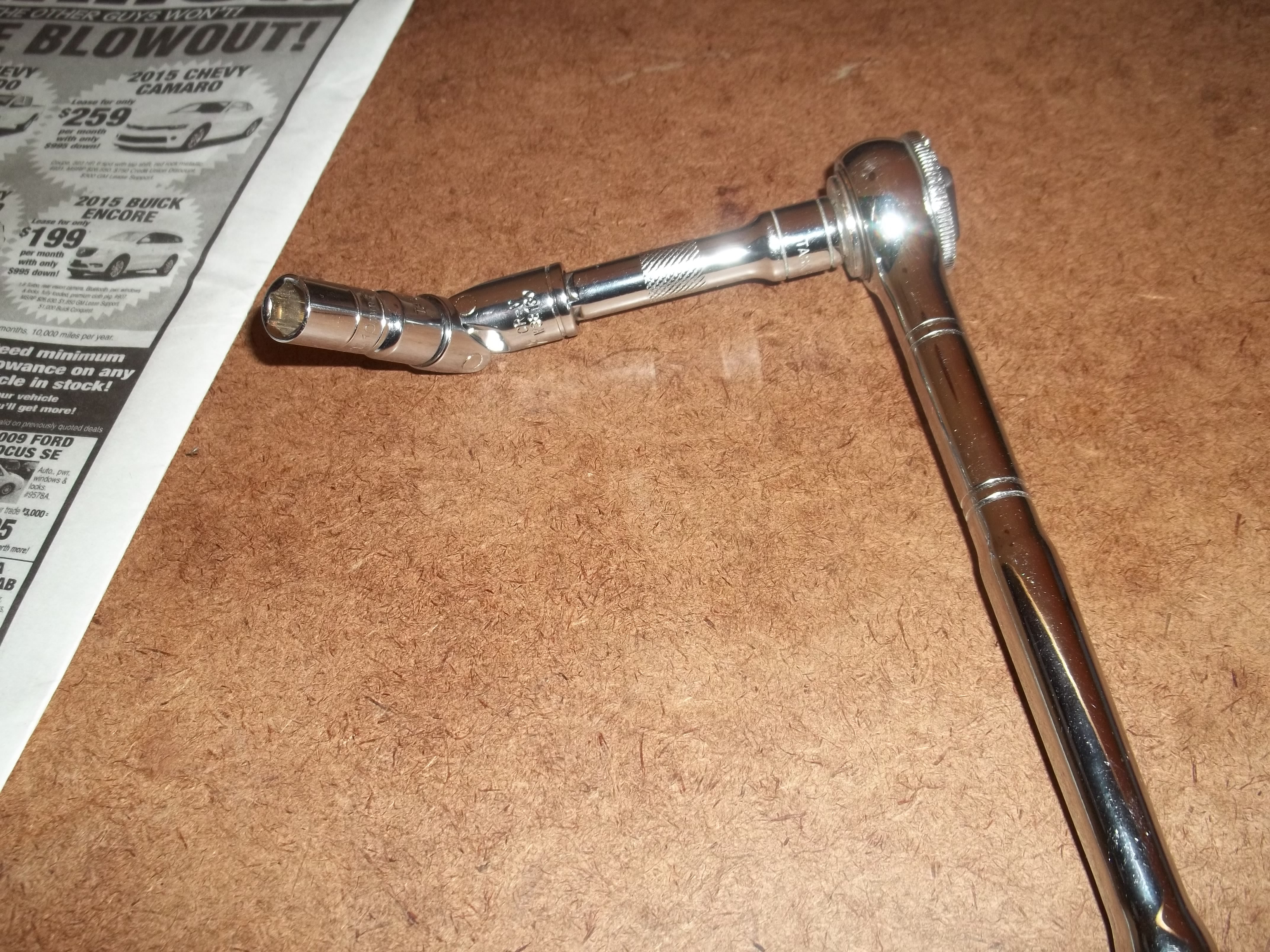

Right now I have a 3/8 ratchet to 3 inch extension to U-joint to reducer to 1/4 10mm socket.
What you can see is that my swivel is 2.5 inches back from the tip of socket.
Really I am just trying to decide if I am ready to attempt this this weekend.
My local auto store in town has 3/8 extensions and probably a 3/8 10mm socket but no swivel 10mm socket or 1/4 inch extensions.

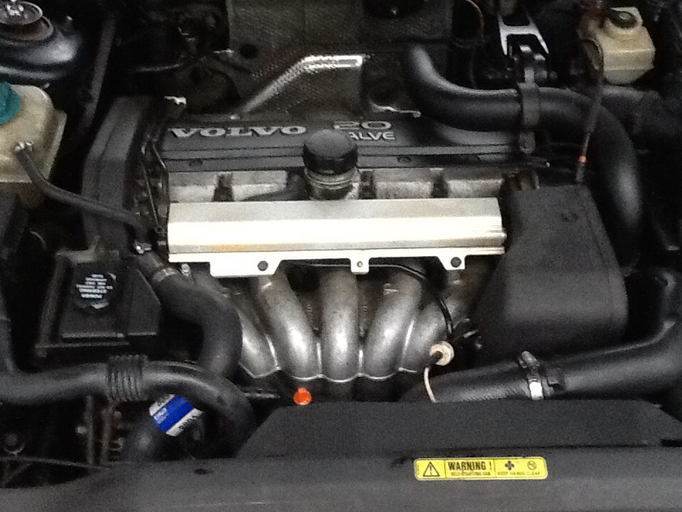

Hey RussB you got quite the pictures. Do you happen to have any to help me identify the location of the 2 12mm lower manifold bolt? Thanks...

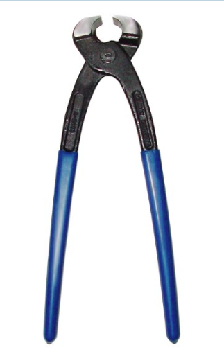

P.S. I ordered one of these:
Hey, Should I order a swivel Socket set for 30 Bucks and a 1/4 extension set?
Or can I make due with a 3/8 Socket, U-Joint, and a reducer or not... and a regular 3/8 or 1/4 10mm socket?
