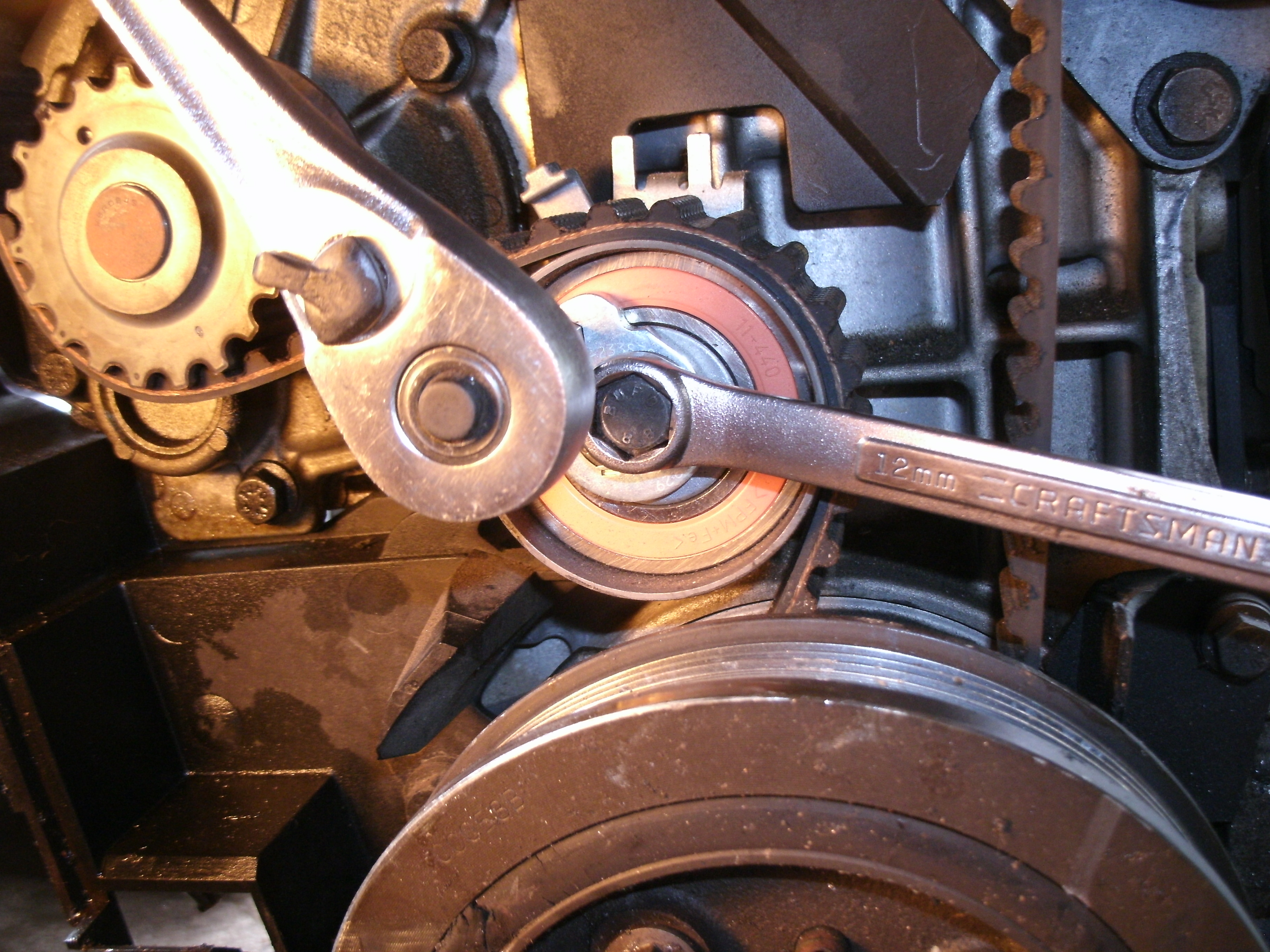

Are you sure you are adjusting the mechanical tensioner correctly? The center bolt on that version does not set the tension. It is a "two wrench" setup to adjust the mechanical version. Like this:
I think you are doing it right and if it doesn't adjust the indicator when the allen wrench portion is adjusted then mechanical tensioner is just plain bad.

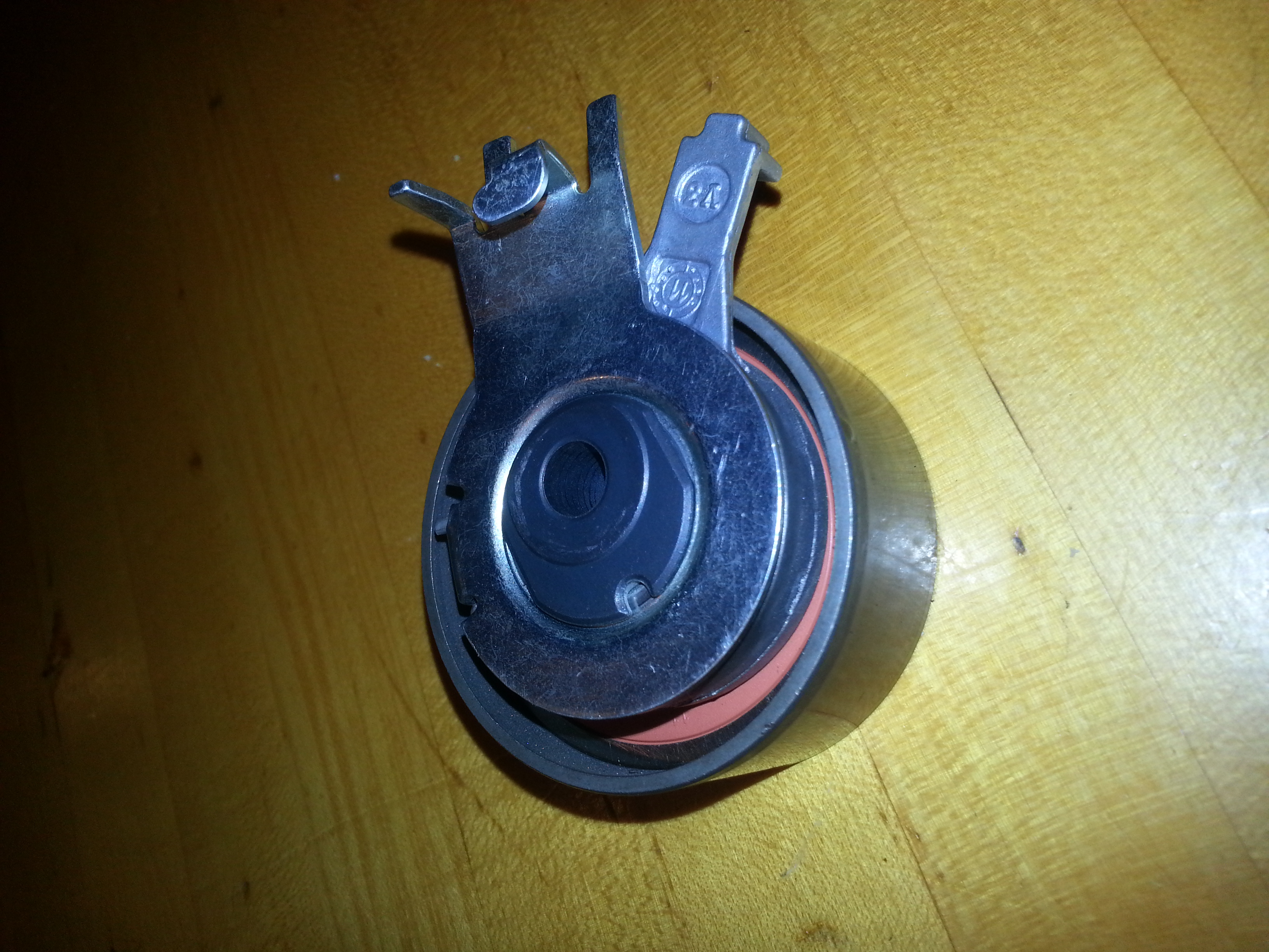

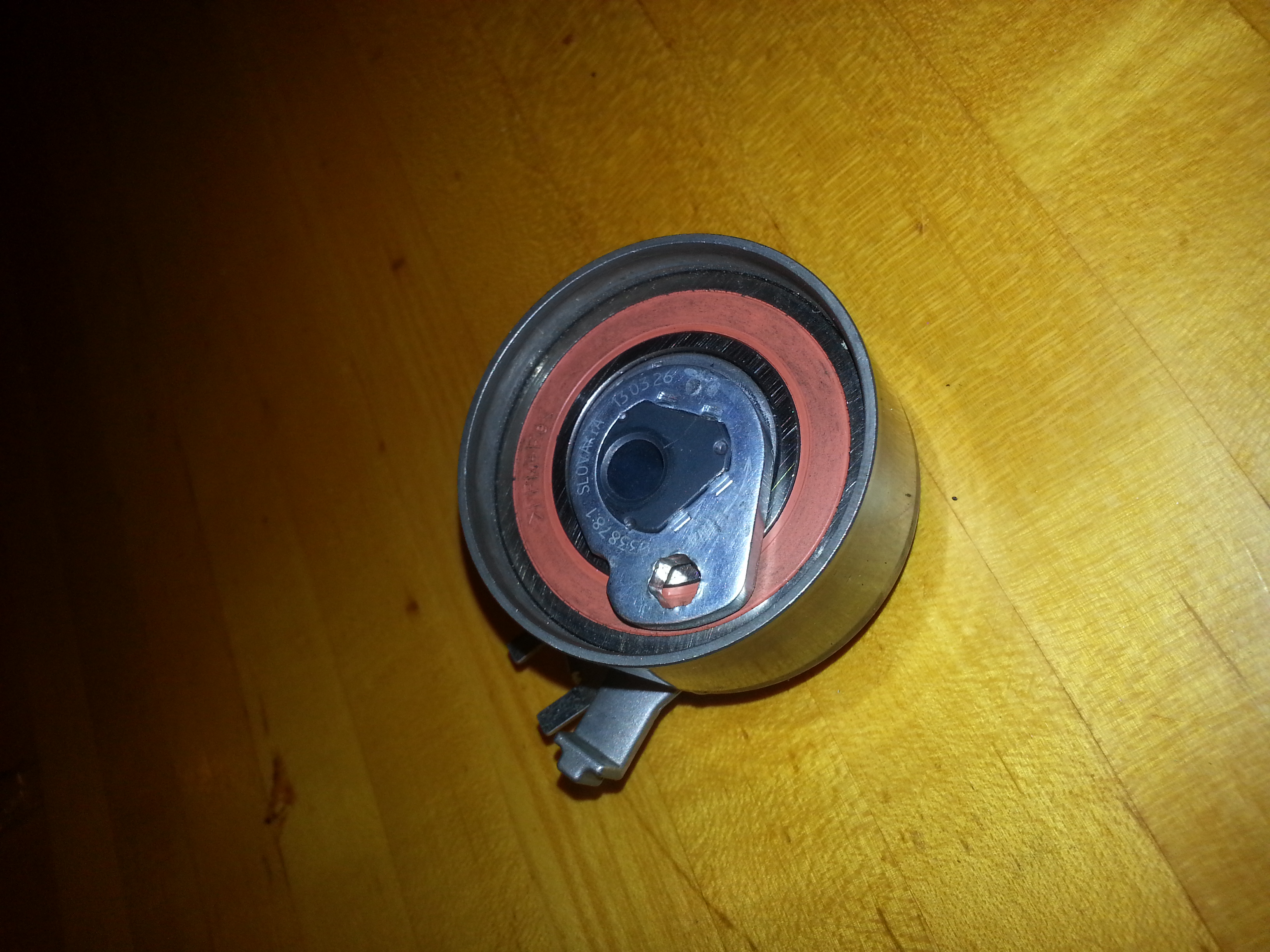

I have the exact same tensioner, it says INA Slovakia, I bought it new last year. The original tensioner looked exactly the same but it said INA Germany. It is very common to switch country of mfg when the car is out of production so I think it is legit. If it's counterfit it is impossible to tell. My original tensioner was making noise. Never heard of one failing like you describeClockboy wrote:Here are images of the offending part. I think the tensioner just failed internally. Thinking about breaking it apart just to have a look.
Post some pics of your idlers.
