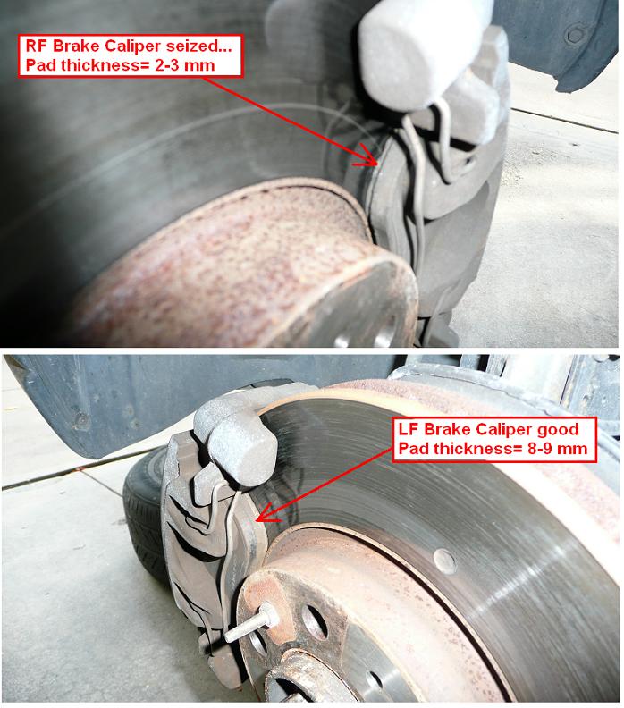

Been there done that. Car veered to the right a bit.
Thought it was alignment issue, but it was aligned properly.
Turned out the RF caliper was seized.
You can see the seizing even without removing the wheels.
Get a flashlight and shine in there.
If there is uneven wear on the pads, it is telltale sign of a seized caliper.
See the photos of my seized RF caliper:
More detail below:
https://www.matthewsvolvosite.com/forums ... 1&start=28
More detail below:
