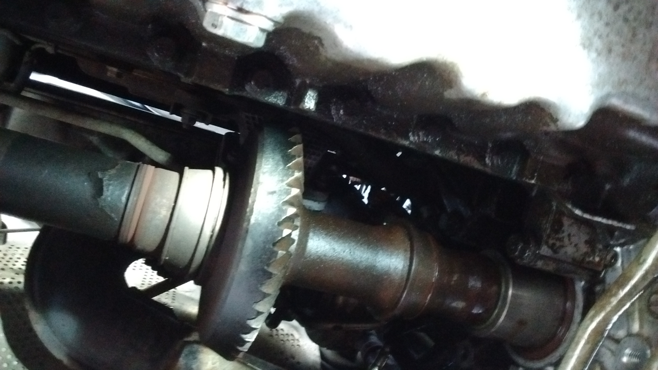

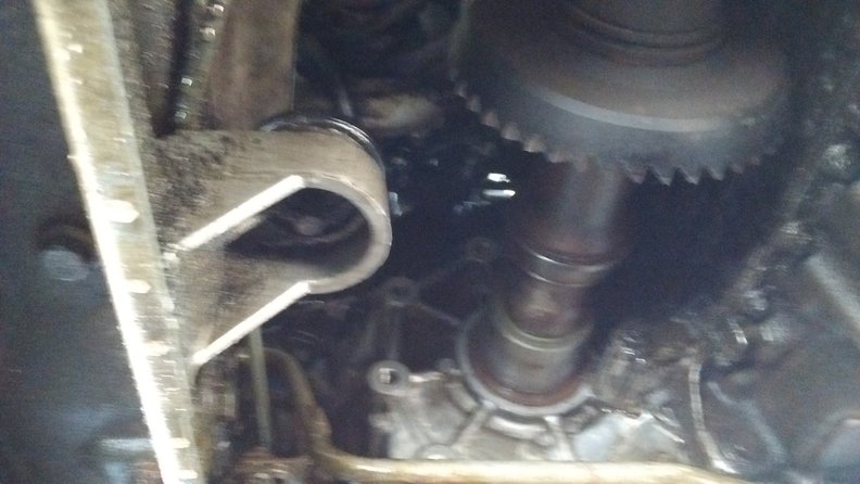

When I bought this I was told the driveshaft went so no AWD, I was like I get a rebuilt unit. When after bring I find more missing than I was told. I took pics but all I have is the R/F CV axle with a big gear and the coupling to seal into trans. I've looked at diagrams but I don't see how or why this was done unless transfer case was shot and previous owner was being cheap.

This is the obvious answer. I must say, that is a fascinating method for holding the AWD drive collar between the transmission and the transfer case in place. My guess is that the transfer case was the root of the original problem.shiloh51933 wrote:I don't see how or why this was done unless transfer case was shot and previous owner was being cheap.
You will obviously need a prop shaft and the case to even try to get the AWD working again. I would test the viscous coupler first before you spend any more money on getting that part going again.

Agreed, much better than the hose clamp method I usually see.
Just like Lee said, your going to need a whole new angle gear and prop shaft. I'd make sure the viscous coupler is still in place and functional. I'd also check the rear diff for oil leaks and rear axles to make sure all the boots are in place before buying any parts.
You have a VIN break year so you'll want to make sure you get the correct side of it when you find replacements.
