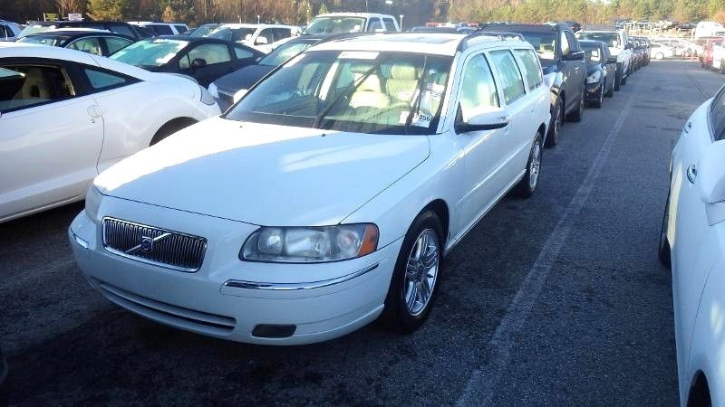

Sort of weird looking with those wheels.
If you like the OEM shocks consider at least changing the rears to new ones. At your miles, they're pretty well shot!

Lowered cars should have larger wheels and tires, plus those wheels are about the ugliest wheels ever.
I can say this too I just bought the same car last week, in white with the same wheels!
If it had 17s it would look (and handle) a damn sight better, big time.

I'll admit I'm not a big fan of these wheels either. I'll probably plastidip them black at some point, maybe that'll help. When these tires are worn I'll probably spring for new wheels, maybe I'll do 17s as you suggest.
