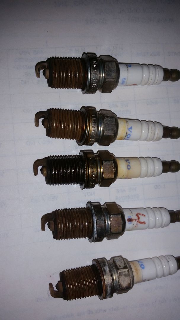

Update: Took advantage of NAPA's bucket sale (20% off everything that you can fit in the bucket) and got the Eichlen ignition coils for $46 apiece, saved $79 bucks off my entire order.
Drizzly yucky day here in CT and I have no garage, so I set up my pop up canopy, took my time and replaced all of the plugs and ignition coils. As you can see in the pic the plugs were well overdue for replacement. I was getting misfire codes on cylinders 1 & 3 as I mentioned in my original post. All of the plugs as I removed them gave resistance then "broke" loose, except #3, it just unscrewed. You can see wet oil residue on the #3 plug, whereas all the others have dry threads.
Easy job, about 2 hours start to finish including doing a back flush on my heater core. Still can't get the air "hot" though, only warmer
Engine is running FANTASTIC now.

I'm guessing those gaps are 040-050, almost twice spec

Oh yes... Excessive gaps = excessively high voltage in the secondary, which kills the coils in a short order.
Did you massage the coolant hose to the T-stat housing; this may help bleed the air trapped in the system. I hope the T-stat is correctly positioned with the bleed orifice facing forward

I swapped 4's coil with 3, and confirmed with the code checker that the coil was bad.
I also had the one wet plug, and the plugs needed gapping; so I replaced them all, after setting them to the proper gap.
I'd recently replaced one of the other coils, so this time got four more new ones; so that I now have 5 new ones, as my wife drives this care most of the time. I saved the used-working ones for spares.
IPD has the best price on plugs right now ($2 each) and Amazon has the Bosch coils for $43-ish.
I'm interested in others' thoughts. In my time working on my cars (40+ years) I've seen events where one stressor takes out other parts. I think what happened in my case, and in Regent's situation, is that bad gas made the aged coils work harder to fire all of those excessive-gap spark plugs, and 'pop' went the one coil. The gas was the original problem, which led to the coil blowing through overwork.

The gas fill was probably coincidental to the ignition failure rather than casual. Hard to prove of course. Ethanol gas does suck up water better than non-ethanol gas of course, so there is less need for dry gas ( methanol or isopropyl alcohol)
