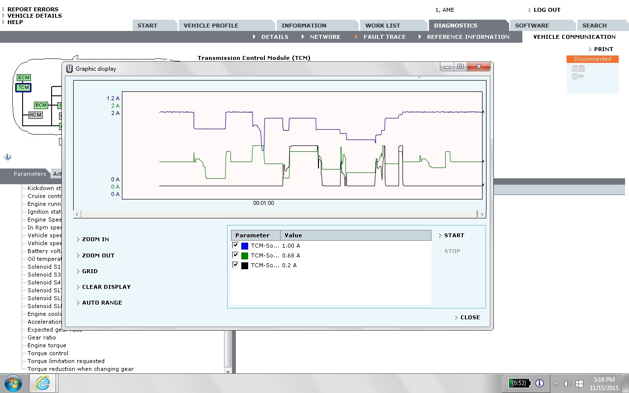

My parents have an 07 V70 XC, so I put vida on it and ran a graph of all three solenoids, here it is-
This is key on II, engine off starting in park, going to R and waiting, then N and waiting, Then D, then 1,2,3, and then 3,2,1,D,N,R,P.
On my car, all three are flatlined at 0 amps while performing the same task.

Looks like a TCM failure or power supply issue. I doubt connections to all 3 solenoids can fail in one day. Has the earth/ground been verified for the transmission?
