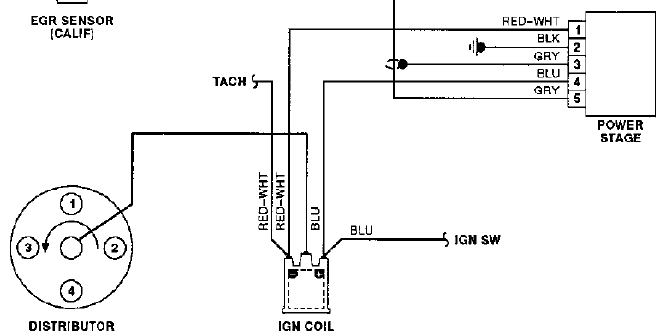

Coil Test for Voltage - I just grabbed this diagram off of the internet, but with a test light, ground one end to vehicle's battery, and have someone hold other end on the Blue wire at coil. Turn ignition to on position, does test light turn on? If so, start vehicle with person holding test light there...if vehicle dies, is the test light still on?
There are a series of tests to perform, this is only one of them.
Another experiment is to leave that fuel pump jumper wire hooked up, then use test light and see if it is always lit.

Post by 93Regina »
Here's actual wiring diagram
