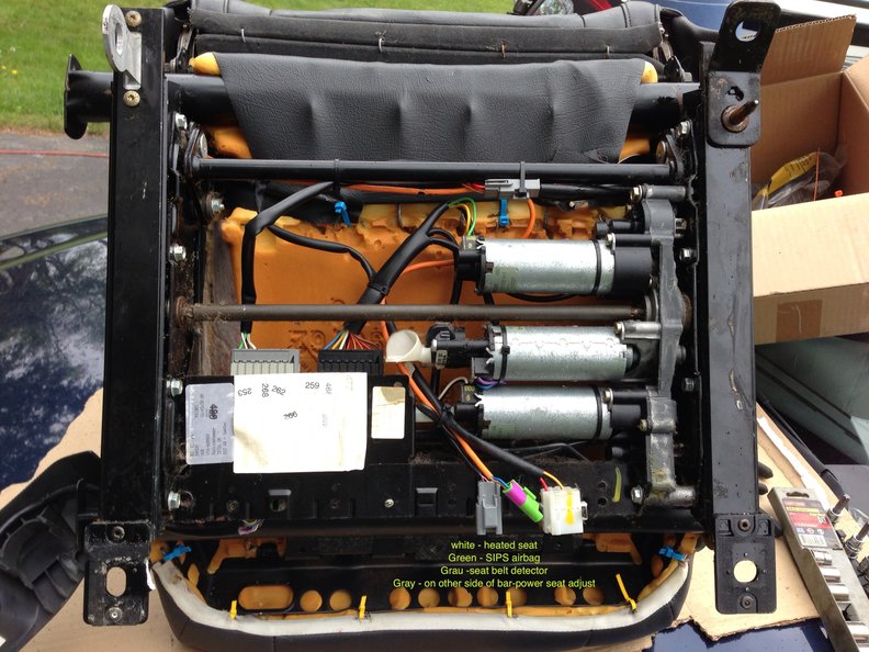

I swapped seats from a '99 V70XC into my '97 850 GLT. Passenger and drivers side have heat and are electric, but I do not have functioning SIPS. I swapped the '99 seats on the the base/frame of the 850. With the attached picture of the '99 wiring received from moderator "abscate" I was able to get all electronic functions working - electrics including memory and the heat.
My original post: https://www.matthewsvolvosite.com/forums ... =1&t=56978
