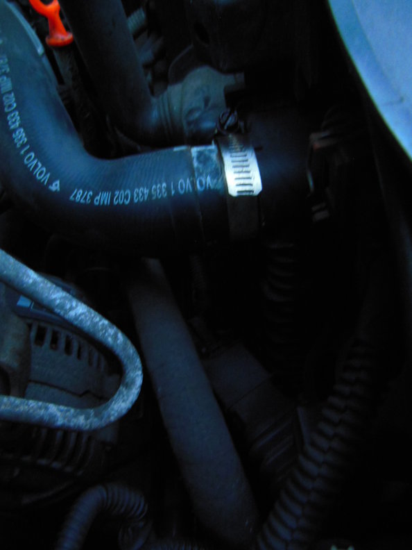

First time poster here.....my girl is a 1998 S70 T5 with 124K and no rust. I want to keep her.
She's been pretty great, but last Friday, after start up, all the warnings lights turned off except for TRACS & ABS. They eventually went off after a minute or two.

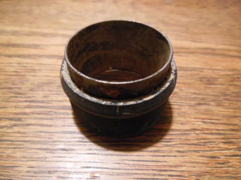

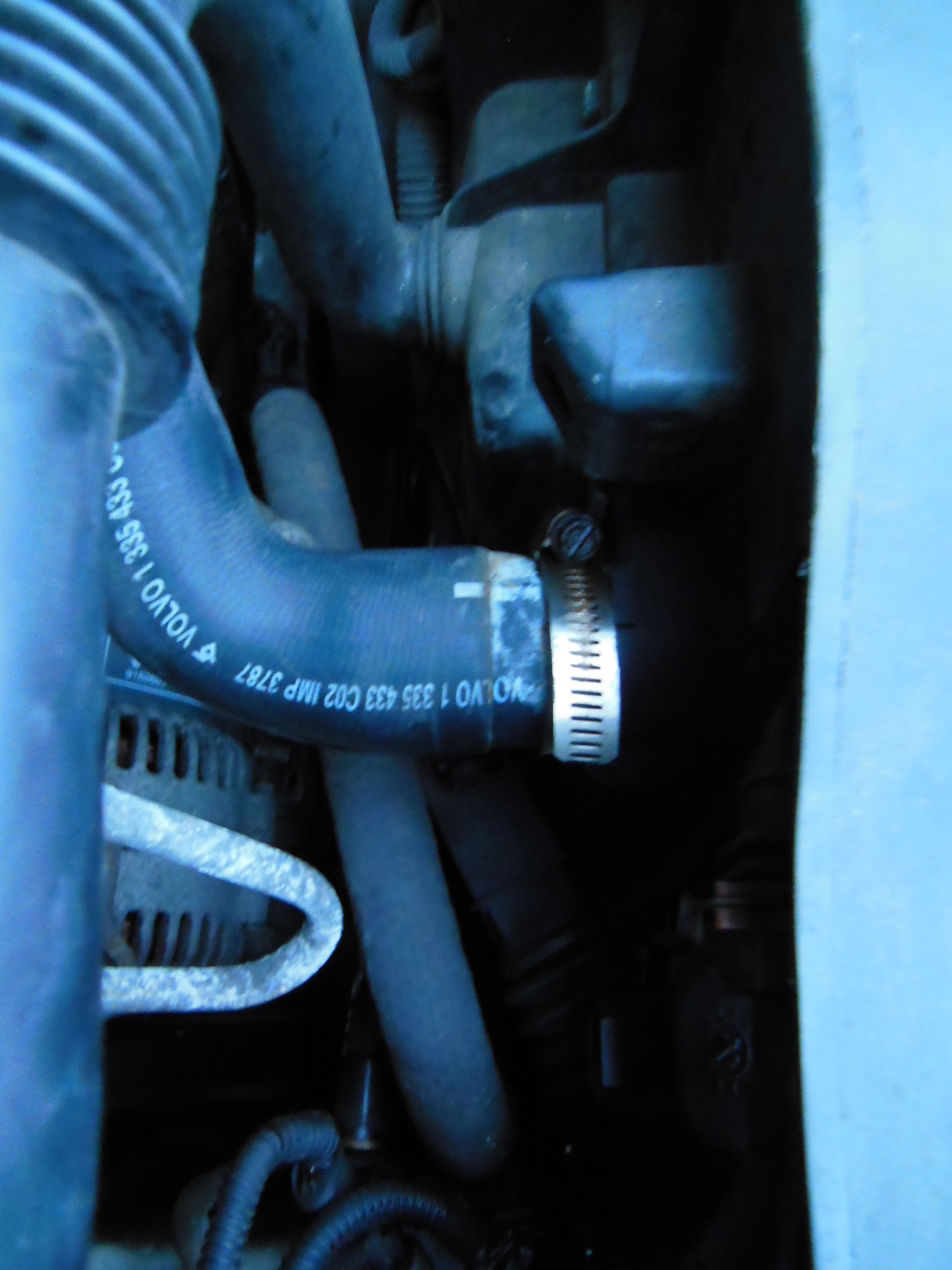

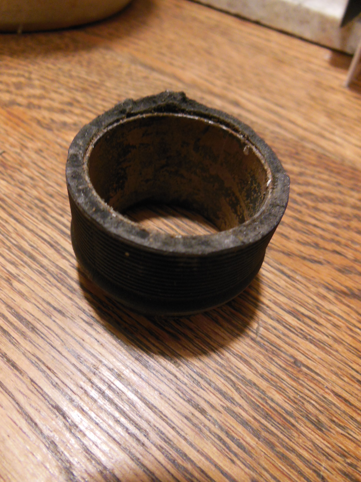

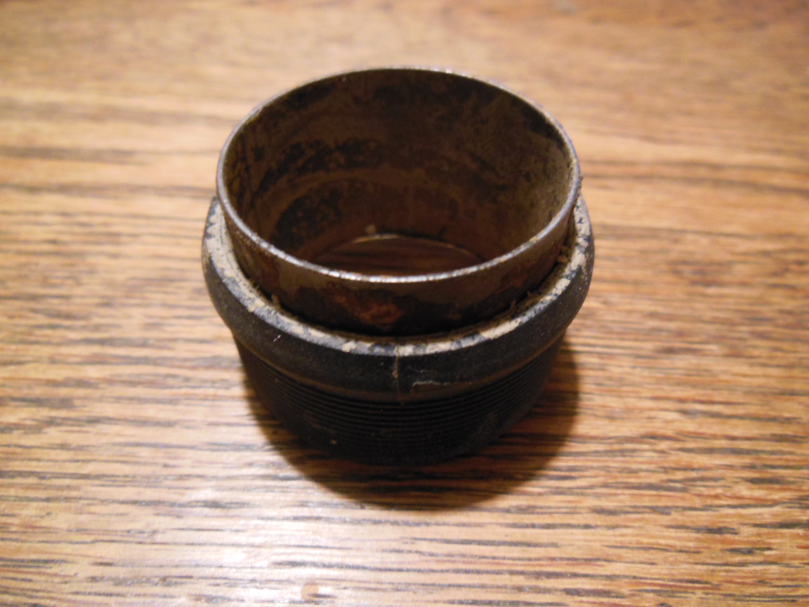

Then on Sunday, after arriving home, I noticed the fan kept running--> after I turned off the ignition. Went and retrieved hubby to investigate. He found the anti-freeze pretty much gone from the reservoir & then noticed a hose detached from the radiator. At first he thought it was just a rusty clamp--but then realized it was a break. To be make a long story short, he felt there was enough room on broken part to reattach the hose and did so with a new clamp. We added fresh antifreeze, and I did drive around town today but with much trepidation (and a bottle of anti~freeze :|) . Things held up, but then while driving I noticed the TRACS & ABS warning light came on and stayed on until I turned off the car.
Am including photos of the fractured part and new clamp. My husband is hoping this fix can last for a bit.
My question, gentle expert reader, is--what do you think? Is this realistic?
And, are these two issues related in some weird way?
Do I need a new radiator, and, if so OEM?
Any advice greatly appreciated because, as you know, knowledge is power :-)

That is a common failure of that hose pipe on the top of the radiator. I am surprised your husband could cobble it back together! It indeed must be replaced, don't trust that fix long term.
Your best bet is OEM, that's what I buy on rads, but many people on here will vouch for other brand radiators (which cost less), like Nissens. If you want to keep this car a while, this would be a good time to get a new lower radiator hose, you will be in the area anyway and often those are original on cars of this vintage. Buy Volvo on the hose too, otherwise your old one may be better than some of the crap aftermarket hoses you can get. Upper hose too but those are easy to change whenever, you can use your judgment on that one. Great OEM prices here: http://volvopartslisle.com/.
The TRACS/ABS issue is likely just a coincidence. I can not see a logical way to connect them and every ABS module on a 98 has either already failed or is about to. The solution is at this web site: https://www.midwest-abs.com/. You will need to swap in a repaired ABS module. See also https://www.matthewsvolvosite.com/forums ... =7&t=73451.
