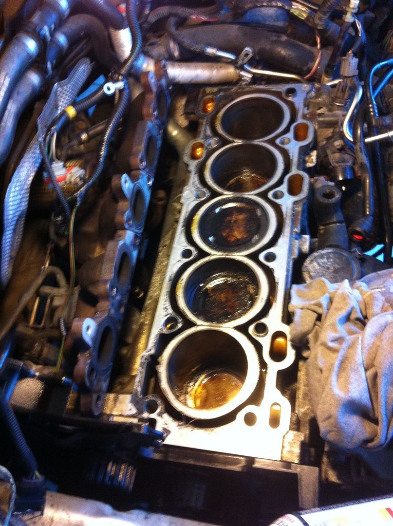

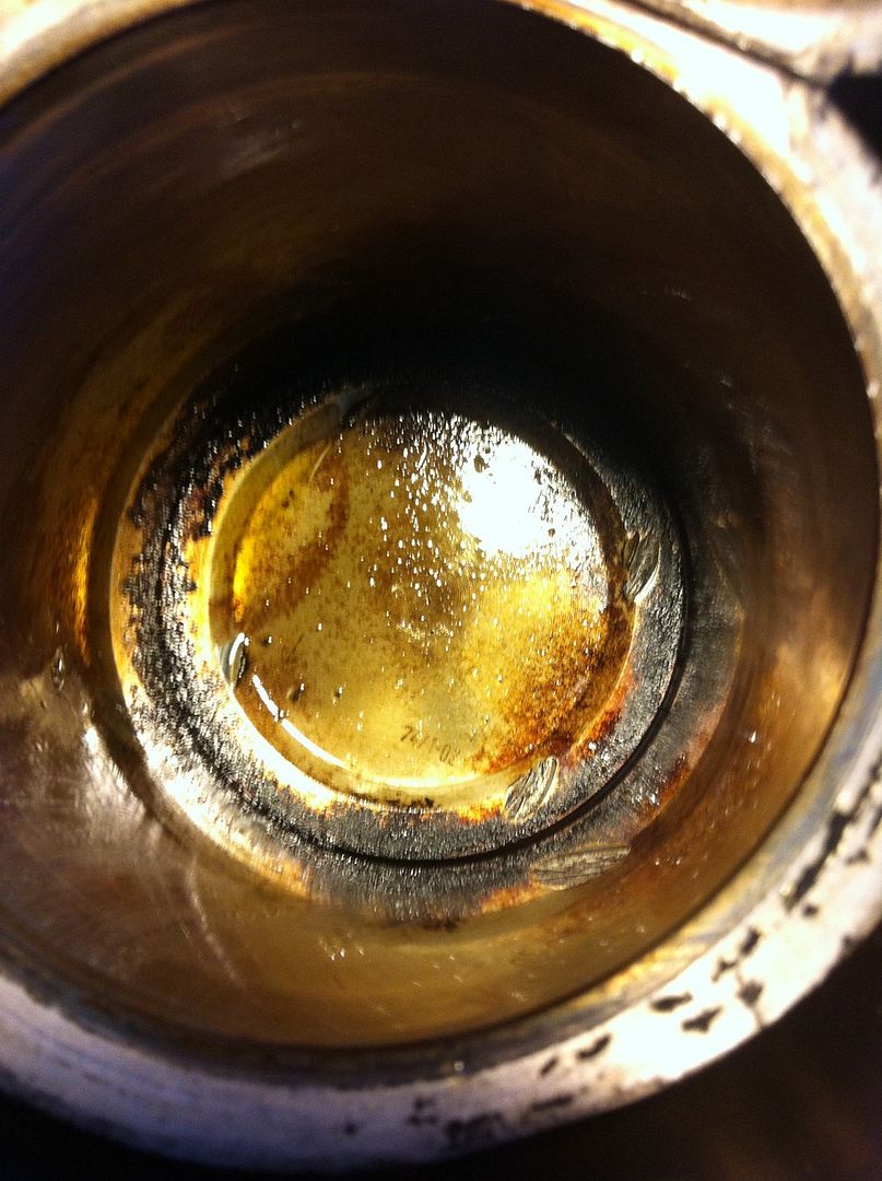

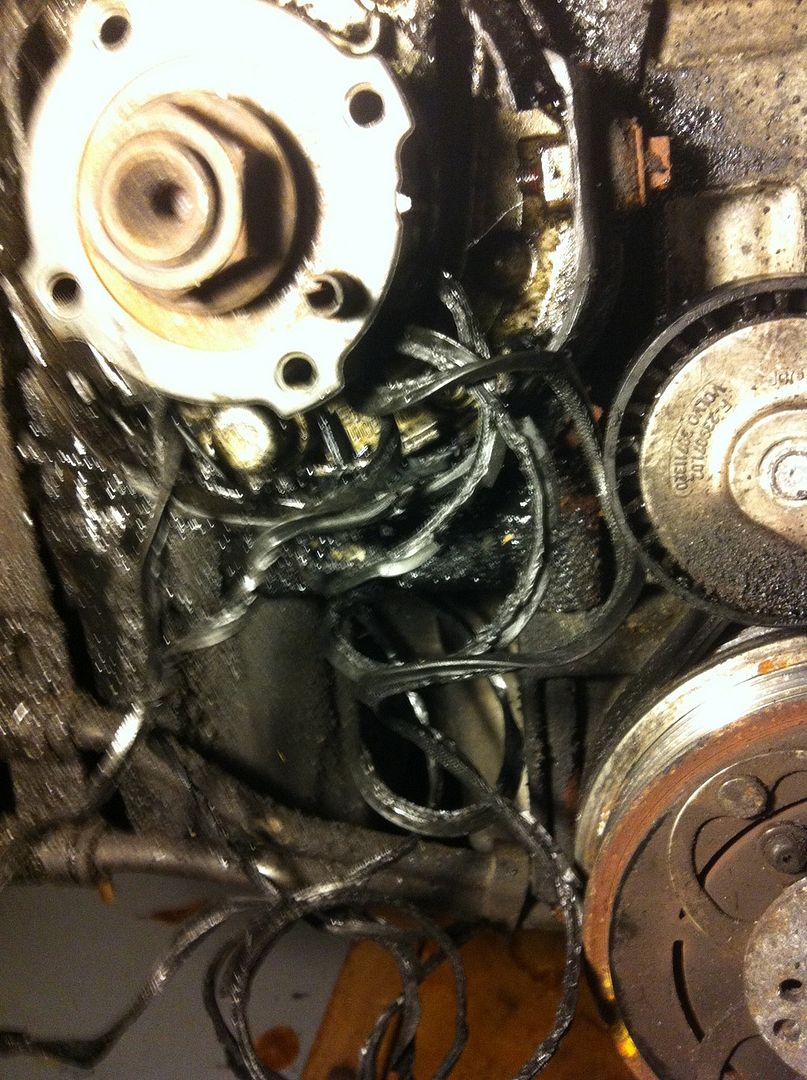

OK Im back after a long break from the V50. I disassembled and found the timming belt was "shredding" and the debris got wrapped around the crankshaft sprocket causing the belt to slip. I also found the belt tensioner not very tight.
Quite a mess
From the top of the camshafts the belt looked fine.
Anyhow all 20 valves have impacted the pistons and most valves are bent. Fortunately the pistons were only scarred.
