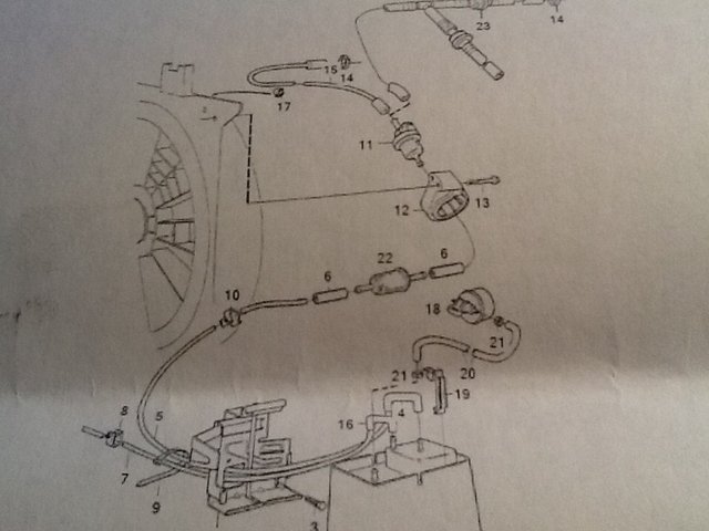

The hoses that were broken on my 98 V70 AWD were the two hoses at the rollover valve, two hoses at the filter leading to the purge valve, the two "U" shaped hoses on the canister and the hose leading from the canister to the vent valve. Make sure your hose routing is correct from the two "U" shaped hoses on the canister top. The hose in the center of the elevated square on the top of the canister goes to the purge valve. After the purge valve check all the hoses leading to the intake.
