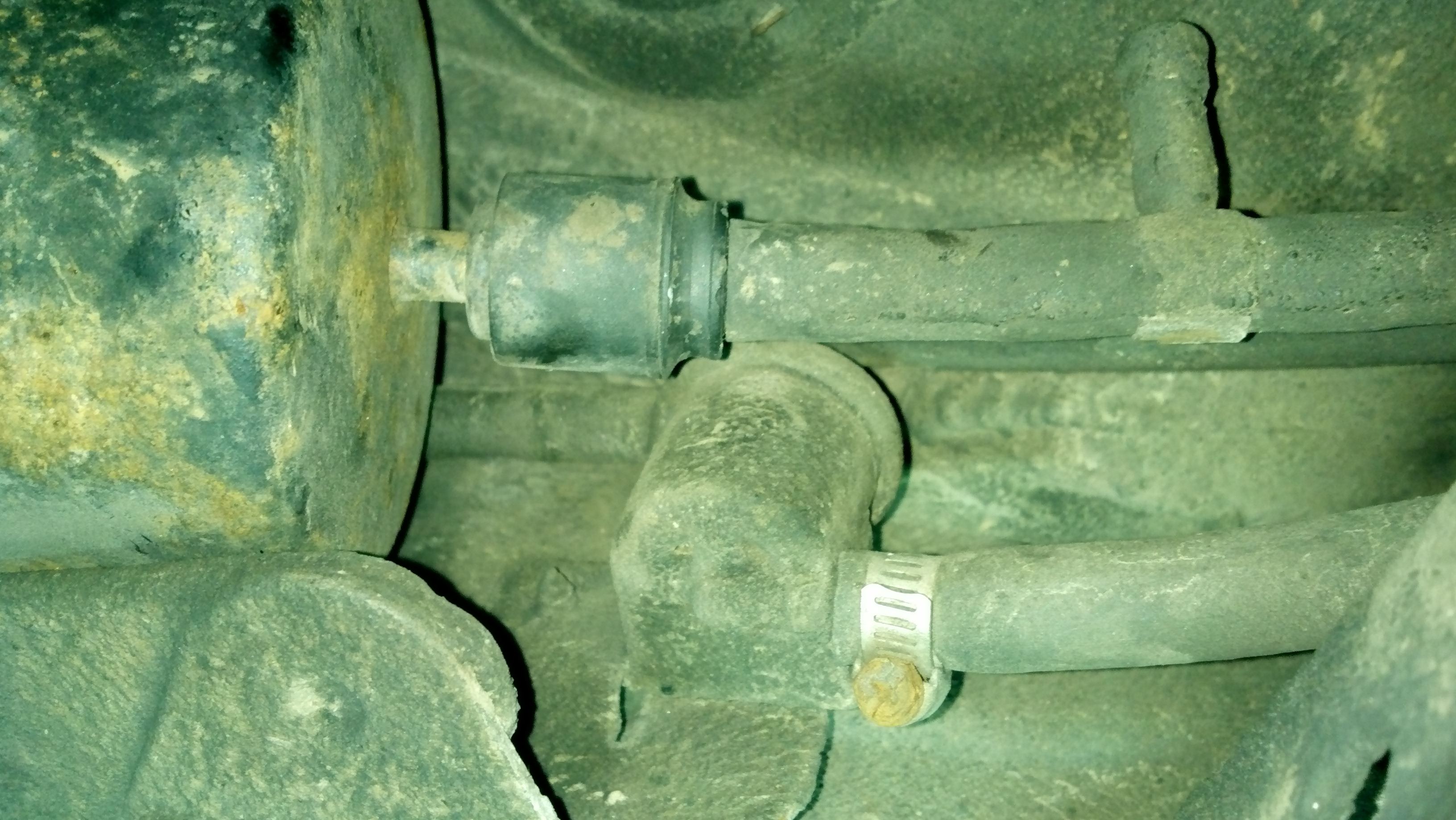

. The car has been a PITA to fuel for a while now. Pump always clicks off after a liter or so. I removed the canister vent valve this aft replaced it with a nylon elbow. The lead attached to the cvv showd 10 volts. The cvv was quite obviously in the closed position. I pulled the manifold side hose off the purge valve and it had tons of suction. Couldent get the other hose off due to some shrinkwrap hose connection stuff, but there was no hint of vacum at the now free flowing canister. The lead to the purge valve displayed 7-8 volts. hopefully it can purge freely now. I understand the purge valve only activates at certain times. I also went into the wheel well and the air cleaner on the fuel pipe is unobstructed.
Is there a way to test these solenoids on the bench? How much juice etc? Not really into the shotgun approach when buying parts. Hopefully something deep inside the tank is not to blame. Many thanks.

That looks like roll over valve to me and it have a replacement clamp.Somebody allready have been in that area before.ttermyna wrote:Jimmy,
Thank you for the troubleshooting info. I have attached a picture of the part which I mistook for the ORVR valve. It is next to the fuel filter. Any idea what this part is?
