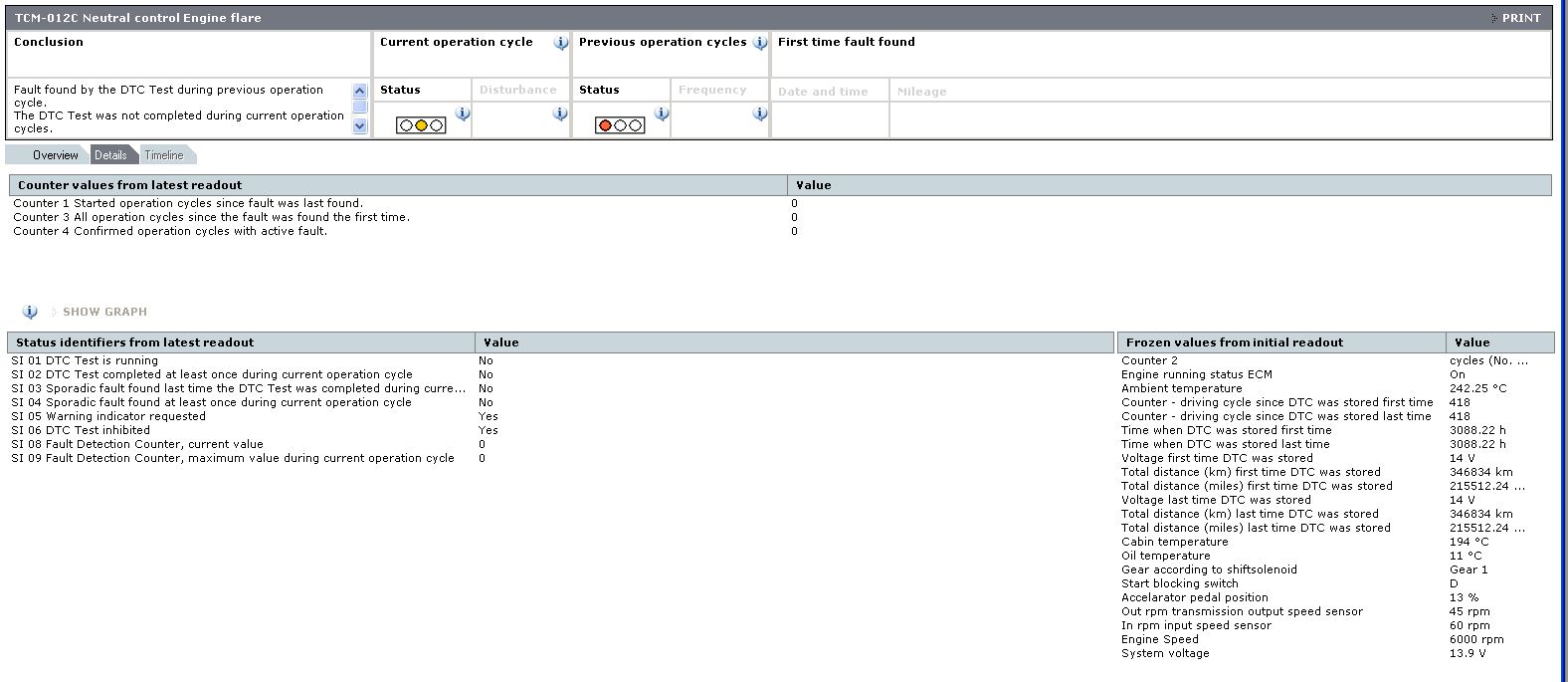

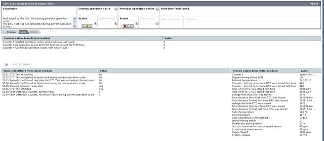

5) VIDA shows the tranny fluid to have been at 11 C, but then it promptly destroys its own credibility by also claiming a cabin temp 194 C and an ambient temp 242 C. If the ambient temp was 242, this would be above the ignition temp of paper (per Ray Bradbury's book title "Fahrenheit 451", which would be 232 F ) :roll:
Note the strange readings for some of the values at lower right - cabin temp 194 C?  I don't think so! Ambient temp 242 C?  Not likely!

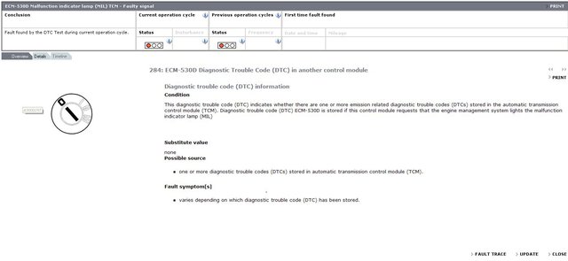

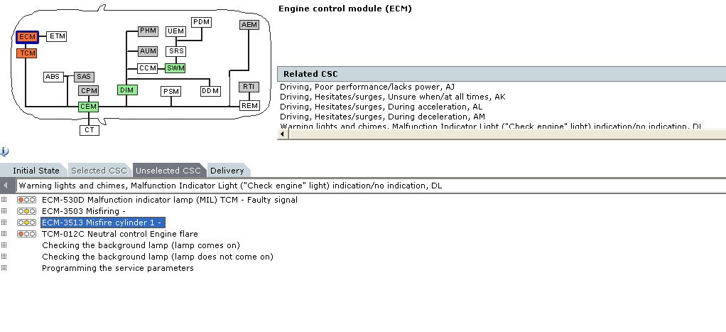

7) But the VIDA screengrabs below confuse me more, as they present a "conflicting opinion" from the ECM that the TCM error signal might be "faulty", and they also introduce an apparently unrelated "misfire" event from Cyl #1.

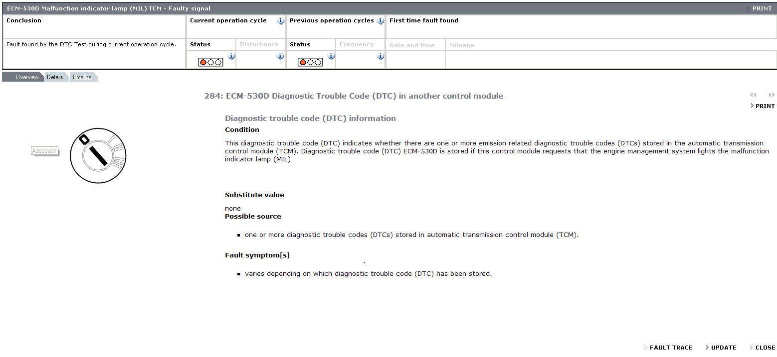

Any clues that anyone could offer would be welcome, but other than checking the tranny fluid level, replacing all the plugs, and replacing the #1 coil, I am unsure as to what I might do, other than wait and see if I get another such error.
Not sure what to make of this - why does the ECM claim that the error signal from the TCM might be "faulty"?
ECM-3513 seems fairly clear, I am misfiring, and may need to replace plugs, or perhaps the Cylinder #1 coil.
