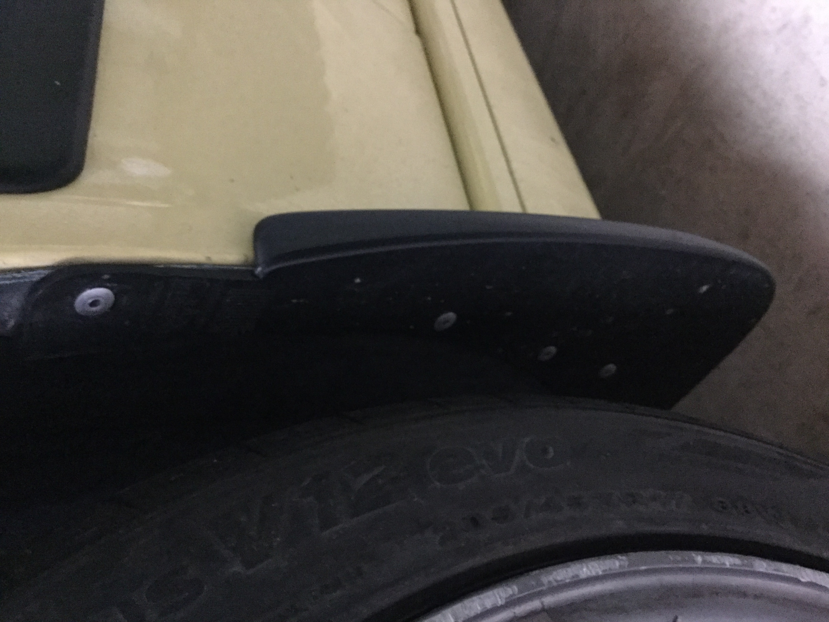

Post by pkc303 »
I used aluminum pop rivets, and painted them black. Holding well so far.

Post by pkc303 »
I didn't use any washers, and haven't painted them black yet. Here is what I did.

Post by PeteB »
Exactly what I had in mind, thanks, looks fine.
