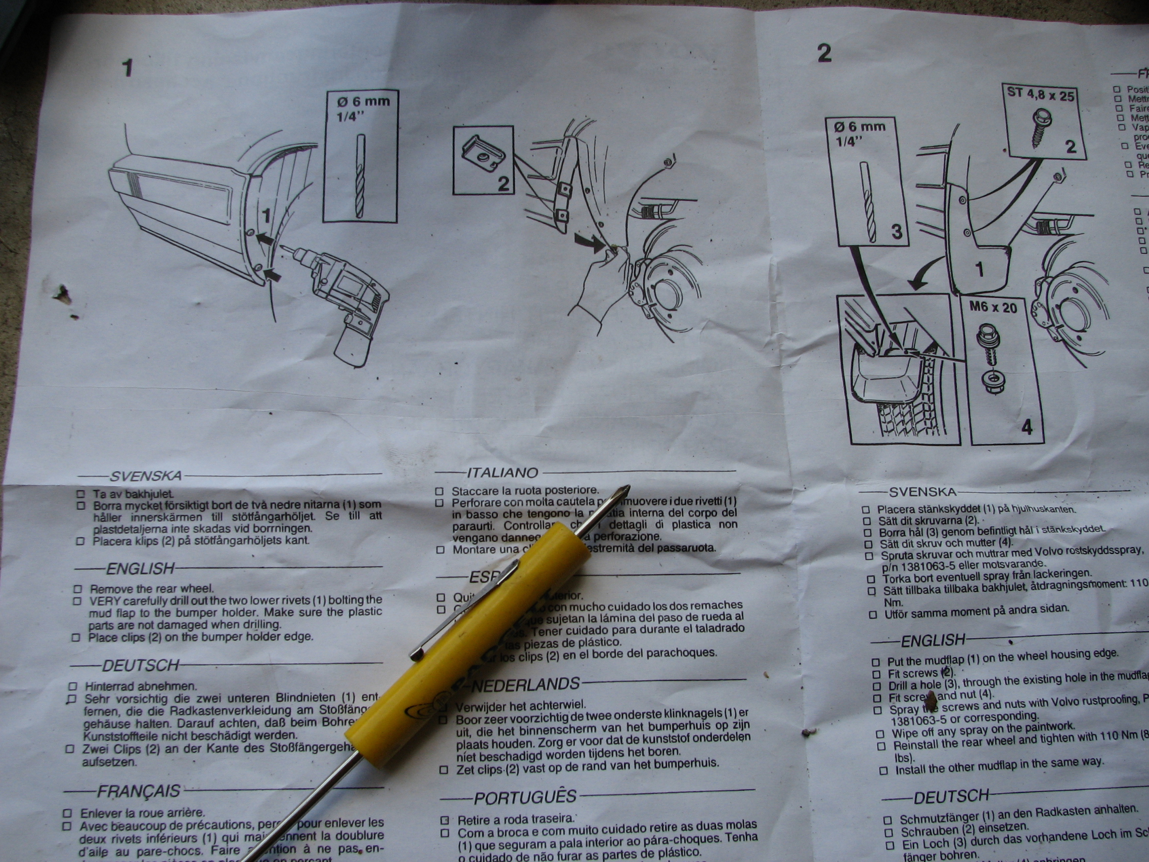

Are the liners in the front riveted in? I know on the right side, a couple screw/fasteners allow you to fold the flap back to access the crank pulley. I wanted to fold the left side back, to access the carbon filter, but it looks like its riveted on. Are they common blind rivets?

I found one post that talks about pop rivets. I guess simply drill out and replace with common steel pop rivets?

You have to drill them out, or just pry a bit with a screwdriver then nip them off. I have also used those push-in plastic fasteners as a replacement, they are very easy to use and work great.

Like these:

erikv11 wrote:You have to drill them out, or just pry a bit with a screwdriver then nip them off. I have also used those push-in plastic fasteners as a replacement, they are very easy to use and work great.
I like the idea of the push in plastic retainers, less chance of corrosion. I'll look for thin retainers at NAPA.

I would have thought the OEM rivets would be stainless. Aluminum rivets into steel can cause galvanic corrosion. A wheel well is a hard environment, wet, salty.

Yes, that is one of the few areas I have seen, and repaired rust on 850 fenders for my cars.joe_pinehill wrote:I would have thought the OEM rivets would be stainless. Aluminum rivets into steel can cause galvanic corrosion. A wheel well is a hard environment, wet, salty.
I still use those rivets though to attach the front mud flaps.

thanks for the photos. Rather than drilling out, I was thinking of carefully grinding the head of the rivet with my Fordom tool and carbide cutter. I have better control with the Fordam.
