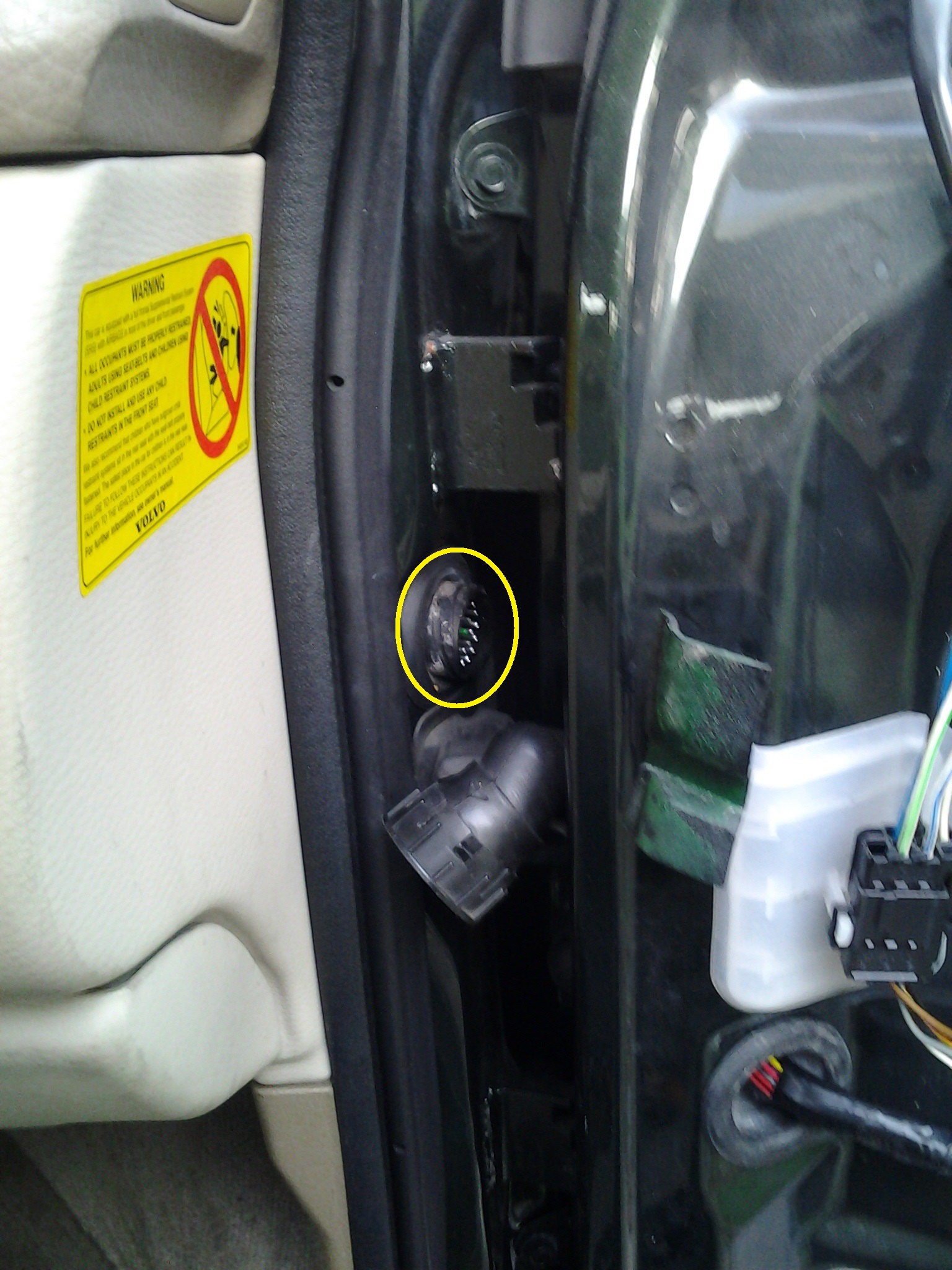

Pulling off the door panel wasn't necessary here, but behold the work area. The door jamb connector is found within the orange square.

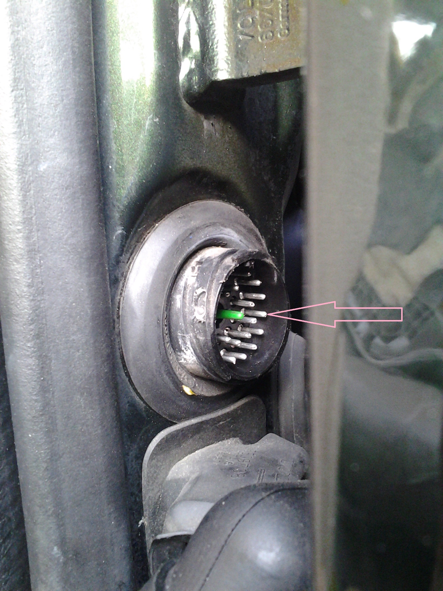

Inside the yellow circle is the male part of the door jamb connector. Those little pins arranged in concentric circles are what I inspected for damage, before moving on to the individual wires leading into the doors.

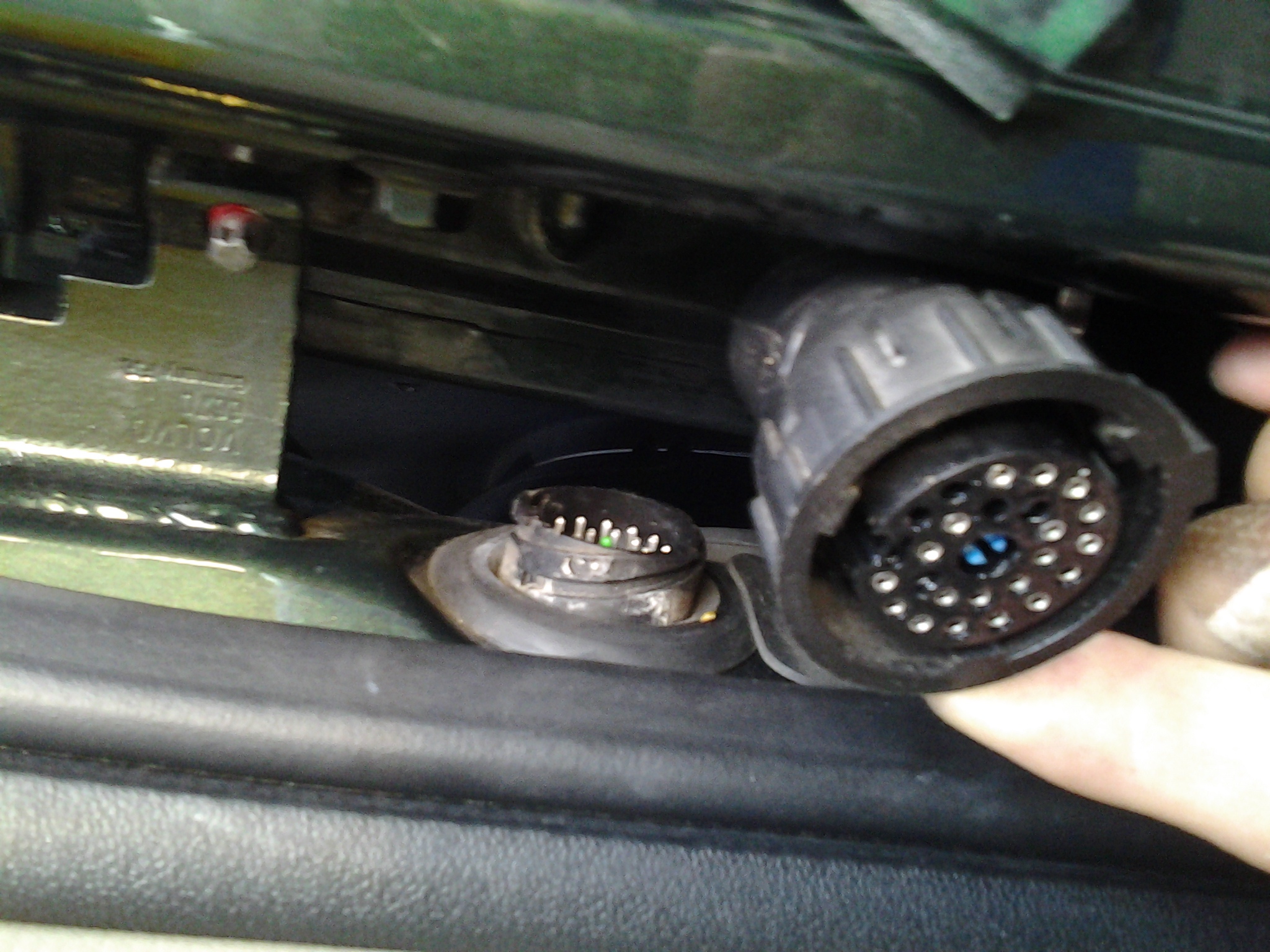

Here you can see the female part of the connector. The connectors are easily disconnected with removing the torx screw (not pictured) and the black plastic collar can be rotated anti-clockwise.
Finally, you can see the little connector pins (pink arrow pointing to one of them). ONE of those pins on my driver's side was pushed inward, not allowing complete connection. I grabbed a 90-degree needle nose pliers & plucked it outward. The pin stayed still after tugging with moderate force, & I was happy once I reconnected everything (not forgetting the lil' torx screw on the locking collar)...BECAUSE MY PASSENGER WINDOW WORKED!!!
