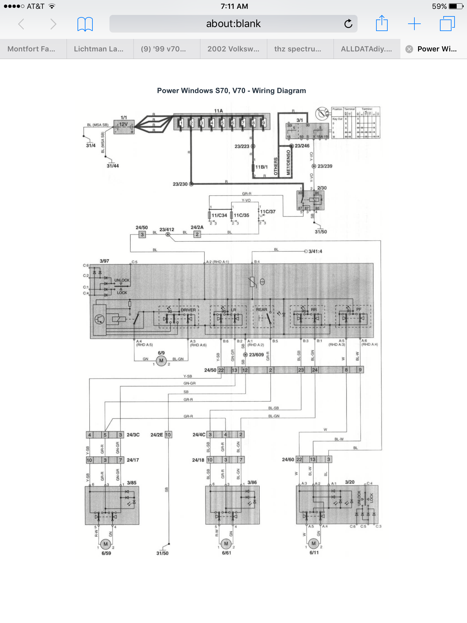

There are two wires from the motor to the switch connector.
You can jumper the window motor to power there.
Reverse the polarity to reverse the up and down operation.
The master switch MUST BE UNPLUGGED!!!
These are the power and motor pins for the drivers window:
12 + = Blue - Pin A2
GND = Black - Pin B4
Window Motor = Green - Pin A4
Window Motor = Blue/Green - Pin A3
- Posts: 36137
- Been thanked: 4064 times
See diagram below from alldata

None of this seems to be working. I've ordered a new switch but I still think the problem may be elsewhere. In the meantime, is there any way to mechanically crank or pull the window back into place?
juggles
- Posts: 21
- Joined: 06 Dec 2007, 17:26
- Year and Model: 1999 V70
- Location: Kentucky, USA
- Has thanked: 2 times
Can anyone walk me through how to go about jumping the switch? Assume I'm not terribly savvy when it comes to electronics. I understand which wires are involved but I can't seem to get them to do anything so I feel like I must be doing something wrong.
juggles
- Posts: 21
Yes, the key is on. I just tried again. I was able to successfully short the passenger side window but I got nothing from the driver's side. So I'm feeling like it's something other than the switch.
