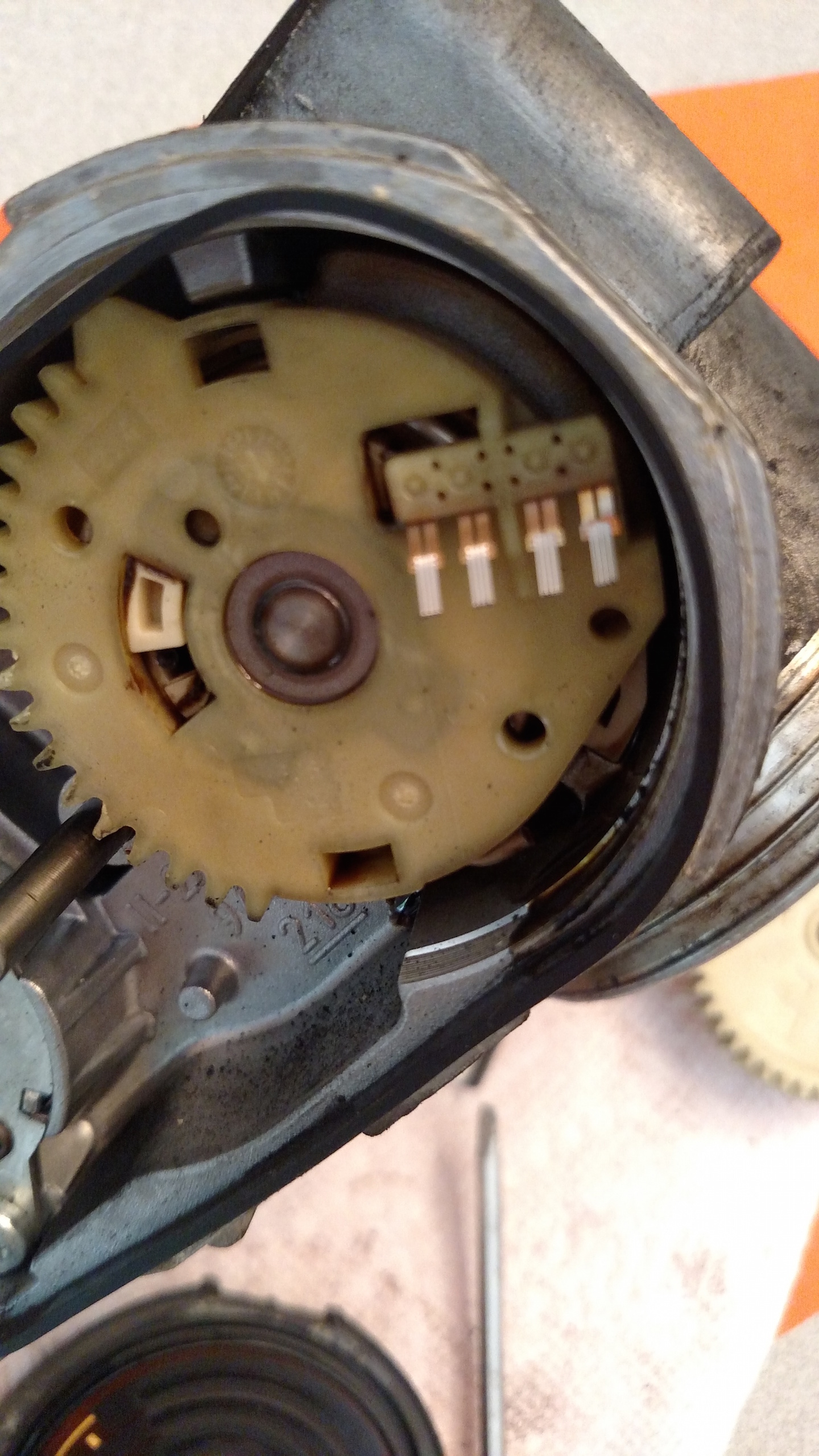

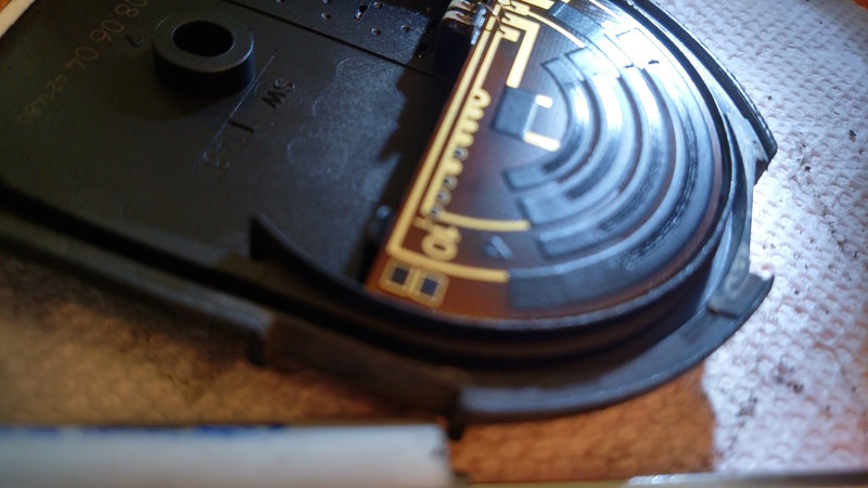

This again is the Bosh unit. I had already ordered a new replacement for $315 online. Local auto parts suppliers had them for $450 and the dealer for $580. I figured since I had a few days until the new unit arrived, I would at least gain access and remove the existing unit. Upon doing so, I found simple spring clips held the 2-piece Bosh body together. Upon removing, I found that the assembly is the widely used wiper finger/carbon track design. There was carbon "dust" spread around on the surfaces as well as within the housing in general. I took some brake cleaner and sprayed it on a paper towel and carefully wiped the carbon tracks, following the same arc. After doing this a few times, I then tweaked each "finger" of the contacts up ever so slightly so as to regain a firm footing once compressed to the carbon tracks when reclosed. I also cleaned out some oil accumulation puddled in the housing.
I am not totally familiar with how these contacts/carbon tracks operate with respects to cross-arcing when the carbon dust builds up enough to bridge from track to track - this may or may not be the root cause to a "failing" ETA throttle body.
At any rate, I reassembled it and figured "what the heck" and re-installed it as well as all of the wiring connections, fan, etc. I turned the key to position #2 as I had read in previous postings (no software required from what I had read) - letting it stand in position #2 for 40-60 seconds before attempting a start. I turned the ignition to start and it fired and died pretty quickly. BUT the ETS light and check engine did extinguish.. I proceeded to tighten all of the air inlet duct connections, tied up the electrical bits securely and attempted a start again - this time working PERFECTLY.. I took it on a 2 hour drive today in mixed traffic and it's working great.

Well done although using brake cleaner is a bit scary. That stuff is pretty aggressive and I think I would use electrical contact cleaner of MAF cleaner. I hope the residual brake cleaner doesn't start attacking the carbon on the tracks.
...Lee
