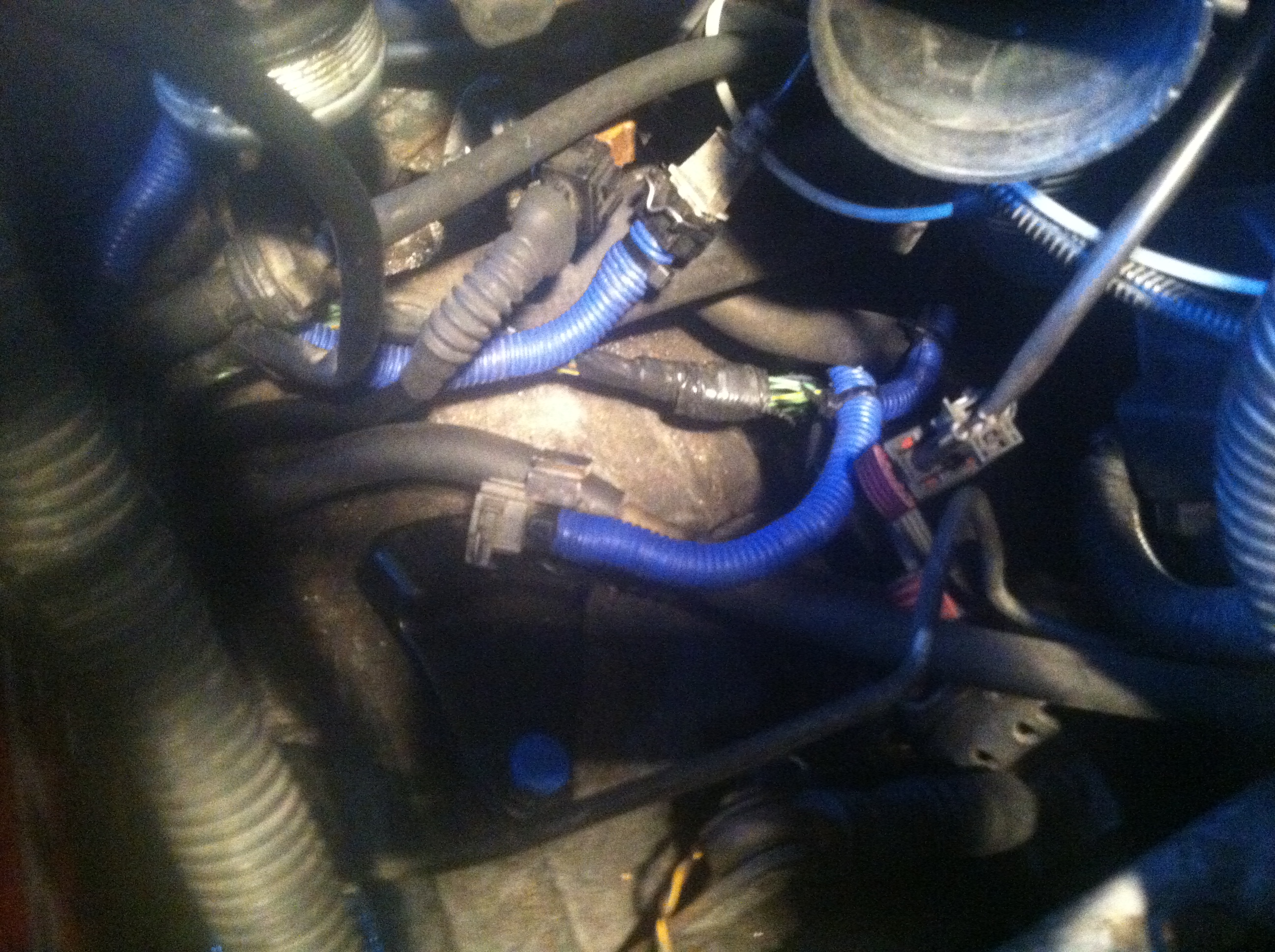

I lopped off the big connector which attaches to the auto transmission and connected the two green wires to bypass the neutral position interlock junk. I've yet to wire up the blue wires to the reverse light switch but are there any other wires in that bundle that need to be addressed?

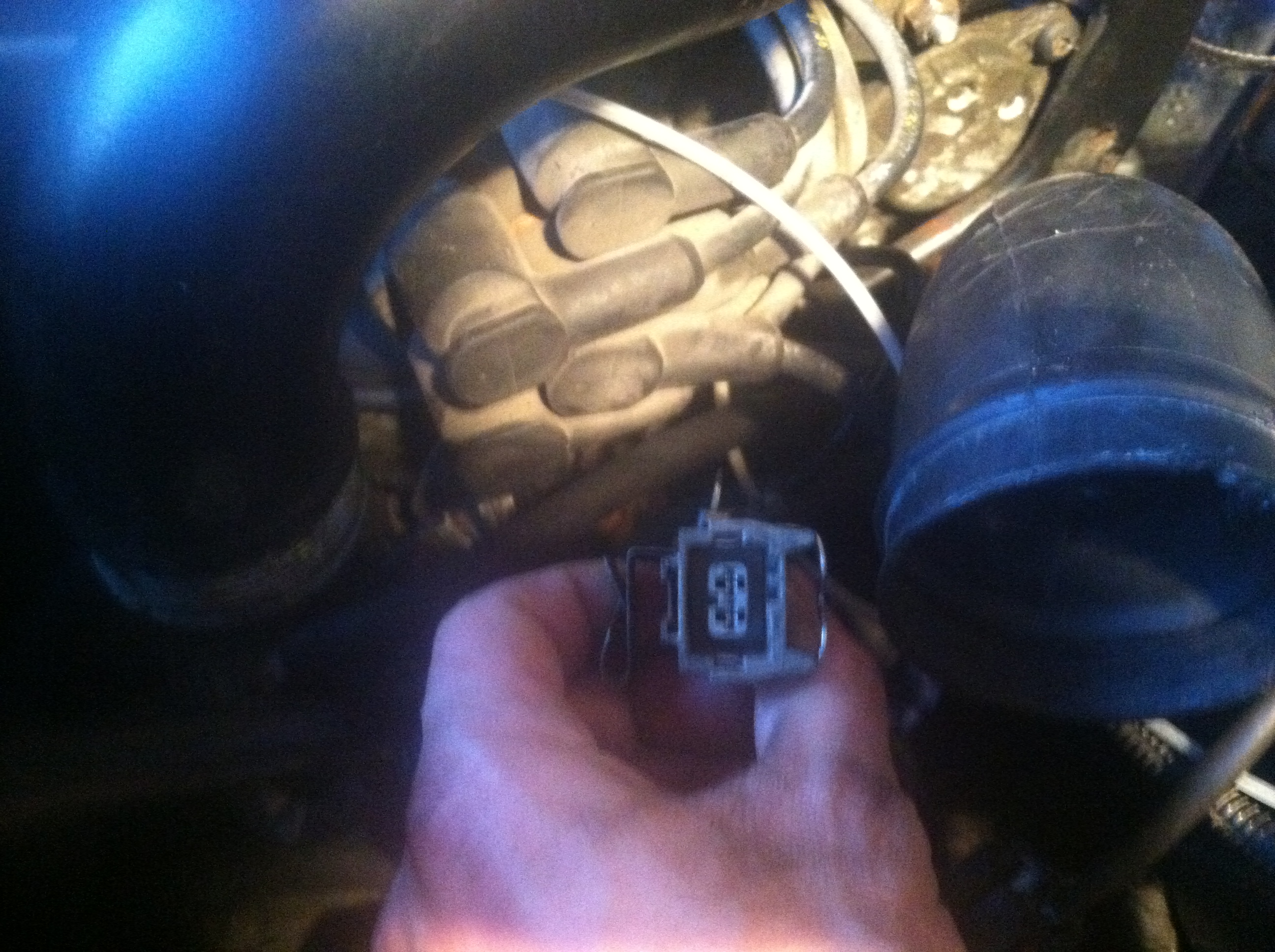

My concern is I have two electrical connectors that I cannot find the other side for, one being a grey two prong female coming out from the wiring harness at the same place as the two 02 sensor connectors. It is has the same asymmetrical locating slots as the coolant level sensor and the plug which goes into the alarm connected to the firewall.

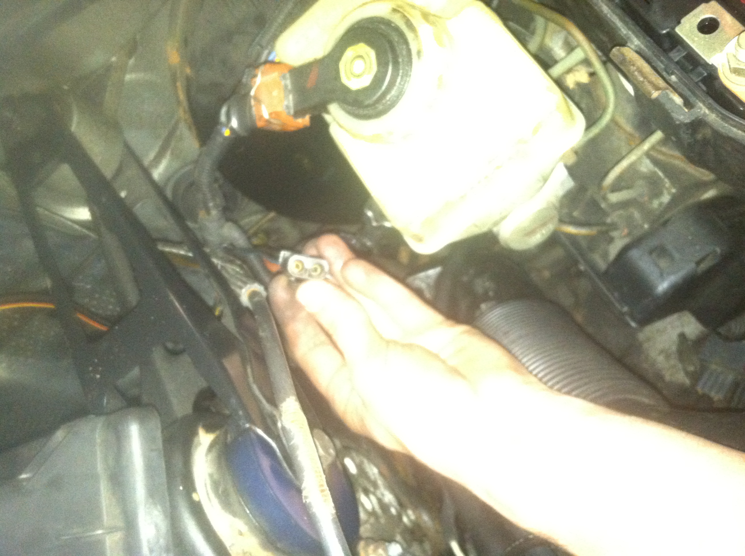

The other connector is a two prong bullet type which comes out of the harness just to the passenger side of the brake master cylinder.
The manual transmission wiring harness has neither of these two connectors, and I cannot remember where they go! I feel they need to be short circuited or something but if anyone has some first hand experience it'd be greatly appreciated!
