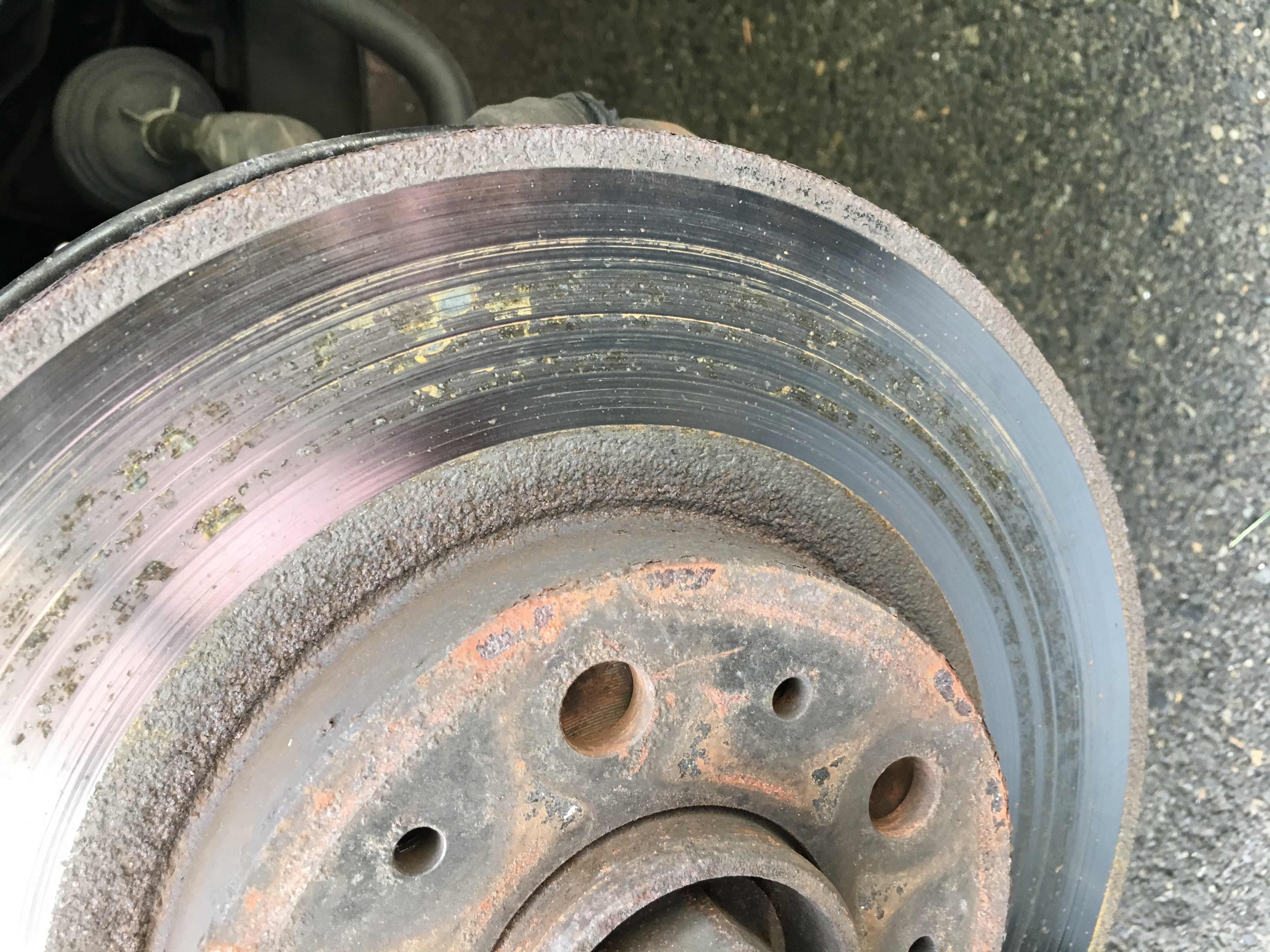

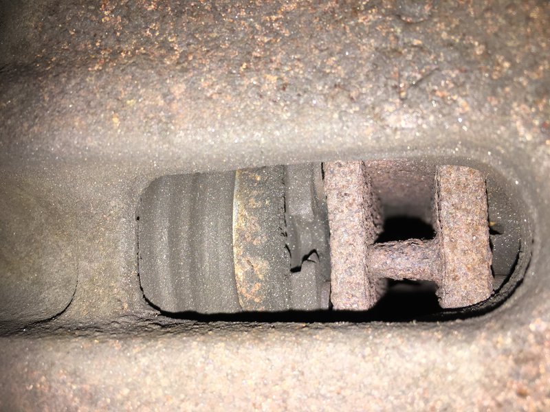

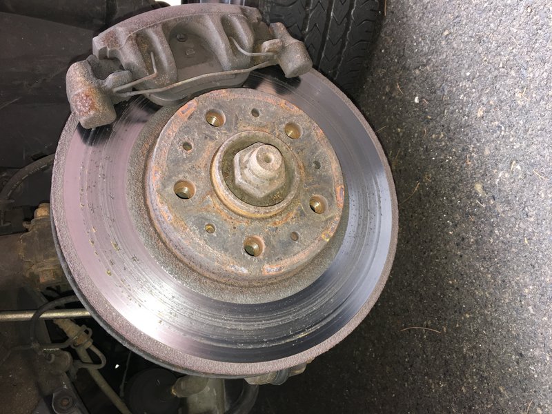

Thanks I took my front wheels off yesterday to inspect and it's not a pretty site.
The outer pads have lots of meat on them, say 1/4" or so, but the inner pads look like they are almost worn to the metal. I'm getting lots of squeaky noise when braking and the rotors are very crusty, rust and scored.
Oddly, the car stops fine, brake pedal feels solid and there is no vibration or shaking while applying the brakes. I'm worried the calipers travel pins might be seized up or something. They obviously are working, but don't seem to be working right.

How long have you owned the car? Looks like a previous owner might have ground down to bare metal, then just thrown a pair of cheap pads on the car to get it sold.
How long do you plan to own the car, and what are you going to do with it? I ask, because if all you're going to do is putz around town you might want to just throw on a new set of lifetime pads and figure on changing them out every 5k-10k miles.
Also, once the calipers are removed, you should easily be able to determine if the slide pins are sticking at all.
I think it really depends on how much money you want to spend. New rotors will run about $50 each, which is about what new calipers will run. Figure on $30 for a new set of pads.

I've owned the car for exactly one year, but it was strictly a second car until 2 months ago, when I sold my OTHER beater...
Anyway, I only commute less than 10 miles a day round trip, and I barely go over 40 mph. So, I'm in the process of figuring out how long I want to keep the Volvo, and I've come to the conclusion that if I can get another 6 months to a year out of it, I will be happy.
So, I can tell that the rotors look shot, and as I said the pad wear is not even (1/8" left on inside 1/4" left on the outside), so I'm thinking bare min. of new front rotors and pads. Hoping I won't need new calipers.
I am currently looking at a few other better condition 98 wagons with much better overall appearance, less miles and better maintained. If I end up getting another 98, I will prob. put this one on withdrawn from use on my insurance, park it in my parking lot and use it as a living parts car for the other one. But in mean time, I need this thing to stop screeching every time I use the brakes!
