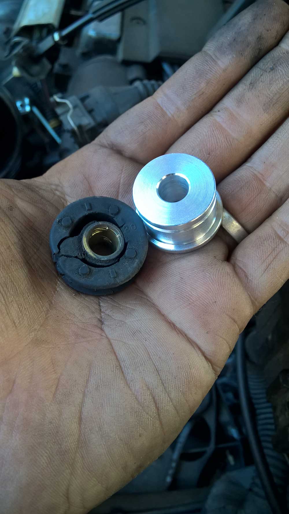

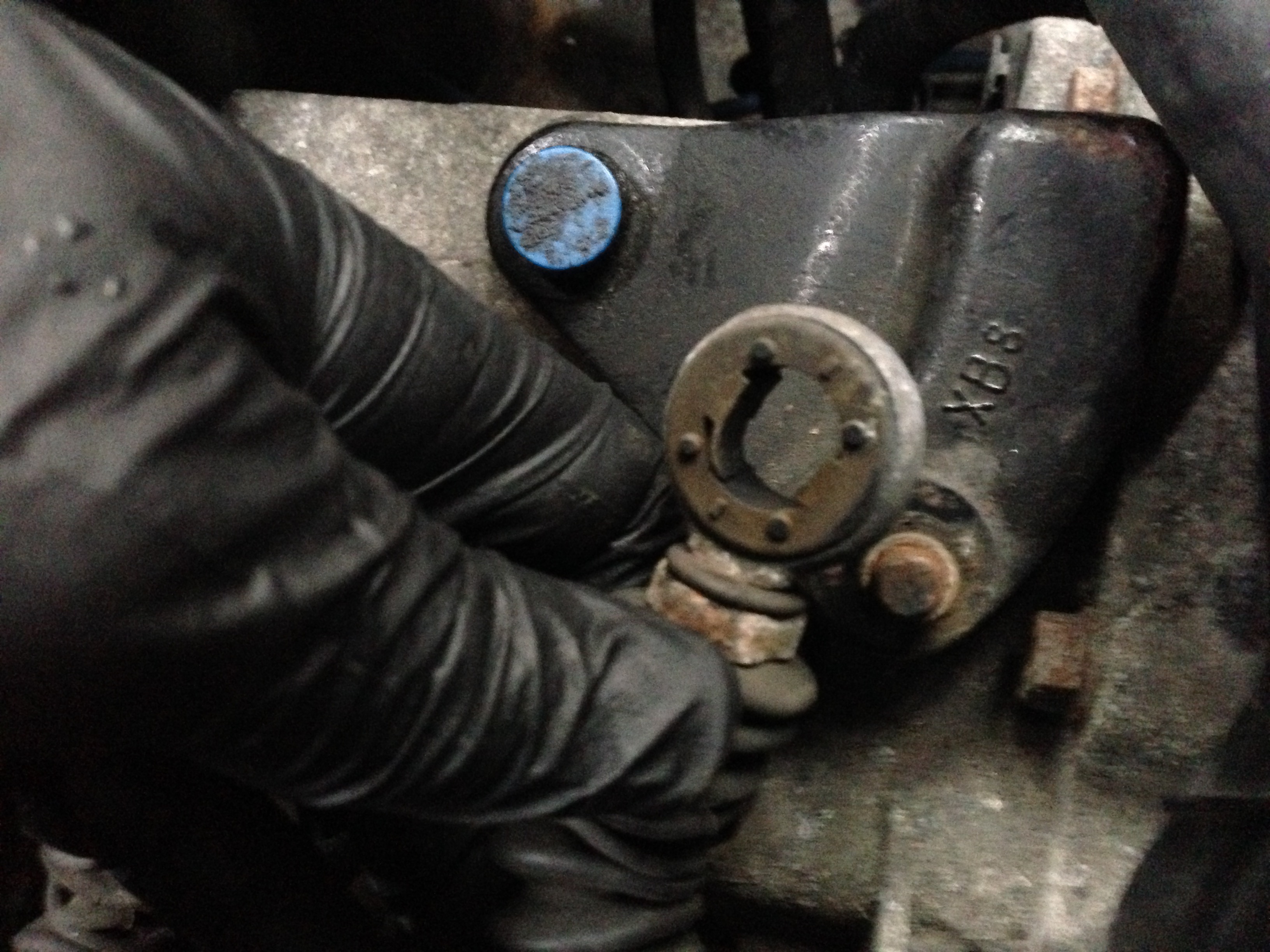

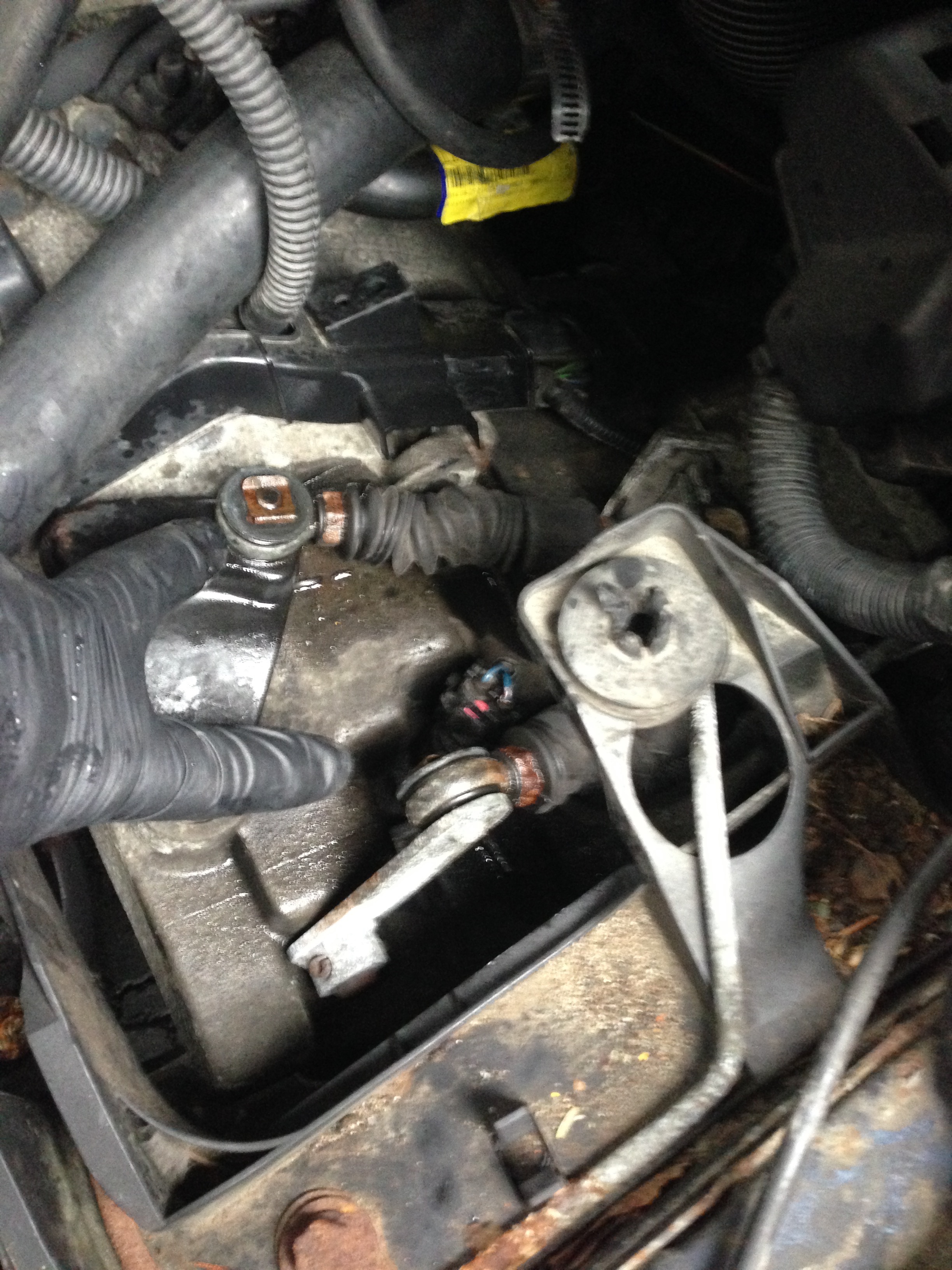

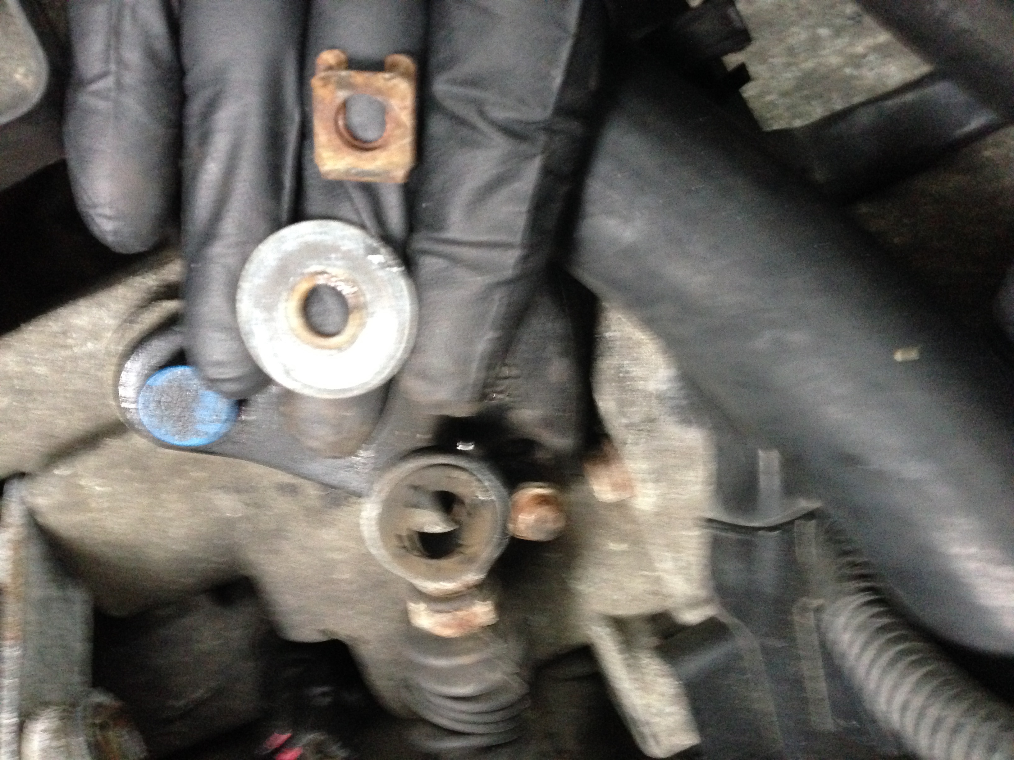

I picked up these stainless steel shifter bushings on eBay for $11 shipped. http://www.ebay.com/itm/VOLVO-ALUMINUM- ... D100102%26 It was as simple as carefully removing the airfilter box and accessing the bushings.
The brass ones cost $3 more so I decided to go the cheaper route... The OEM ones were all loosey goosey and broken so I'm sure this will be better in the long run. Have many people tried these things out? Do they make that much of a difference? I haven't gotten a chance to try them out just yet. So I can't report on how they feel. They do look nice though!

It's significantly tighter and more accurate. I'm glad I did it. It wouldn't hurt to check it out. When I removed the clip holding them in, I noticed that the metal sleeve had torn from the bushing and you could see how something like this could affect shifting.

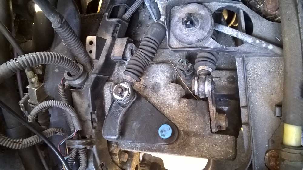

Holy crap!!! I just gave them a shot of silicone spray and my car shifts with a finger now!! My bushings are badly elongated (TMI - too personal) so Ill look for new ones. Anyone with VIDA who can feed me the part number, appreciated..

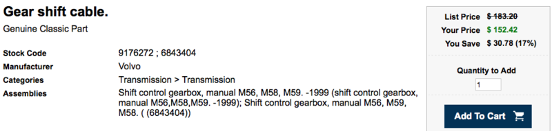

Well,it gets better.
My listing shows you can't even buy the wear bushings, you have to buy the genuine Volvo shift cable at $150 ..

Ill add a pic to show how nasty mine are.
