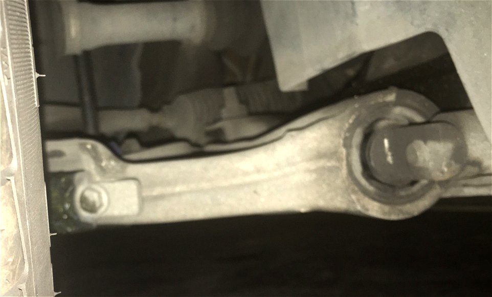

So, I'm going to load up some pictures of my wife's '04 V70 with 167K miles on it...it rides smoothly and nothing seems out of the ordinary. It has fairly new front struts, with all new IPD spring seats and end links in front and new shocks and end links in the back. All shocks/struts are Sachs/Boge (blue label) and about a month ago I installed the poly bushing tightening pieces in her sub-frame bushings. Tires wear evenly too, but our roads are pretty decent here in TN.
Here is one of her front (passenger side) control arm with the front facing bushing...
This is a close up of the bushing
Personally, I think it looks pretty decent for the age of the car. I don't think it needs replacing...yet.

Where the wheels at full lock? The one on wife's car seems not in that bad of a shape. Maybe PO had already replaced them in the past? Mine looked worst and when I removed it from there it wasn't actually that bad inside.

Front beefier ones do impact the handling quite a bit, if the rear one hasn't yet cracks on it, I'd swap only the front one. The car will handle better and be somehow safer on open road and this bushing also takes all the load in an emergency braking. I think the front one is not a full bushing, has like too 'tabs' of rubber. But if hard to say how damaged they are while still in the CA. I also remember before replacing mines, if I'd park the car on an incline, next morning the steering wheel would pull to one side for a while.
Interesting to find out they've lasted 160k miles, perhaps the way the car is driven has something to do with this.

Yes, my wife babies her car- just recently did we replace front and rear struts/shocks and added the poly inserts into the subframe bushings. I've done very little to this car. Just 2 days ago I changed out the rear rotors for the first time!!oragex wrote:
