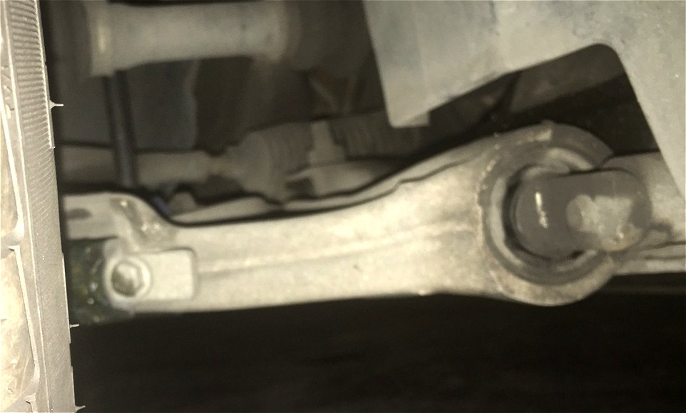

Here is one of her front (passenger side) control arm with the front facing bushing…

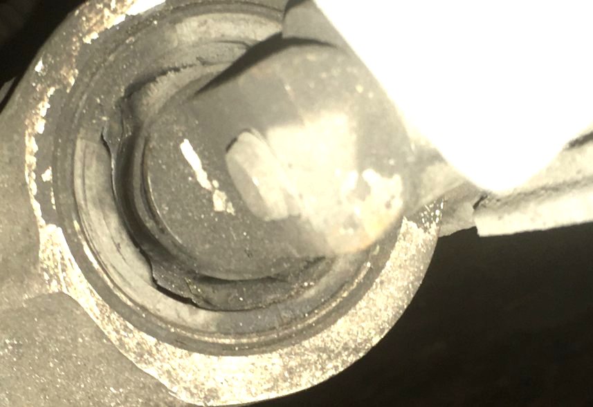

This is a close up of the bushing
Personally, I think it looks pretty decent for the age of the car. I don’t think it needs replacing…yet.
So my son came over today and I did some maintenance work on his car. While under It, I saw his bushings and they were torn on the left and right sides (up and down) on each of his front bushing (passenger and drive’s side) as I could see light through them…the top was attached but still the bushing was torn, or it seemed. Maybe that’s okay… as long as the top and bottom are attached? His is a ’07 2.5T – really the same car as my wife’s V70 except for in the sedan format so I don’t think that his bushing would be any different, or are they? His car has about 112K miles on it now while hers has 167K (65K more) miles so that’s another odd thing regarding why one seems torn and the other is not. If you ask me which drives better, his does. There are no suspension issues, nor is there any strange tire wear. I do not know the history of his car’s suspension work- I assume it’s all stock from the factory. But none-the-less, his car is a pleasure to drive!
After all of this, my question is, should I work with him to replace that front bushing, or is it better to just replace the control arm altogether? Or is this unnecessary? I’m thinking we still have some time but if the rubber bushing is already torn, it’s a matter of time before it deteriorates or causes other bushings to wear out too, or am I wrong here? For those who have been through this, is it typically for just that one bushing to go or does the rear one on the control arm also go? With that answered, should I replace the arm, should I also be looking at replacing the ball joint, or can I resuse it if it’s still good? All of this can add up to some $$’s, right? I’m inclined to just go after the front bushing in his control arm if the other components still have life but need to know if that’s practical or not.

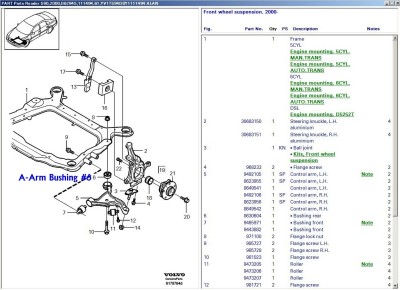

New Volvo bushings part # 9443882
From another listing I purchased ‘original’ Volvo front one for S60, and ‘original’ Volvo rear one for XC90. While the front one has kept up well, the XC90 one is not a full bushing and the steering is not tight enough.
