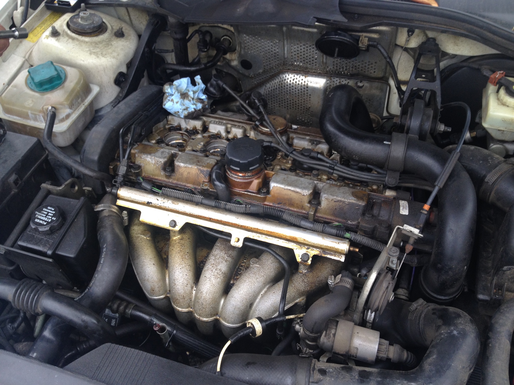

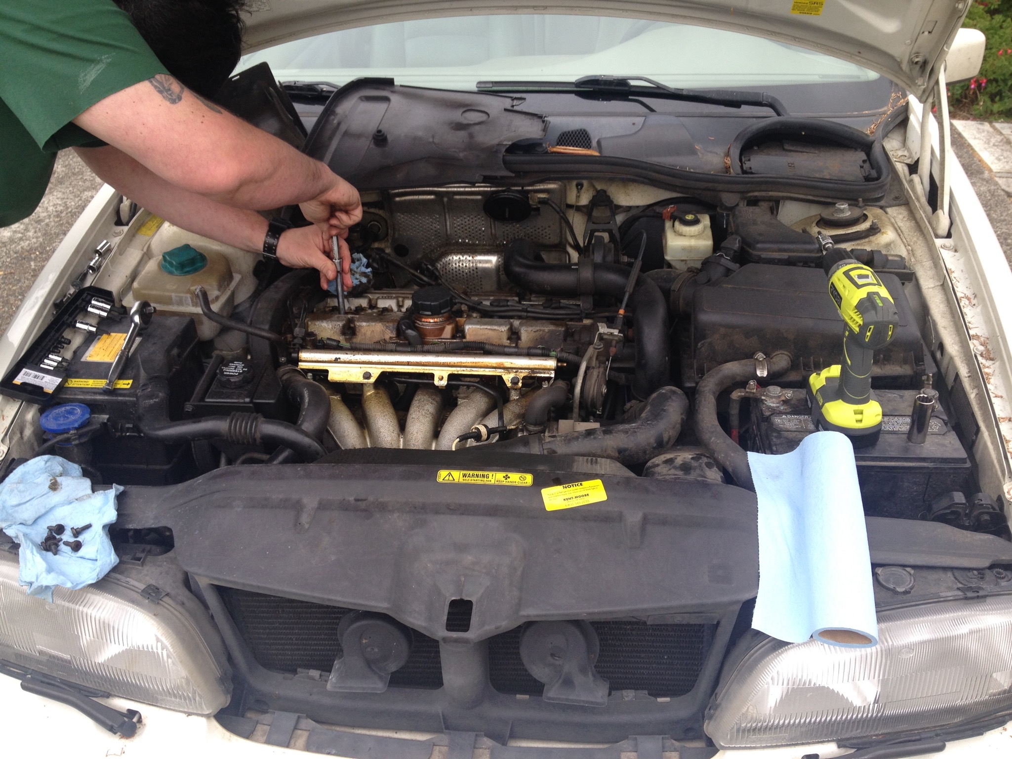

Well I pulled the timing cover and its tight and 20k old. Charged up the battery and with juice crank it a couple of times. Checked fuel at the rail and its there. I pulled the spark plugs....horrible! Both cord and plugs. As I was pulling number 3 I noticed moisture on it. I looked back at the other two and saw that number 2 had some on there as well. I happened to look into the well and I noticed there was some shinyness. The dip stick oil looks more tannish not black that I thought it's would be.
I threw a set of new plugs in to see if it would start but nothing. I repulled the number 3 to do a compression test and noticed moisture in the new plug. I pulled all plugs blew and dried them off.
Is this a headgasket issue? Is the engine toast?

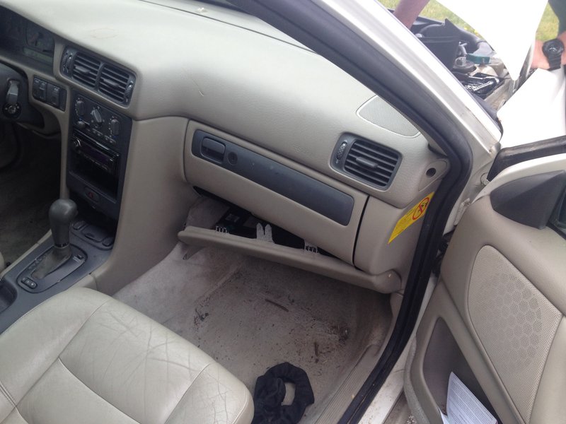

Can you tell what the moisture on the plugs is? Fuel? Coolant? If it's fuel, you may simply have it flooded. That could possibly be due to a failed ECT and/or thermostat which could be causing the engine to think it is too cold and over enriching the mixture for starting. For kicks, get the plugs dried off and with a fully charged, healthy battery crank on it for a bit with the gas pedal to the floor. If it starts, change the ECT and thermostat.
Body and interior look to be in pretty good shape. Probably worth poking around a bit more to try and figure out what gives.
