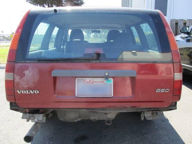

My trusty 1995 850 wagon (base) was recently rear-ended, hard, while stopped in traffic. It did its job spectacularly, and the bumper absorbed most of the impact. I was fine, my wife suffered a very minor concussion, and a CHP officer witnessed the accident, while he was tending to another, more minor crash 50 ft behind us. (thank god). We were far from home, so AAA recommended we remove the bumper, toss it into the trunk, and drive back home. Fresno to Oakland. Wasn't fun driving without a rear bumper on the freeway but we made it.
Anyway, I finally got the repairs appraisal. Once I hear back from insurance, I'm going to get a second opinion from my local mechanic, but I was hoping you guys might be able to educate me a little about what the damage means. (Please forgive any naivete, this is my first car and I'm still learning about it, with only heater core and timing belt replacements under my belt so far). The car is worth ~$2500 and it is very well maintained. Got it from a close friend and would rather not have to find another one. The repairs appraisal was for $4250, so it's going to be declared a total loss any day now. Over $3000 of those repairs are for replacing three parts of the rear of the wagon, even though the trunk still locks and the car apparently still drives fine.
I'm wondering whether the following two parts are technically part of the car's "frame" as opposed to "body." (Or correct my interpretation of those words if I'm way off). I'd be fine with some superficial damage to the car, but don't want to drive an unsafe vehicle. I suspect the right frame rail is most important for the car's structure, but I question how severely it is damaged...

Could these parts be deemed "in need of replacement" even if they are still fully functional? Replacing them professionally would cost ~$1000 each, for parts and labor. (The floor pan is also dented up pretty good, but I think I'm safe in assuming it is not vital for a safe vehicle).
I've also attached the photos the appraiser took. The back of the car looks like it's in good shape, though I know looks can be deceiving. Getting a salvaged vehicle approved for the road in California doesn't seem very hard.

850 is an unibody, the entire body is its frame. The body is bent and compromised, when the next impact happen, it will not protect you as well as it did.
I don't recommend fixing it.

Amazing how what looks like a minor hit can total a car. That is the result of a lot of engineering. The framerails are like the spine of your car. If they are damaged, the whole car is. Unfortunately, it is not cost-effective to repair it. Sorry for your loss, but now you know why people drive Volvos! If the insurance company gives you the value of the car, find another one, the best you can find for the money, and keep driving safely. Or use it as a down payment to move up. It's sad to see cars go to the junkyard, but if you spend any time here at MVS, you'll know the parts from your car will keep a few more on the road a while longer.

The 2 rails the bumper are mounted to are part of the chassis, and I'd be surprised if you crawl under the rear and look at them they are no crumpled or deformed. They are designed to absorb the impact but unfortunately at this age are not financially viable to repair.
