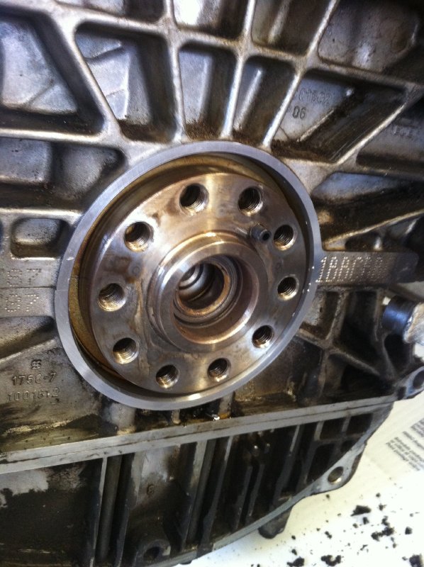

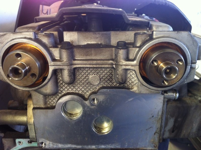

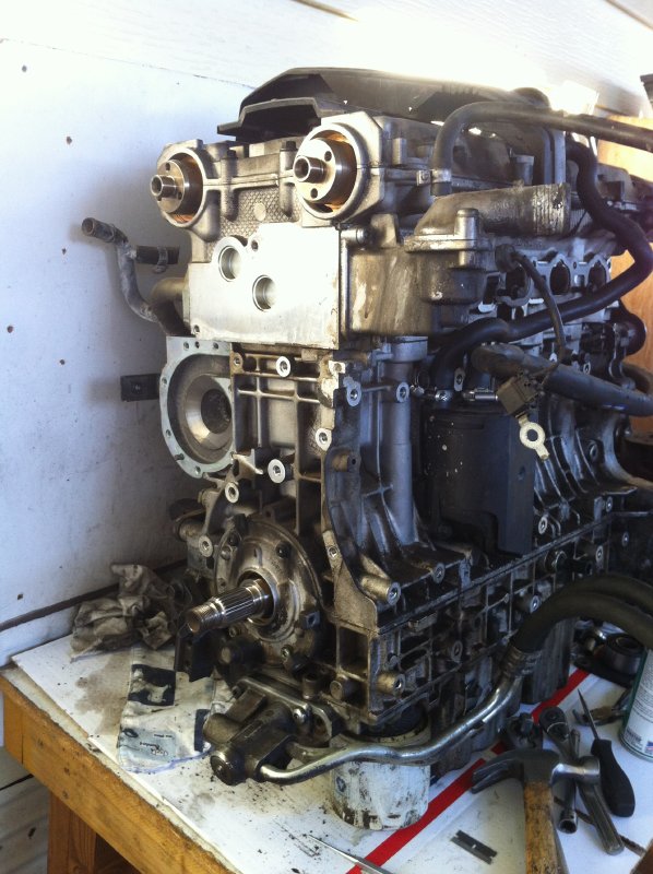

I removed the seal with a small screw driver and a insert it with a flat end punch. No leaks. I did not pull any housing.
I did have the engine out since I was replacing the clutch as well.

Nice photos TryingBe. First time I've ever seen a clear view of the front of a WB motor with no TB enclosure. I now understand why front cam-seal leaks tend to run fore/aft, yet another "shelf".
What a very TALL, thin motor.....
