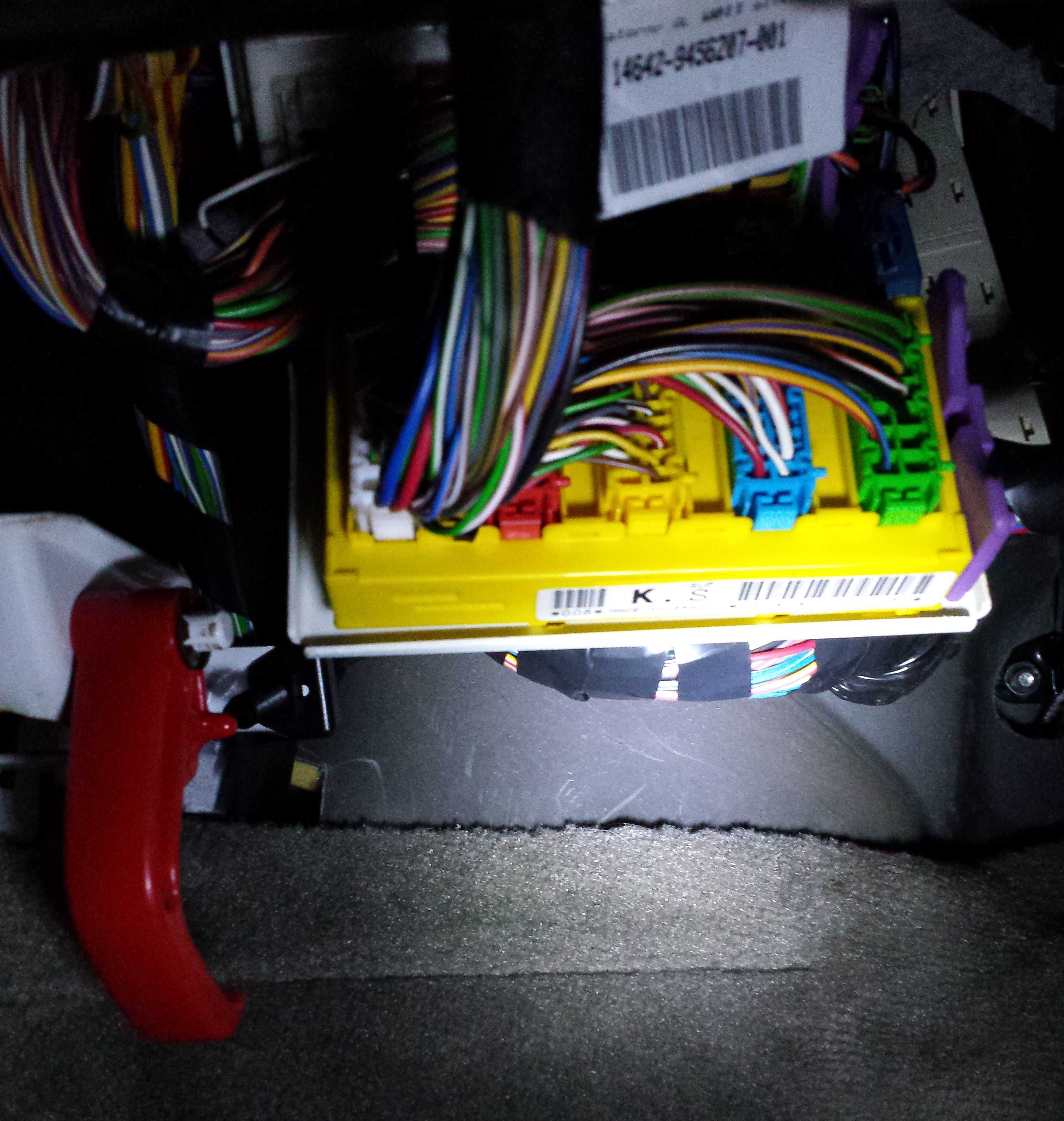

See attached photo.
There is a yellow master electrical connector block located behind the driver-side under-dash kick panel, just to the right of the red hood release lever.
You need to remove the kick panel to access it (secured by one Torx screw under the steering wheel, then slides out.).
Five smaller electrical connector blocks attach the yellow master block, From left to right they are color coded white, red, yellow, blue and green.
In my case the white connector on the left side was not fully seated. Just clicked it in and all fixed.
Big thanks to BEJinFbk for pointing me in the right direction!
