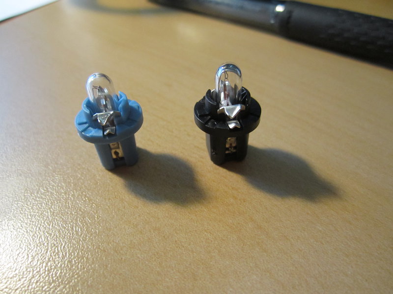

Does anyone know the bulb spec for these bulbs? Is there anywhere like mouser to buy these in bulk?

eEuro has the bulbs for the idiot lights for not bad: http://www.eeuroparts.com/Parts/9781/Li ... 2W-419101/
Curious to know if they can still be had in bulk. I know Lee used to buy them in 12 packs but that link is broken.

The bulbs in the cluster have BLUE bases as opposed to the BLACK bases of the one on the link. They are both listed as different part numbers by Volvo, but both are 1.2W/12V bulbs. FCP has them listed under a different part number and when checked does not include 850 as using it, but when you look up 850 it gives it as an option. Price is cheaper than eEuroparts too assuming it is the same part:
https://www.fcpeuro.com/products/instru ... ulb-2721mf
Volvo has these under 3 different part #'s on Vida, but to me they look like the same part. Part #'s: 989800/989805/989806
989800 : shown as fitting the computer LED read out with MPG/etc...., but also used in the front overhead lights. Vida though also shows it in that part number as a push in bulb without the base? Who knows....!!!?? It also lists it as a push in bulb on a Yazaki warning bulb in that cluster.
989805: shown as fitting the warning lights
989806: shown as fitting in the LED readout for LED's with Clock/temp only
Very confusing if the only difference in an 5/6 bulb is possibly only the base color!

Call your local auto parts store, they might have them in bulk and for cheap. The store I used to work at (advance auto parts) we had bulk headlights more for the local shops that had accounts set up with is but I remember specifically because I bought probably 10 bulbs for less than $15 (a friend had the same bulbs so I just bought a bunch for cheap so we had extras just incase.) I can't remember specifically if we had mini bulbs in bulk, but it wouldn't hurt to make a quick call and ask.

989800 is the one people use 194's for. It is a standard push-in type. Not the same as the others.
The LCD clock and the warning lights, I just swap the blue and black ones all around, don't pay attention to any difference. And only buy one type when I buy new ones. That's a good price at FCP.
There will be a few spare blue base bulbs, and 4 spare of the push-in ones, in that spare cluster. But I understand you may want to go with new ones.

Thanks for the link. I pulled a spare kph cluster from PnP and it has a full set of bulbs, so hopefully amongst them all I'll find a good set!
