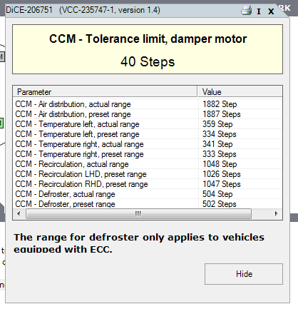

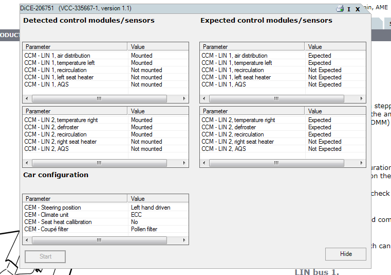

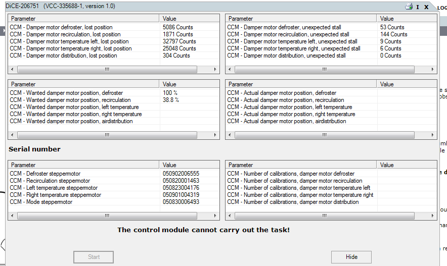

here what VIDA says in the attached pictures. What are those readings mean?
the first image obviously states that i have those DMMs mounted - so it does recognize them.
the second one shows steps - I guess.
And the third is where the CCM is not able to finish the job and shows some information that i have to look into. Where to look?
