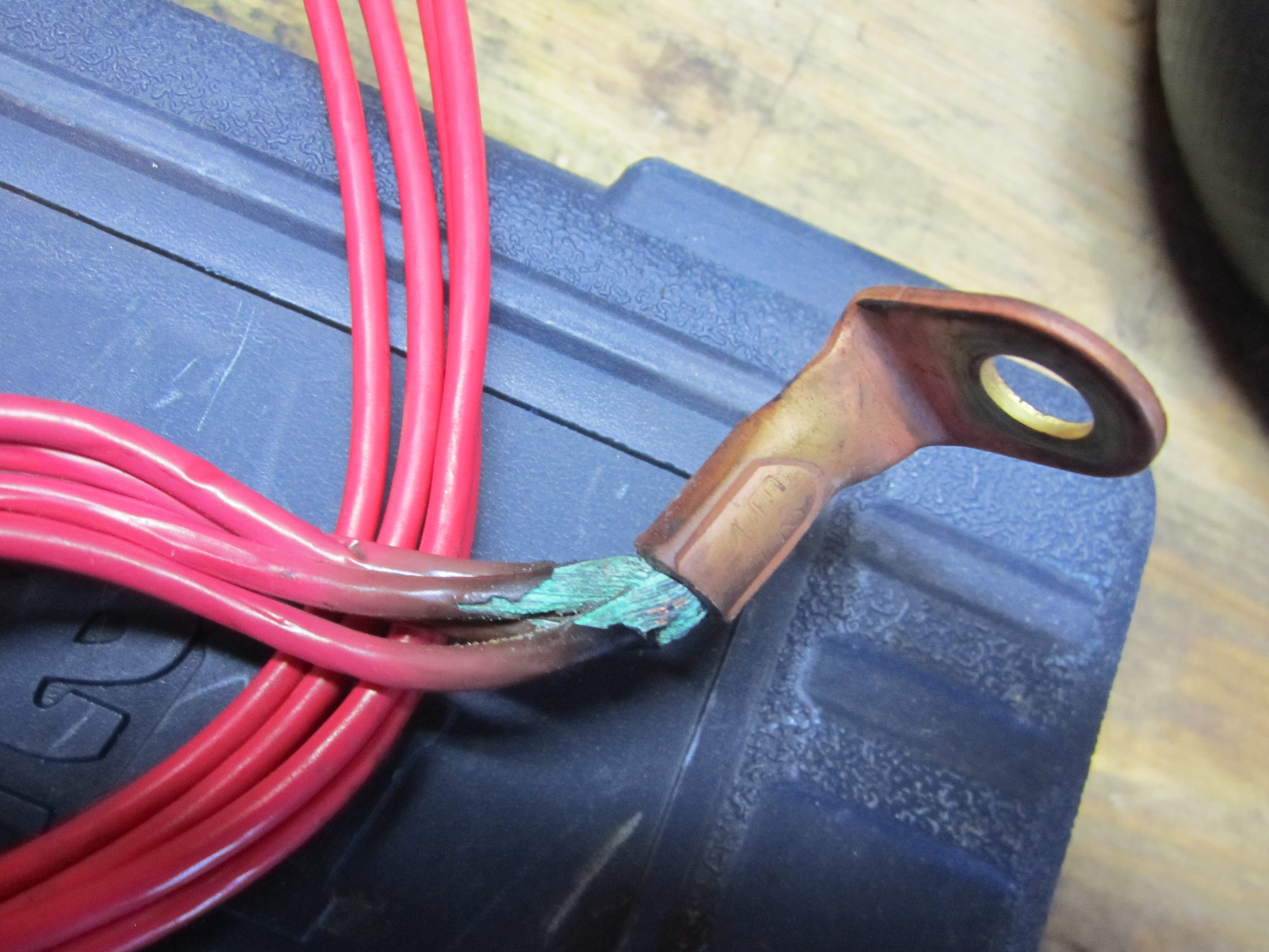

Don't forget the B+ battery cable usually is bad by now (battery will never get a full charge and will drain), so if that has not been replaced, test it. If bad replace it ASAP along with the Positive cable.

OP says the B+ cable looks good. Typically if it is going bad you see the nut holding it in place at the main fuse box (the kidney shaped one near the brake master cylinder) when you open it up and look at the nut will look discoloured, but not always. Mine was a little discoloured but when I removed it, it was almost completed melted just below where you can't see it).
There is an earthing point right by this and worst case can cause a short and fire. So you may want to undo it and check at least. JRL is a wise man and has worked on these cars for a long time so please check. This can also be the cause in high humidity damp as to why you are getting issues.
Another issue to look put for is corrosion in the fuse box on the LH side of the car by the LH windshield wiper arm. These can get problems in particular if the drain holes in this area get blocked and it allows water to back up in there. Make sure all the 4 drains are clear.
Ignition switch can also be failing. All my P80 Volvos have had an issue at his age and mileage. When damp weather is out there you have more current draw which will affect a worn ignition switch.
As for the headlight wiper. It has a load resistor in it to prevent overload breaking it in icy/snowy conditions. It looks like a small flat metal square. As it ages it breaks down so any load causes the motor to freeze. On a P80 it is a pain to access and replace. Just remove the arm, tie a knot in the rubber water pipe and live without it.
