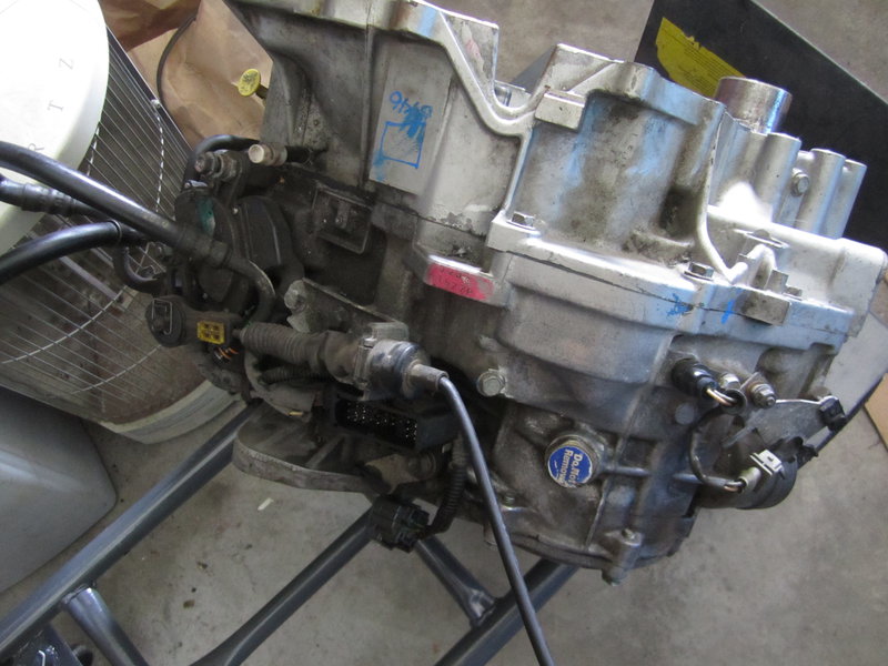

Thanks jimmy57. I remembered I had photos of the spare transmission I took some time ago, and sure enough there in one of the pictures you can see the dipstick. Where/how do you fill this trans with oil? Through the dipstick as in the 4 speed?
Thanks for the help.

Yes, through the dipstick. Getting the levels right isn't much fun on that 5 speed...

I think the level must be read on a really warmed up transmission at 80C. Slightest variation in temp causes a large change on the dipstick. There's also a cold mark I've heard mechanics use on a customers car with cold engine so they can check there's minimum oil to start the car, but it still must be checked at full warm idling and very level.

You are right on that. On the turbo engine you need Teflon hands to reach the dip-stick where it is hidden. I now have a 2000 V70 NA with the 5 speed auto and it is relatively easy to access as there is none of the intercooler or intake pipework in the way.
