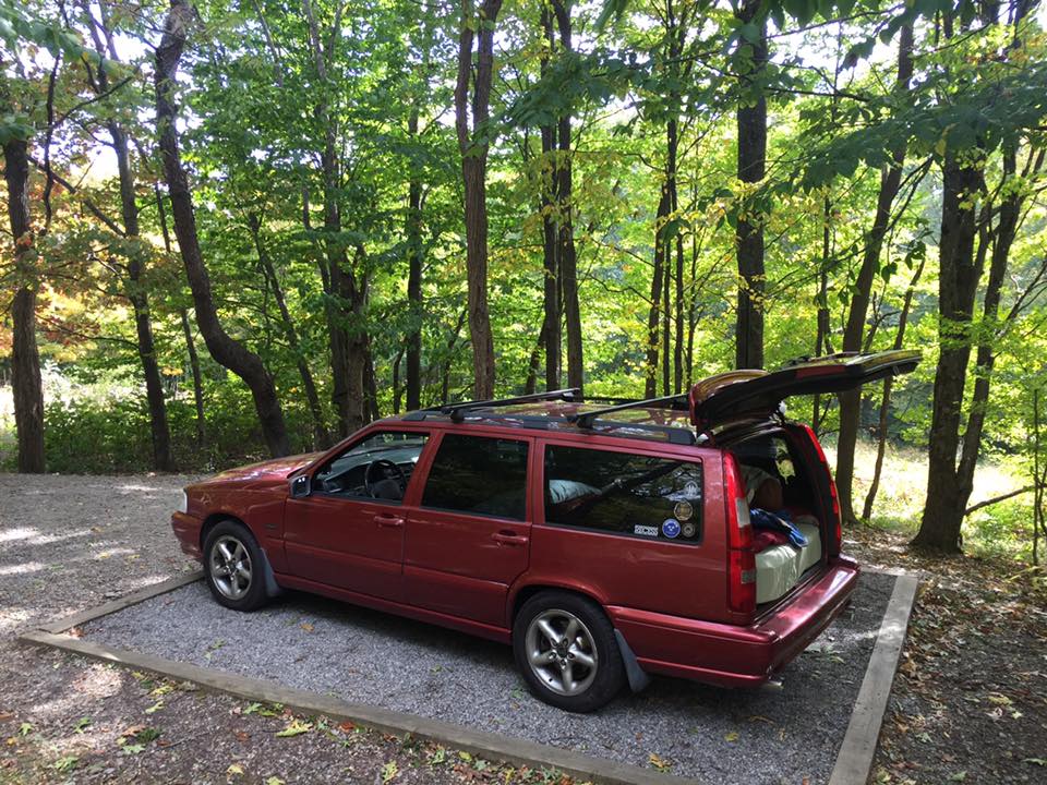

Hey all!
We took the new to me '98 V70 AWD with 133k camping this weekend. It did great until it didn't- I think the angle gear or CSB may have failed. Before I go yanking the driveshaft, I want to know some opinions as I would like to keep this car AWD.
So, the car makes a very metallic grinding noise when I am not accelerating or turning right. Left turns make it worse.
I put new brakes on all 4 corners a couple weeks ago and noticed DS outer CV boot was torn all the way around and will be replacing that axle soon- but could the axle be the noise?
Can I replace the CSB myself if that is the problem?
The kicker is, the AWD still seems to work. When we got it home, I took it up a muddy hill. Rear wheels engaged properly and made it up just fine. e
I have little experience with the pre-haldex AWD, so any advice is much appreciated :)
