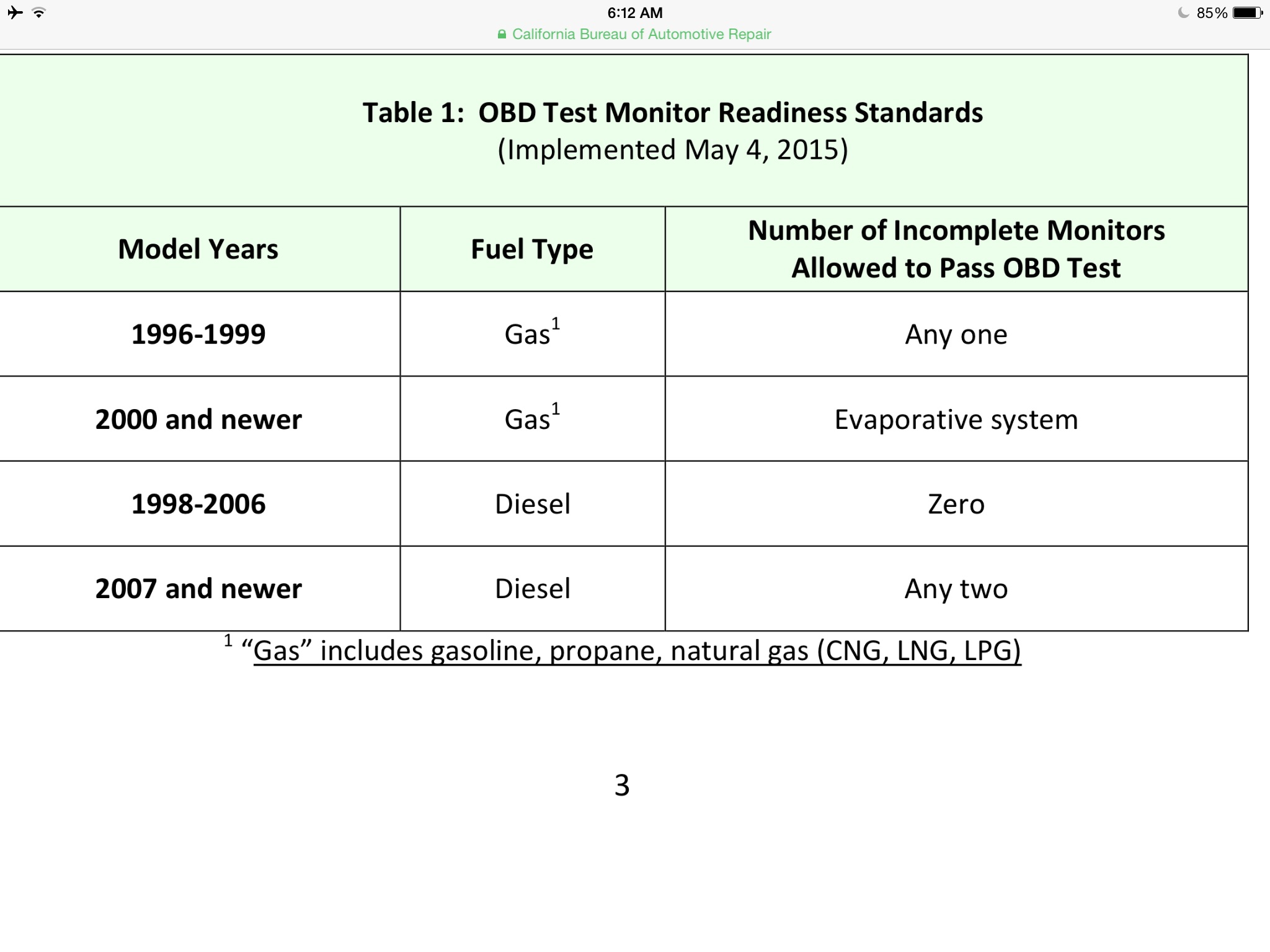

Summary...document courtesy of dynblyn
California ONLY! Most other states follow the EPA rule of 2 for 1999 earlier, one for 2000 newer.
CA rule:
1999 earlier ...one monitor not ready allowed
2000 later...only evap monitor not ready allowed
Thus actually helps with those annoying P0455 s!
p2 P80 2015 emission readiness rules for CA
California Relaxes OBD-II Smog Test Readiness Requirements

Are you 100% sure about this?
- Posts: 36142
Unless I am a victim of a scandalous obfuscation scheme from dynblyn, the source material is from the California Bureau of Auto Repair.
The change was dated SEP 2015, and the document release was last month.
Dan followed up in his post that on page 48, pre 2000 model years inspections ignore readiness sensors completely, btw.

No subterfuge. Was directed to this PDF when I called CARB earlier yesterday to validate the number of sensor readiness question in another thread.
https://www.bar.ca.gov/pdf/Smog_Check_O ... _Guide.pdf

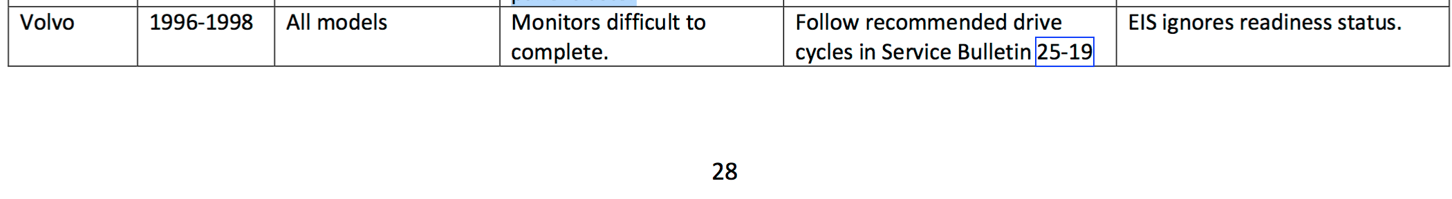

Yeah, that was a solid, primary reference source post. We need more of you on the internet and less MUSE....made up stuff excrement......
Heres that million dollar sentence for 1996-1998 models

Just got 98 s70 non turbo inspected, passed NY state inspection with 6 not ready.
Car is known OBD ready issues so they allow it to go!
