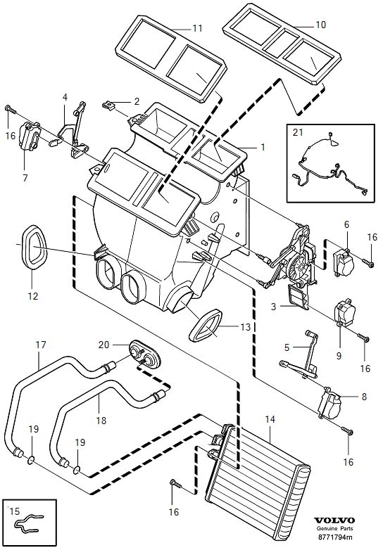

The vent flaps inside the climate control unit are prone to fail. Either a small plastic arm is broken, or the flap motor is burnt.
Here's a scheme, you can check by removing a few plastic trims what moves and what isn't moving

Ok thanks for the info. What's the best way to access that stuff? Pull the glove box?

right side yes, left side just pull the trims

Revisiting this thread. I am not sure if I am chasing a ghost or if there is an actual problem.
Last weekend I removed the glove box and had a look at all the flap mechanisms. I also replaced the blower motor. From what I could see everything is operating correctly. Defrost, vent and floor settings work as they should. However, the amount of air coming out and the temperature doesn't feel very hot. With temperature set to 80 degrees it's warm, but not hot. In my Crown Vic the air blowing out was so hot I couldn't hold my hand on the vents for very long. Here, I have to hold my hands near the vents just to keep warm.
I have no other car to compare to what I am experiencing is normal. How hot should the air get on maximum heat and how hard should it be blowing? When I have the climate control set to vent only it does blow decent. It's not enough to blow your face off but it's ok. Once I switch it to go to multiple directions it drops right down.
This morning it was about -7 degrees Celsius outside and my windshield had a bit of ice on it. I had heat set to max and defrost activated. I could not get the windshield hot enough to melt the ice. To me this doesn't seem normal.
One thing I did notice which annoys the hell out of me is a weird faint buzzing sound coming from behind the glove box area. I tracked it down to having something to do with air re-circulation. When re-circulation is off the noise disappears. In manual or automatic with fan set over 50% I hear this noise. It seems to only occur when I am driving though. If parked I can't replicate it so can't figure out where it's coming from.
Is there a flap that controls how much air is pushed through the system in general or is that all done via the speed of the blower motor? Basically I need to determine whether all of the air that the blower motor pushes actually goes through or if it gets bottle necked somewhere.
