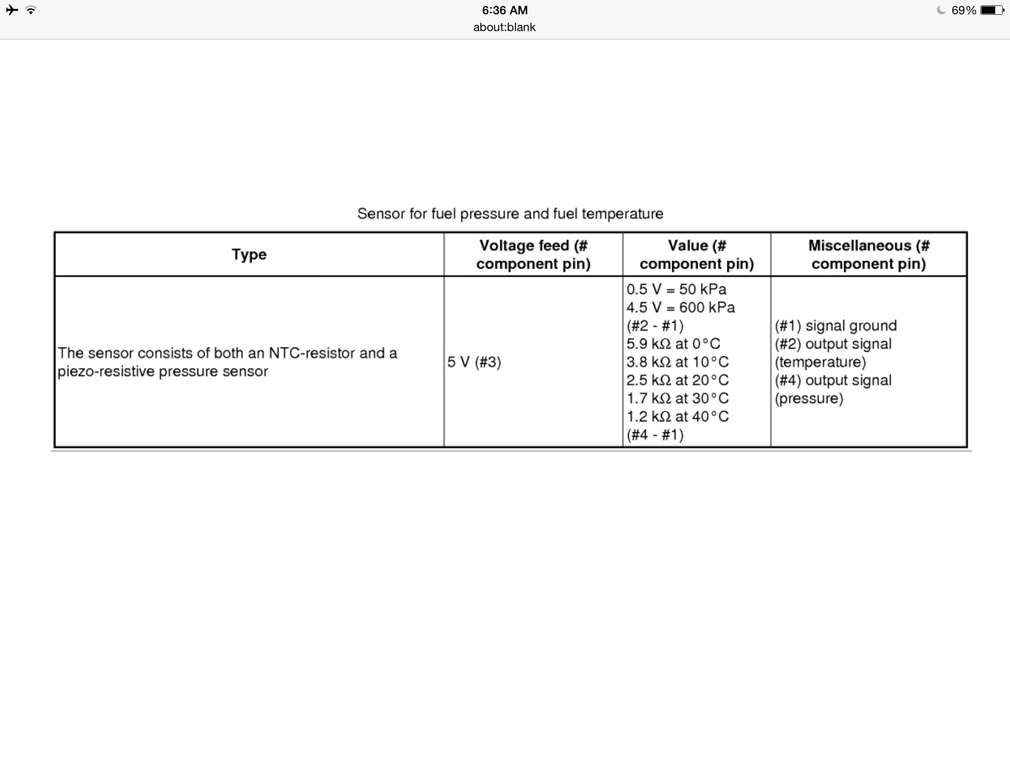

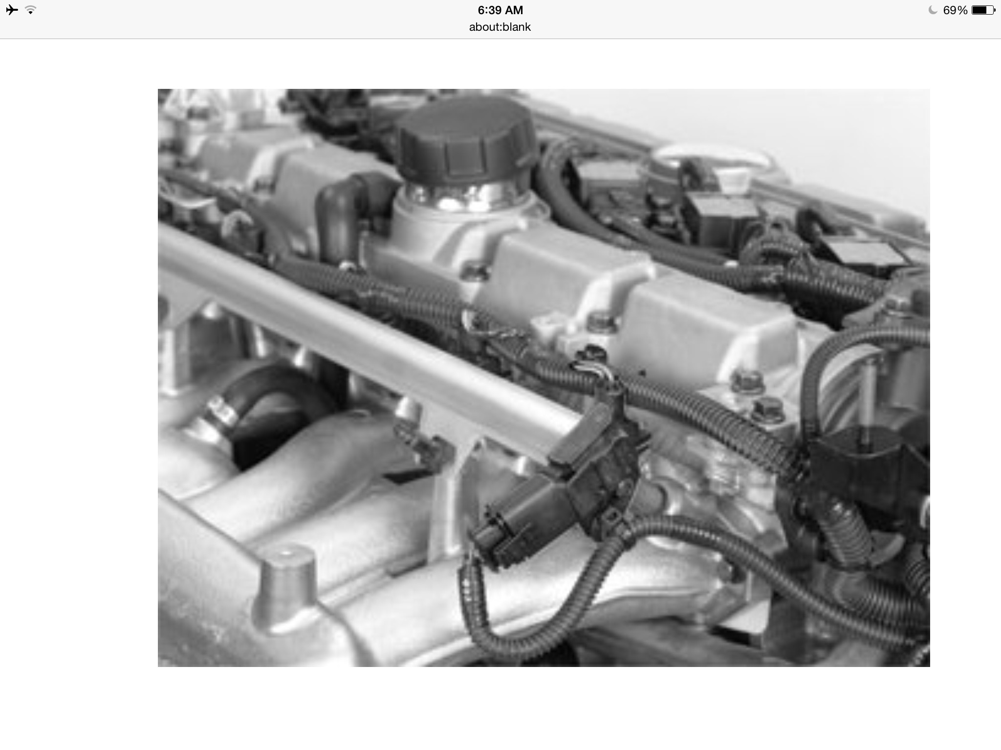

Sorry I didn't answer your question. The sensor lives on the rear end of the fuel rail, driver side.
Here are pics and specs for my 2005...I think it's the same in all P2s.

thanks for the picture. Could there be another place that it is located? My S60 does not have it on the end of fuel rail. I only have the Schrader valve on the end.

Ugh. 2002 non turbo ( or Naturally Aspirated, NA) uses the Classy Italian throttle body made by MM. This has the earlier fuel pressure regulator not the one on the rail.
