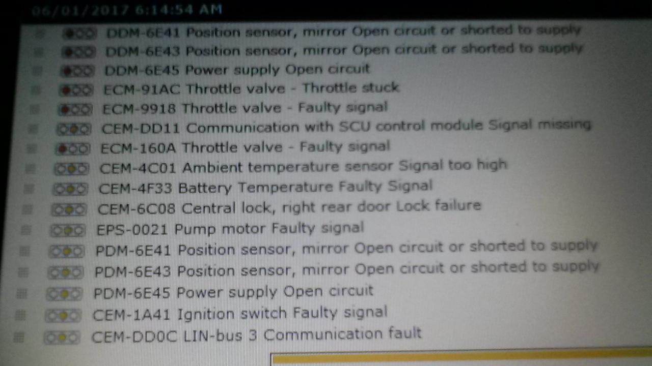

Finally getting back to looking at this - fortunately I do not need the car right now. I now have diagnostics hooked up and the sputtering has stopped. There is no power though and the rpms barely make it over 1200. Error codes follow. It looks like the throttle valve which explains the lack of power. Too many error codes for my liking though. I tried cleaning the TB and that didn't help. I am going to replace the Throttle body next - found one at the local auto graveyard.

I replaced the TB last night and no change. I am using dice and just figuring that out - plan on looking at it tonight. I didn't clear the codes before i replaced the TB - would that make any difference?

I checked the voltage and it is just over 12v not running.Given I have replaced the Throttle I would think if it was a bad connection due to corrosion the problem would have disappeared at least temporarily. Given the fault codes I am starting to think it could be the connection from the harness to the ECM? Has anyone run into issues with connectors and if so what did you use to clean then? If it isn't the connection then i am thinking it must be the ECM and i would rather not go there.

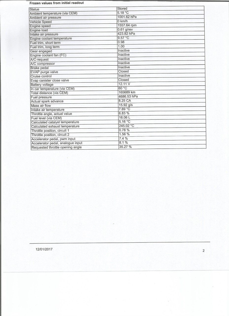

Following is the detailed information from VIDA - from this it looks like the throttle valve is not opening. If so I am thinking ECM or cabling/connections to the throttle body. Is my analysis correct? Suggestions on diagnosing/next step ?
