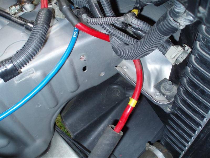

At first i couldn't figure out where to put them, so i removed the battery+tray and part of the airbox
underneath the batterytray are 2 Holes that conveniently have the same threading as the horn-screws.

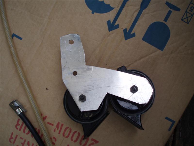

It's not pretty, but it does the job: I used some aluminium that i cut to fit and mounted the horns on it
Then, sneaking the wires back in and with the new horn-mount in place

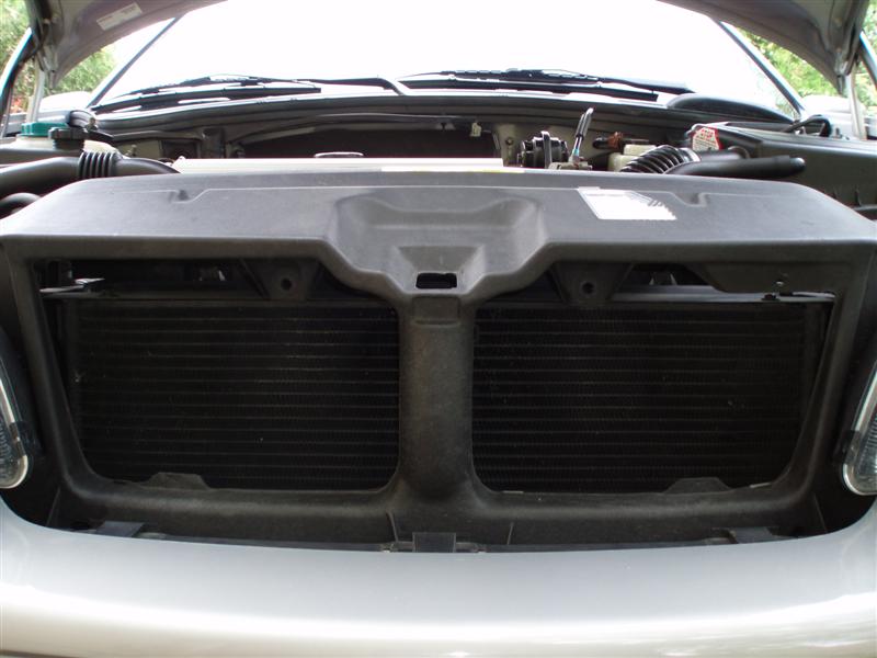

Free airflow :D
I didn't really bother to check if there is a rigth or left horn - I can live with non-stereo honking ;)
