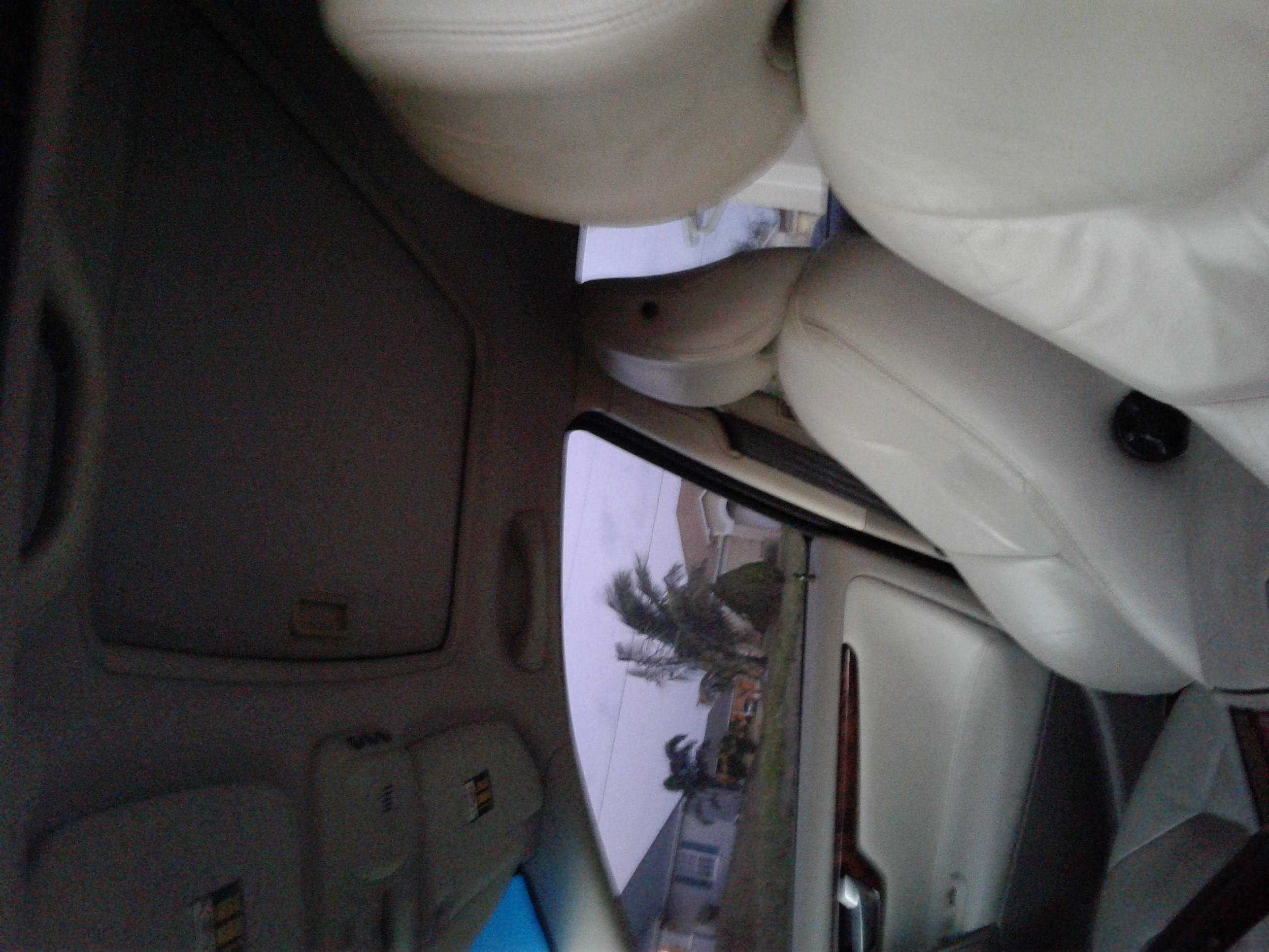

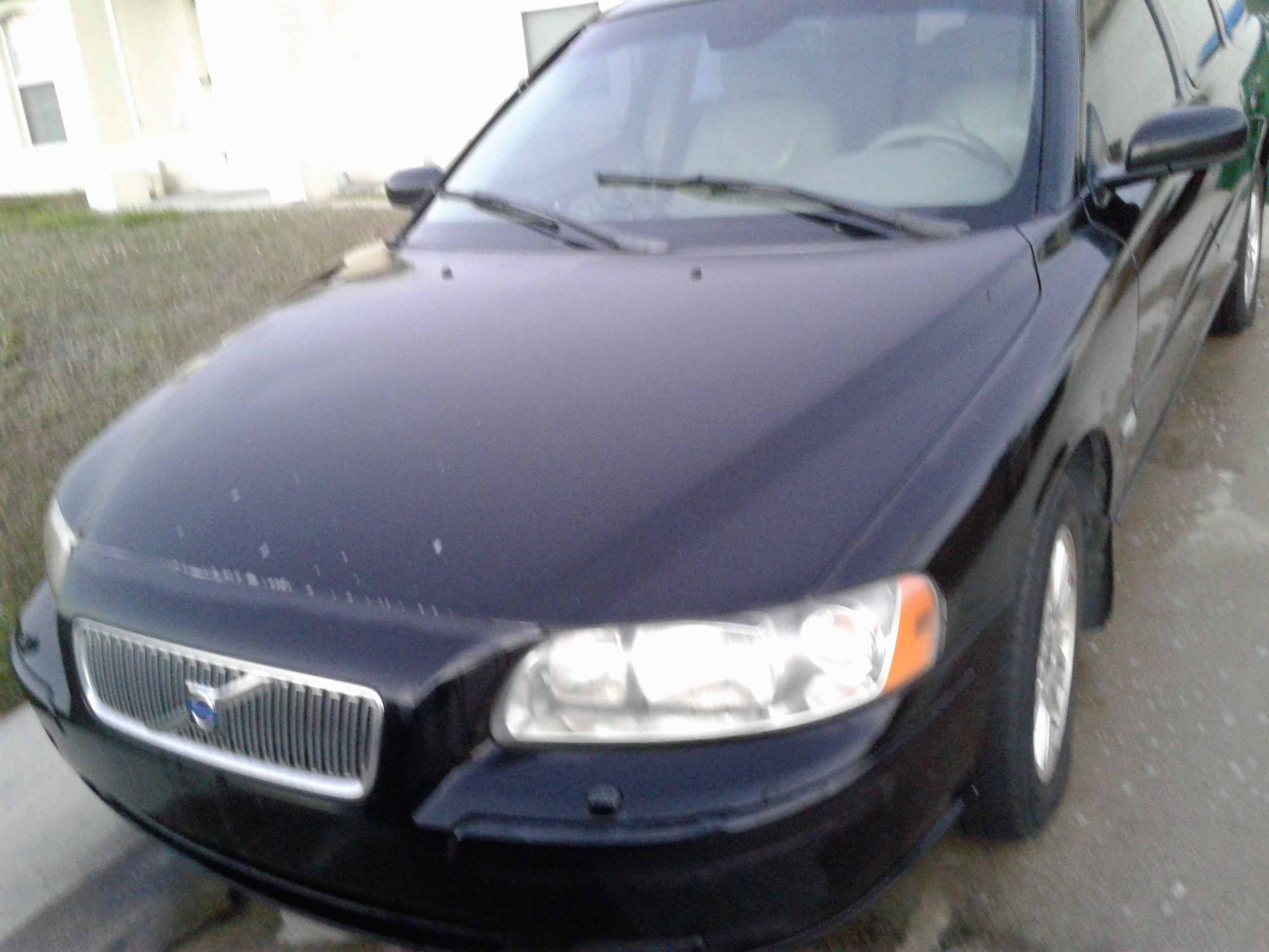

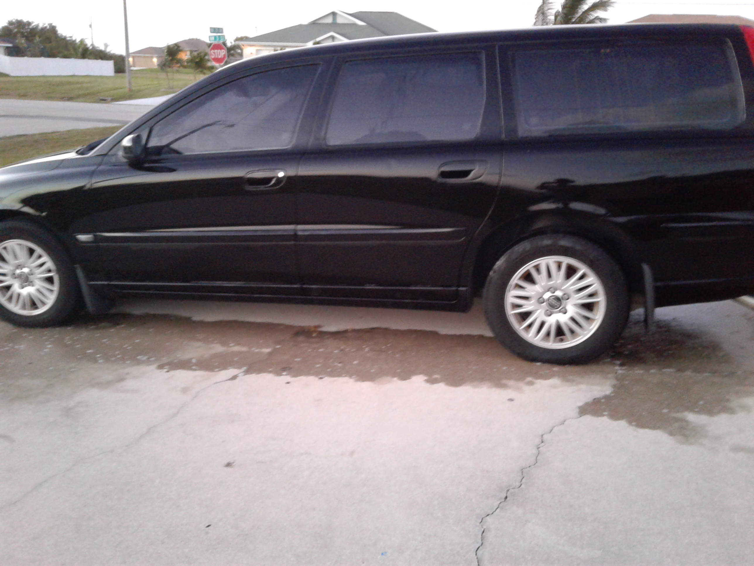

UPDATE: mechanic came and looked at it yesterday. He said bad motor. Knock and no oil pressure. I asked how much to replace engine. He said he found one with 76k on it and cost 3300 installed. I really want to keep my baby. Car is paid for. I paid 2500 for her. I of course am going to get second opinions and shop around with my main mechanic and another who has worked on my Volvo before I do anything. She is a non turbo with a great body and pretty good interior for age. What are your opinions? I am attaching some photos. Thanks!
