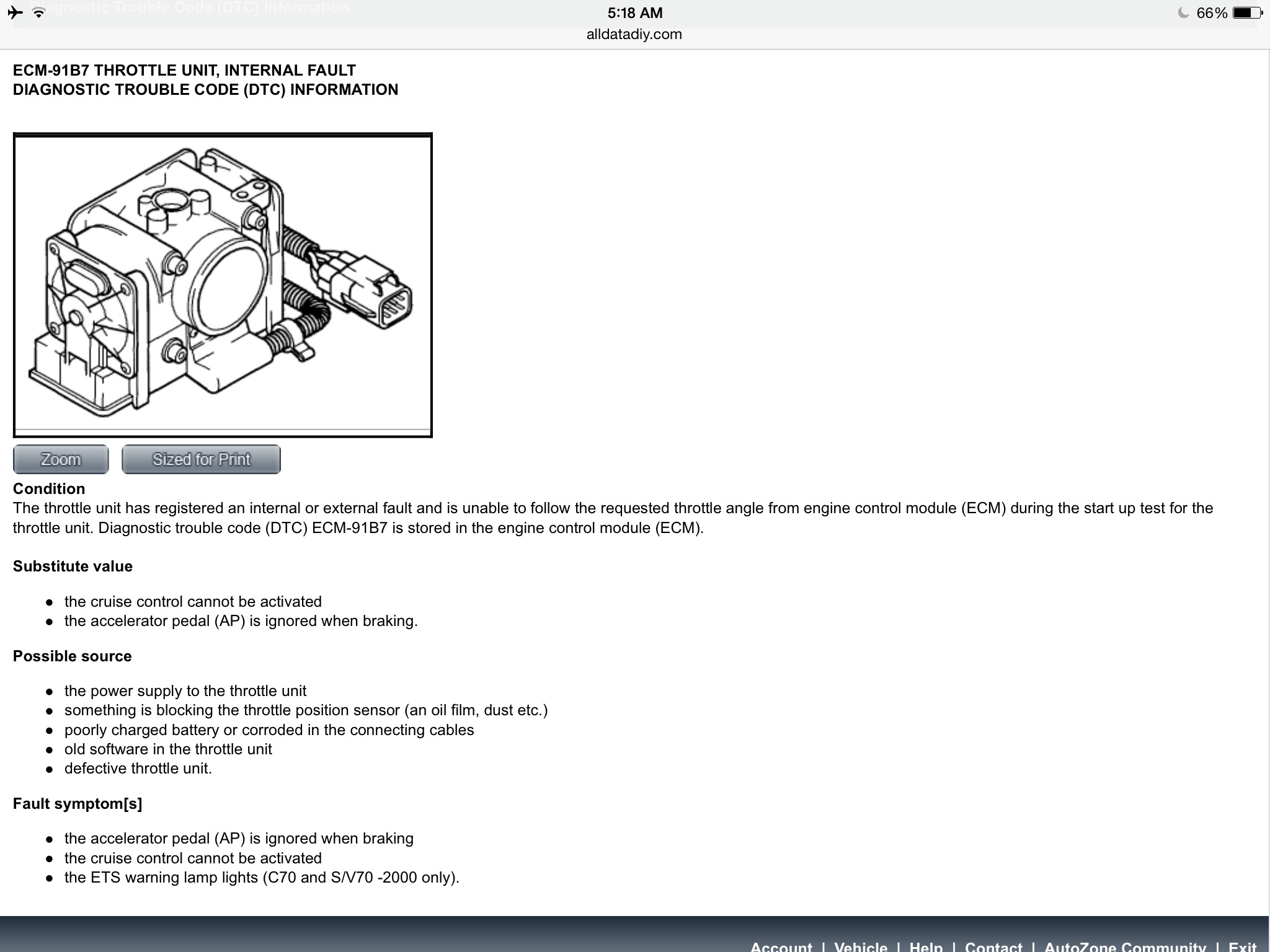

The software on these cars reports errors if it detects differences between the two sensors on the ETM of more than a set amount, but it will still let you drive the car. It immediately shuts off cruise as a safety feature on reading errors , though. It needs a drive cycle without errors to Turn it back on.
Can you read the actual Pxxxx code or the Code in format ECM-xxxx ?
On edit..found it. Info below. Looks like ETM isn't right

I think the soldering I did was pretty solid. All of the pins were completely covered in solder without any touching adjacent joints. Even the tps wire was flawless. Followed the instructions to the T. Thanks for your input abscate! Do you think that an etm software update would ignore the difference between the sensors therefore not trigger a code? If so how much do these updates cost, and are dealers the only ones that can do it? I can imagine they will find 100 other things that need "repaired" just to upcharge me when all i want is an update.

You can contact a dealer and ask if you have update installed. Have your VIN ready.
Posts: 35267
Has thanked: 1497 times
Been thanked: 3810 times
Just take it in for an oil change and ask what a software update costs. If there are problems
Plan B...contact Henry ( doublebug here) and do it over the Internet. I believe Henry is cheaper than the dealer.
