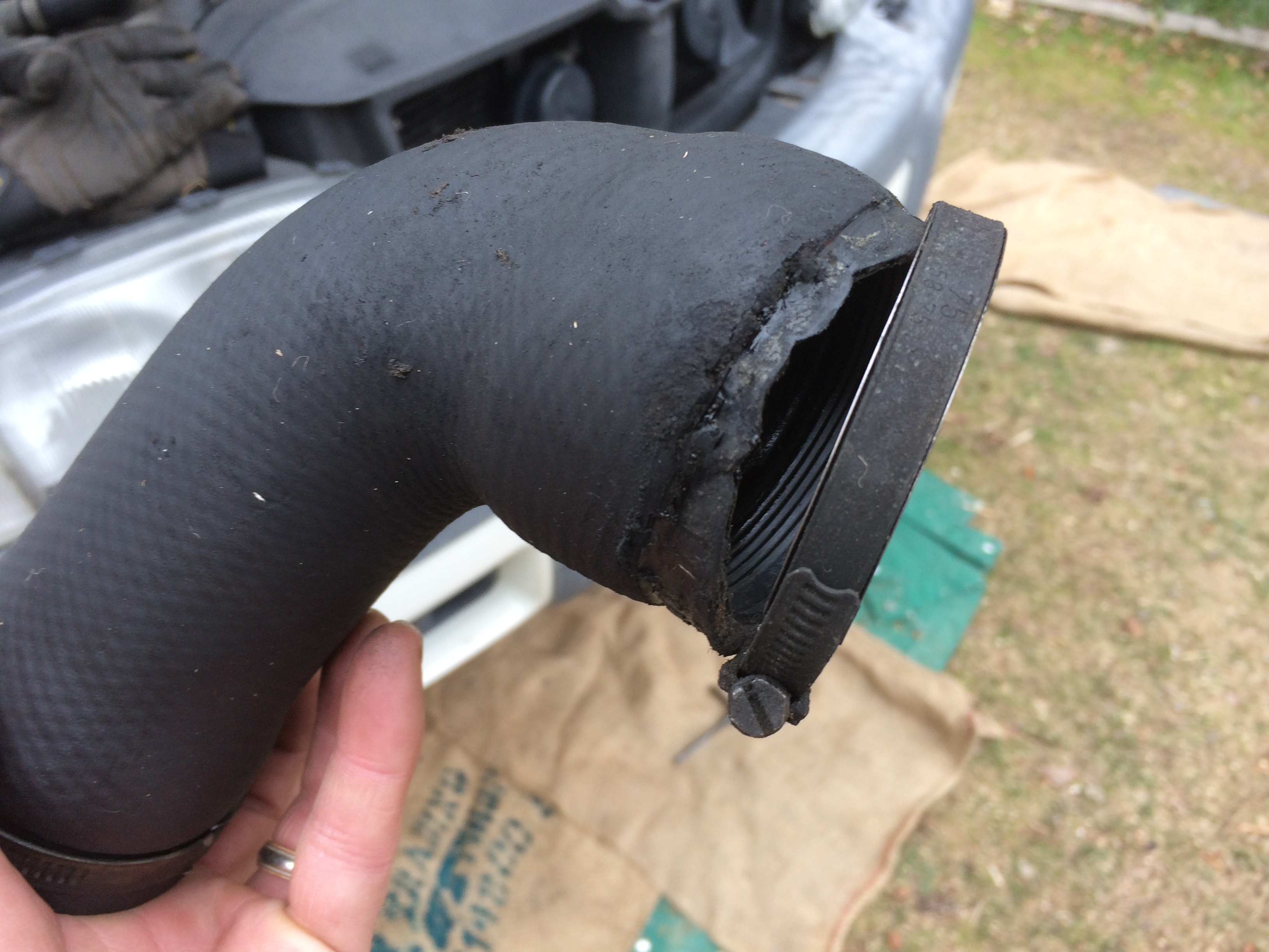

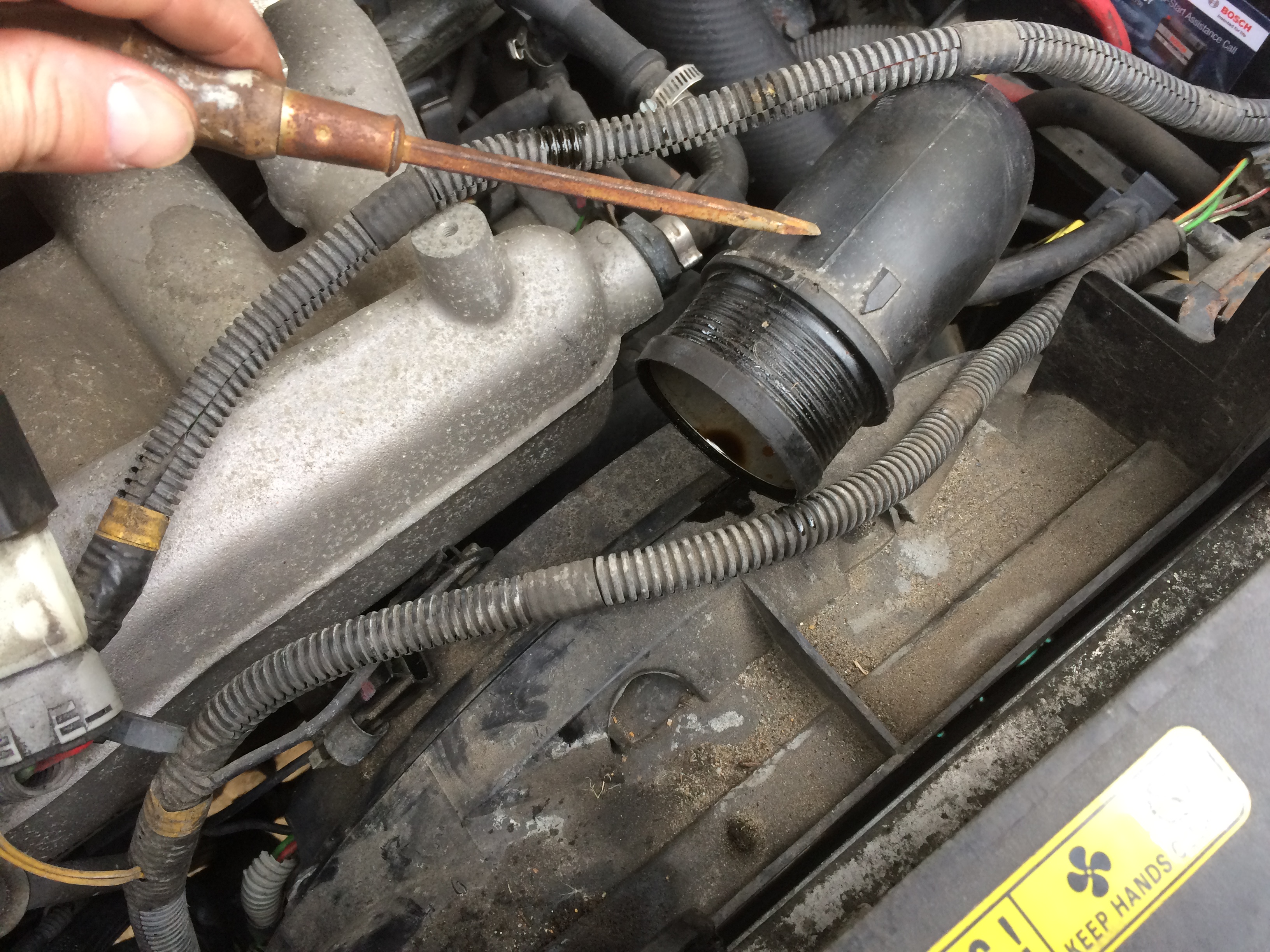

Hi all, so the radiator came quicker than I expected, so I decided to see how far I could get before the big game tonite. I am as far of the fan removal, and I just don't see how to get it up past the tube/hose in the pic. am I missing a trick? Also, the upper intercooler hose, looks trashed on the end. can I trim down and re-use? are there generics at the box stores I can grab, or is this a special part order? I appreciate any kicks in the butt to get through today. sorry pics are out of order, getting them in the forum at all is about my technical capabilities

You definitely should get a new hose, it's done. Looks original!
I can't remember what i did to get the fan out, but I think I removed the charged air hose going to the electronic throttle. That way the fan should come straight up with no interference. There's a single hose clamp holding it onto the throttle. A little hard to get to, but it's possible. Also take care removing the connectors to the couple of sensors on the pipe.

2nd edit-- after looking through, ETM cars the rad comes out the bottom easier than up and out. and just having the fan loose, I believe it can stay and the rad slides out of the stack.
