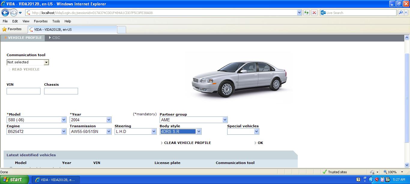

Really ?? See pic below. They were sold in the USA with the five cylinder as wellThommyKent wrote:A 2004 S80 will only have a 6 cylinder engine and there will not be a transmission drain plug. Here`s a video that`s reasonably informative.

It was never sold in USA. Try looking up parts for a 5 cyl S80 in USA trim. Maybe 1.precopster wrote:Really ?? See pic below. They were sold in the USA with the five cylinder as wellThommyKent wrote:A 2004 S80 will only have a 6 cylinder engine and there will not be a transmission drain plug. Here`s a video that`s reasonably informative.
04 S80 2.5T is an i5ThommyKent wrote:It was never sold in USA. Try looking up parts for a 5 cyl S80 in USA trim.precopster wrote:Really ?? See pic below. They were sold in the USA with the five cylinder as wellThommyKent wrote:A 2004 S80 will only have a 6 cylinder engine and there will not be a transmission drain plug. Here`s a video that`s reasonably informative.
