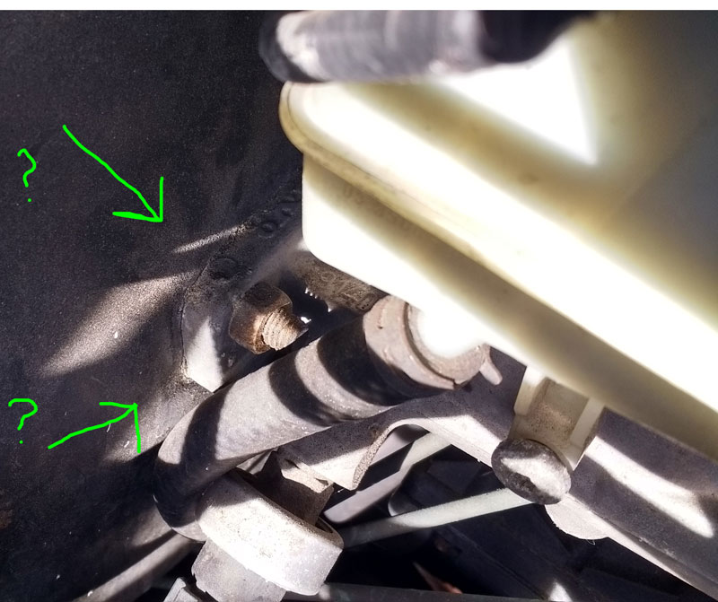

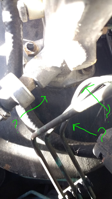

Are these signs of internal leaks? I can't really smell anything but car... But my master cylinder has been losing a little bit of brake fluid every couple of weeks, no leaks at the wheels. Enough that when I add fluid, the pedal feels a little stiffer for a bit. I have not thought to check my clutch slave cylinder my my clutch hose... :?

If you are adding a bit every few weeks, somewhere there will be damp brake fluid. I don't see enough wet there to call a leak.
It could be out of the internal end of the MC in which case it can kill your brake booster.
Using brake fluid is bad. Each of my cars gets a sharpie mark on the brake reservoir and any departure from the mark pulls the car off line.

Well, if you're going to check your master cylinder for leaks, make sure you do so after driving around a few miles... (Not when the car is cold, as I've been doing...)
It's official. The Master [of Disaster!] Cylinder needs to be replaced! :evil:
