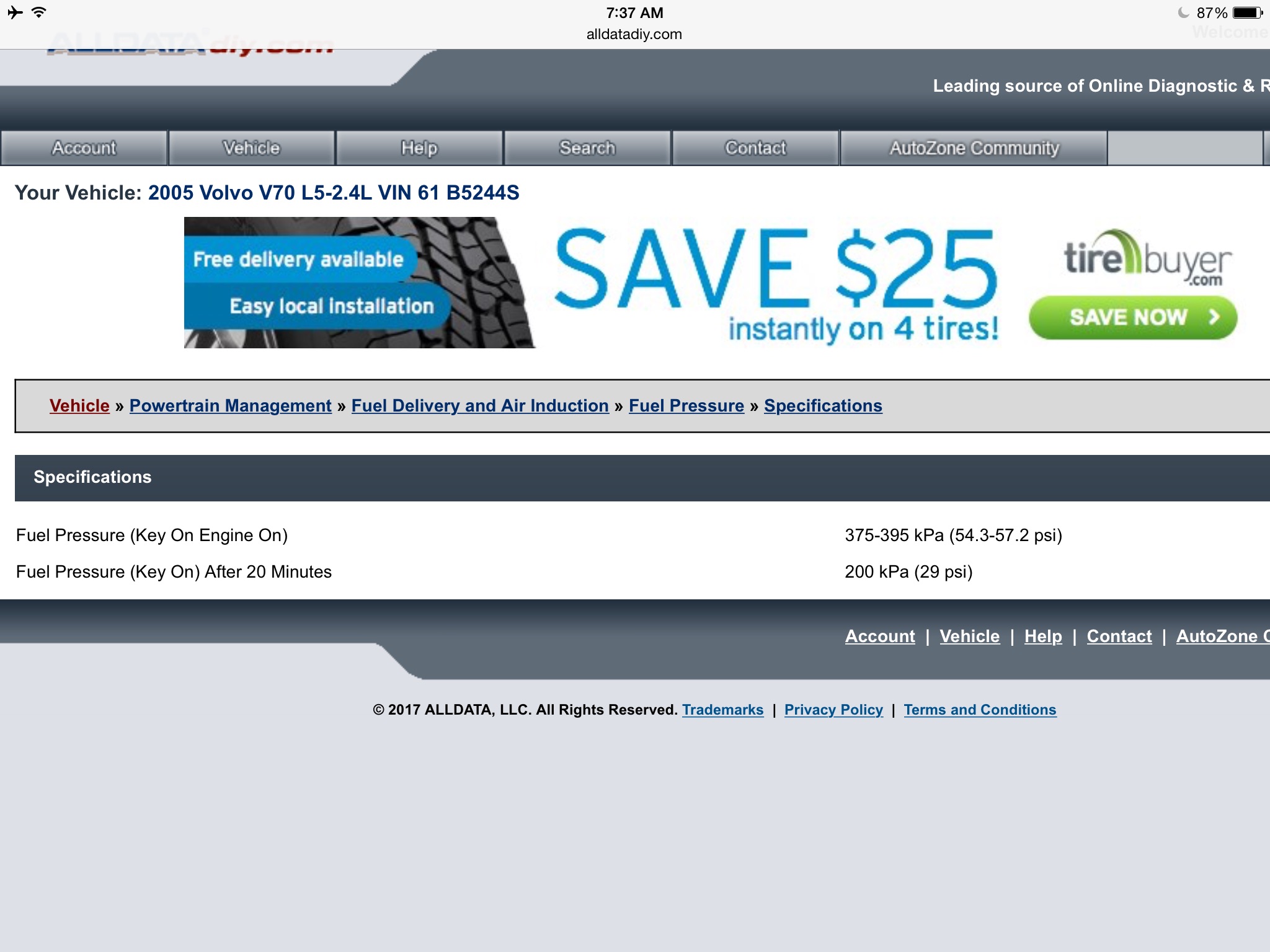

Mike ..I think the fuel pressure specs do give a bleed down number and I know that's it's much higher than you are observing. I'll search and post

Thanks so much for the Alldata specs. No the figures are much LOWER than the problem car if you read my post again. My own T5 has almost NO bleed down and the problem car has quite marked bleed down. I think it's all totally not related to the breakdown of the engine and I will report my findings after completing the PCV service tomorrow. Pressure with engine running is 55psi.
