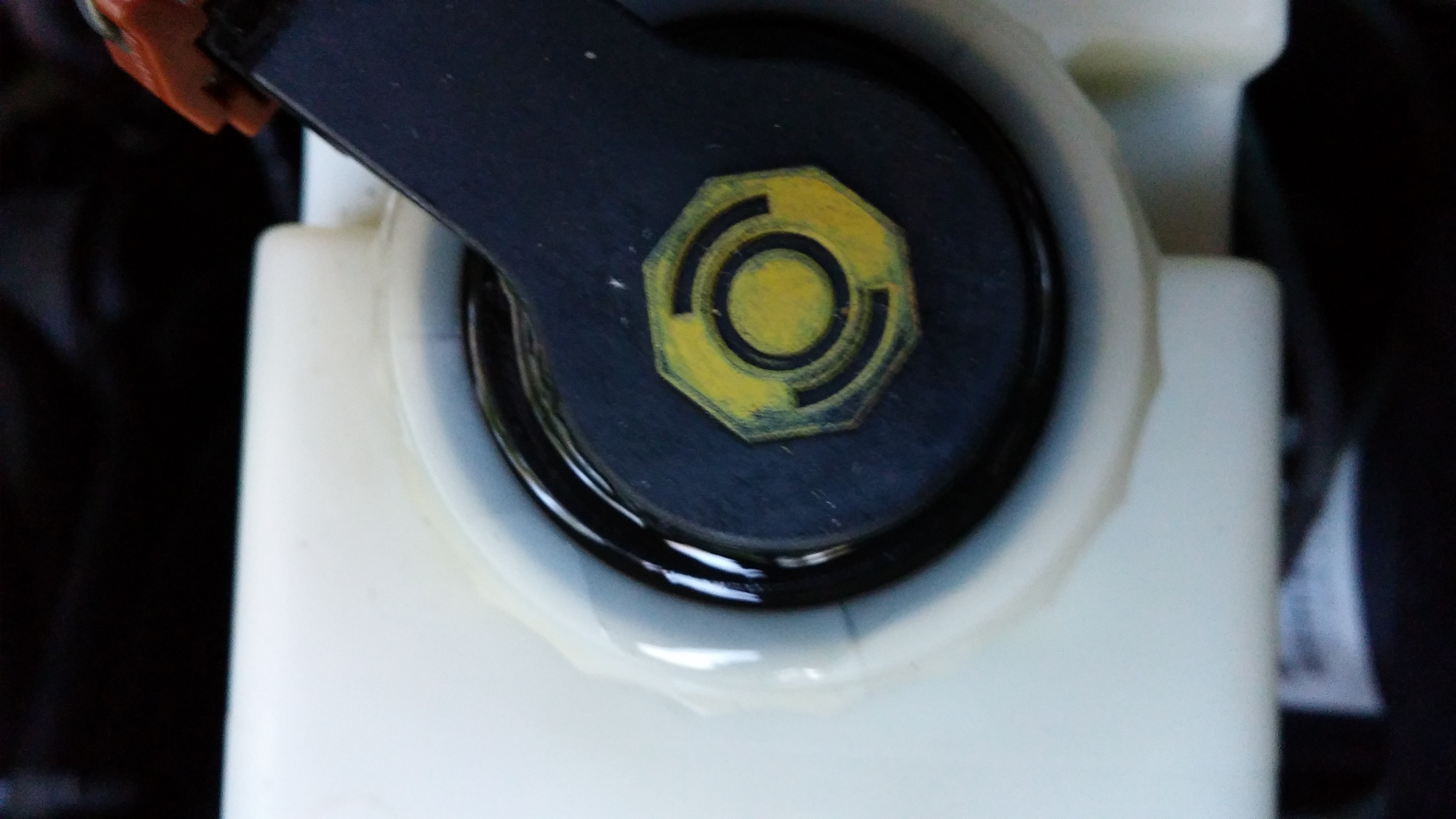

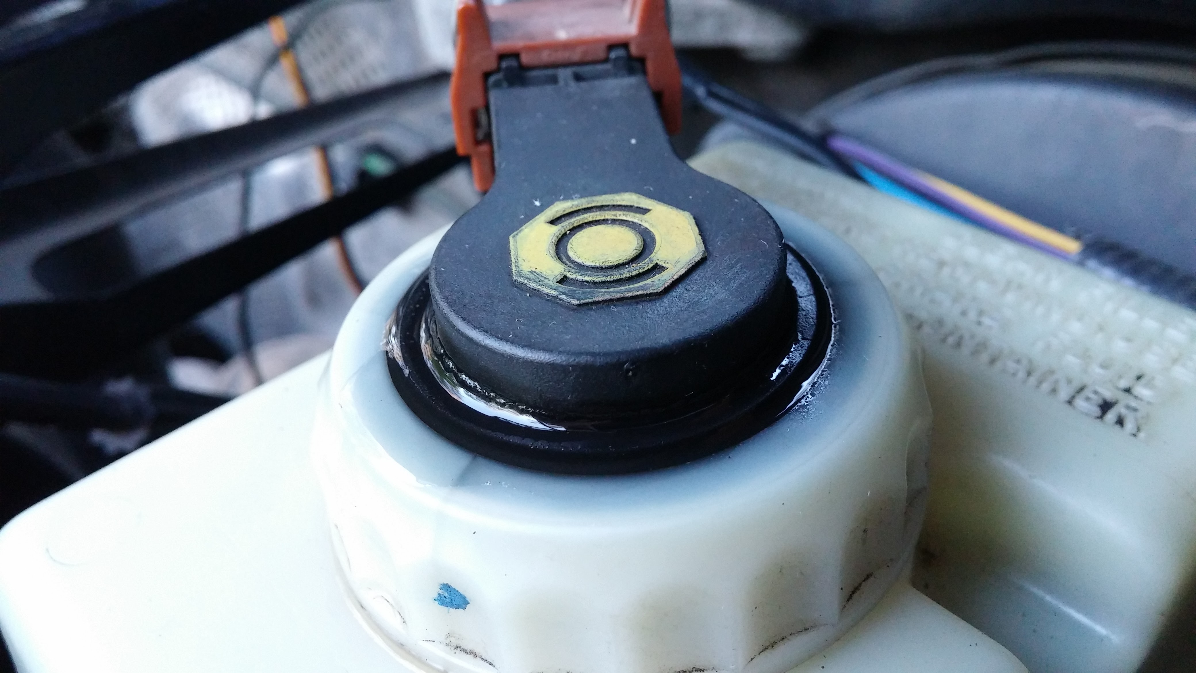

I replaced the cap last week for the same reason, but now this one is leaking. Am I doing something wrong? Like tightening it too much possibly? Anyway, I got this cap from the junkyard after I looked it up on Lisle and discovered it's $60!!!!! That's nuts for a brake reservoir cap.
Does anyone know if there's some kind of fix to the seal maybe? I don't want to spend that kind of money on a reservoir cap when I have to replace my parking brake shoes (they don't work at all, but that's another thread for another day...), front brake lines (they're just a little worn at the ends, I don't think they are leaking), and a bunch of other stuff. Just to add, I'm not losing any brake fluid anywhere else. The level stays at max, the only fluid leaking is on the cap.

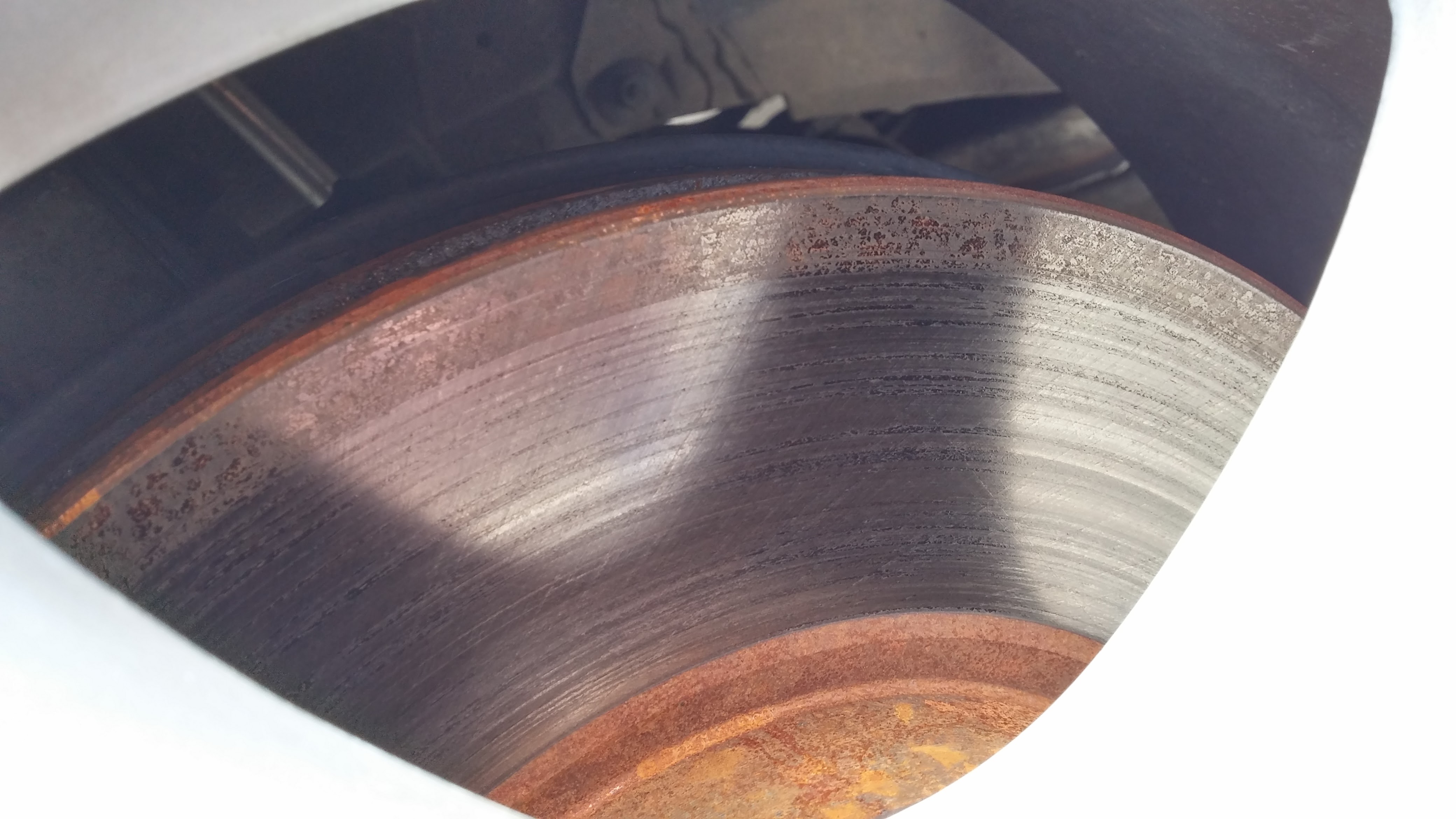

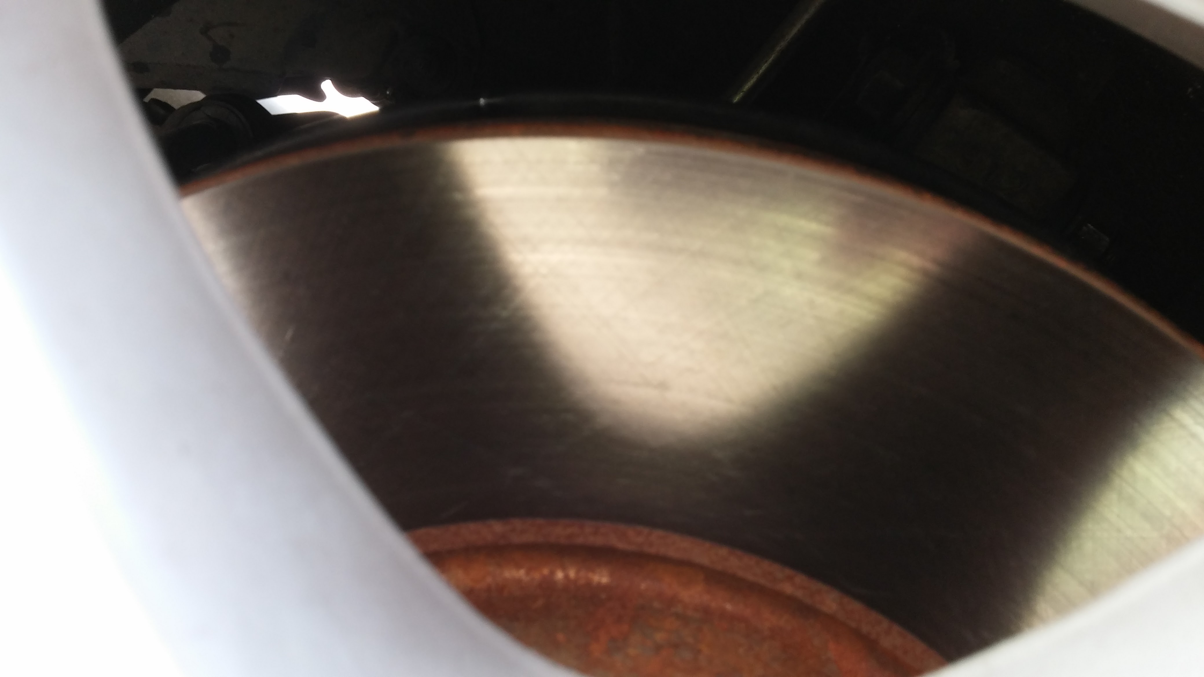

As far as I know, the calipers are sliding freely. However, when I'm driving I occasionally get a rattling/screeching sound from the front brakes. It's been there since I replaced the brakes, and at first I figured they were just setting, but I don't think that's the case. It's still driving me nuts after about 2 months. FWIW, I did notice after a very short drive (<2 miles) that there was probably 1/2" of rust still on the front left rotor (it rained the previous night). I wasn't doing a lot of braking, but it was noticeable. The front right was clean of rust. Don't know if this is normal or not after 1,000 miles on new brakes, but the machining marks are still there.

Uh oh, thats not good. Watch it closely - if it does not polish off, it means the piston is sticking in the caliper, or the pad is hanging up in the slide. That will also give you a bad pedal feel.

Well as of the last time I looked, it was clean. I just washed my car, so the rotors are probably rusty now, so I'll check them in a little bit as I'm about to go to the store.
I plan to replace the seals in the front calipers anyway, so hopefully they're just starting to go out and it's not a huge problem yet. I'll keep an eye on it!

Just checked the rotors after my Harbor Freight run and they are all 100% clean. They were all rusted before I left.

It seemed to stop for a while, but I just noticed yesterday it was wet again. I just can't justify spending $60 on a cap though, it's ridiculous.theWIFES_S70 wrote: ↑26 May 2017, 12:56 hey bmdubya1198, did you ever get around to fixing the leak around your master cylinder cap?
I can't believe the cap is $60...
I had one I got at the junkyard, but that one did the same thing. I thought maybe I hadn't clicked the two parts together (sensor connector and threaded cap part) but that's not the problem now.

Yeah, I'm in the same boat, too. I wonder if it's just the rubber washer that has torn somehow because of opening and closing it... There's got to be a way to DIY this. Of course, without spending the $60. (Though, it would be guaranteed for life, right?)
