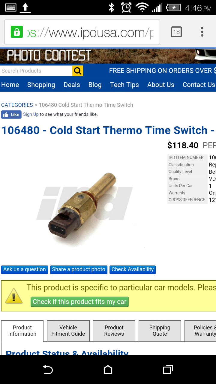

On my 1981 volvo 245, I'm having a cold start thermal time switch issue, I know how to resolve it, but thats not my question,

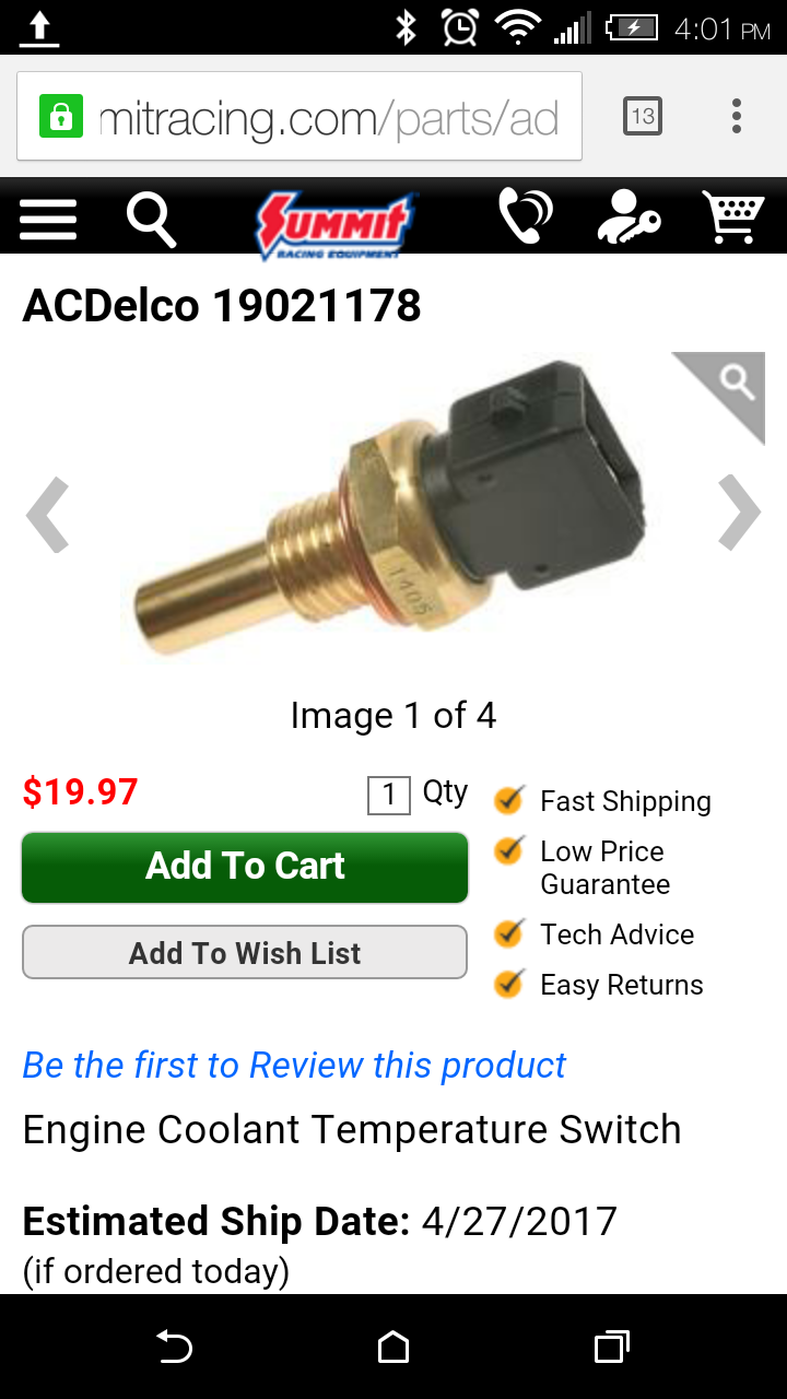

My question is that my by brain is telling me a volvo "temperature sensor" works the way same as a cold start "thermal time switch" which cost increasingly more $$$, like $10 and $100 difference,
So could I possiblly exchange one for another, I was wondering if anyone has a reasoning to my madness, thanks
Thermal time switch or coolant temperature sensor!

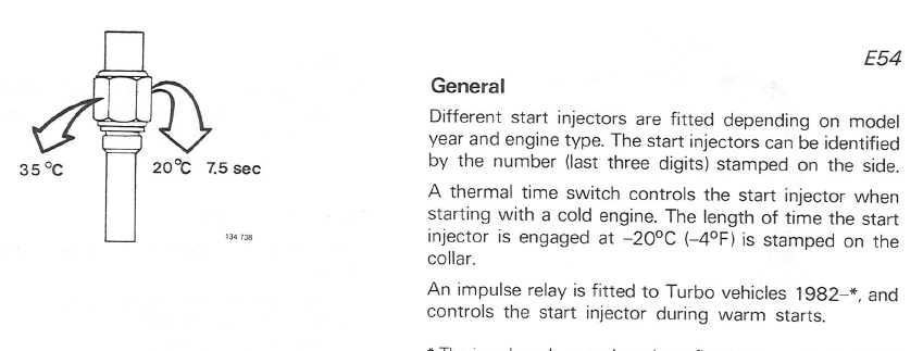

OEM thermal time switch powered start-injector for about 7.5 seconds at -4°F, and then an "open circuit" so start injector would quit.

TTS has an electric heater and will heat the bimetal spring and open the ground to CSInjector after the right amount of starter time (ambient T at commence of starter operation determines time to heat open so time is variable with temp) to prevent flooding. The TTS also is heated due to location so no ground is available to CSI when not needed.
ECT is a temp variable resistor and is not able to handle current to CSI.
