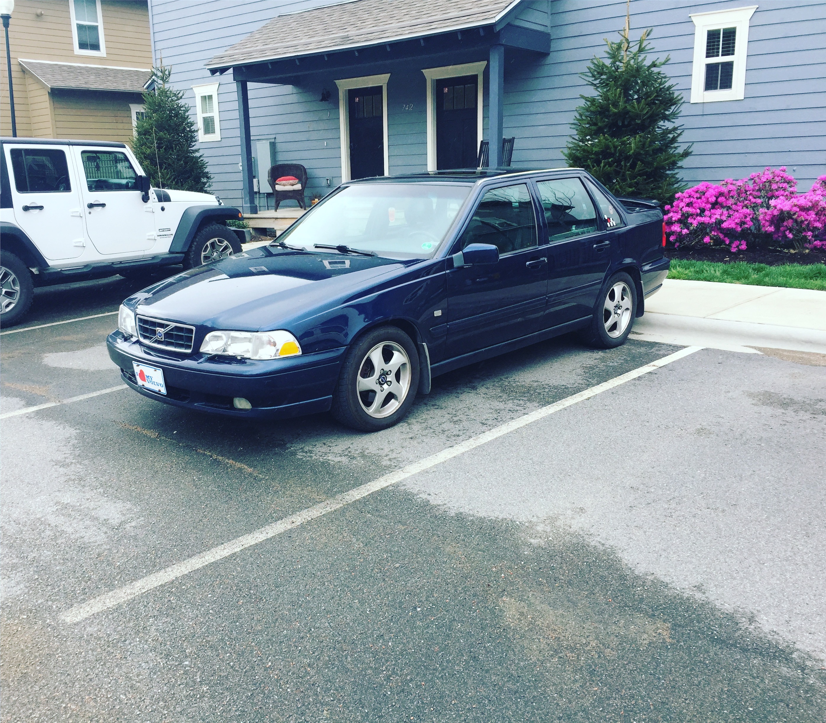

Hey all,
I've been the owner of the famous PCV system writeup S70 T5 for 5 years strong now. I'm really starting to have some strange failures with it, and was wondering if some of the high mileage guys could pitch in on what I need to keep my eye on or keep in my spare parts stash.
Car has been rock solid reliable since I put a new cylinder head on a year ago after suffering 2 burnt valves up until about a month ago. Since that, my throttle position sensor, 3rd cylinder injector and J-hose have all failed within 1000 miles of each other in the last month. The car is currently sitting at 253,000 miles and waiting on a set of blue injectors I ordered to show up.
I plan on going to Volvos at Carlisle in a couple weeks, about a 1300 mile round trip total, and I'm somewhat worried about it.
In the car I keep a spare coil, fuel pump relay, heater hoses and a bypass loop, and spare fluids- Anything I should look out for, though?
TIA! I just don't want to be the guy on the side of the road for some stupid problem :mrgreen:
